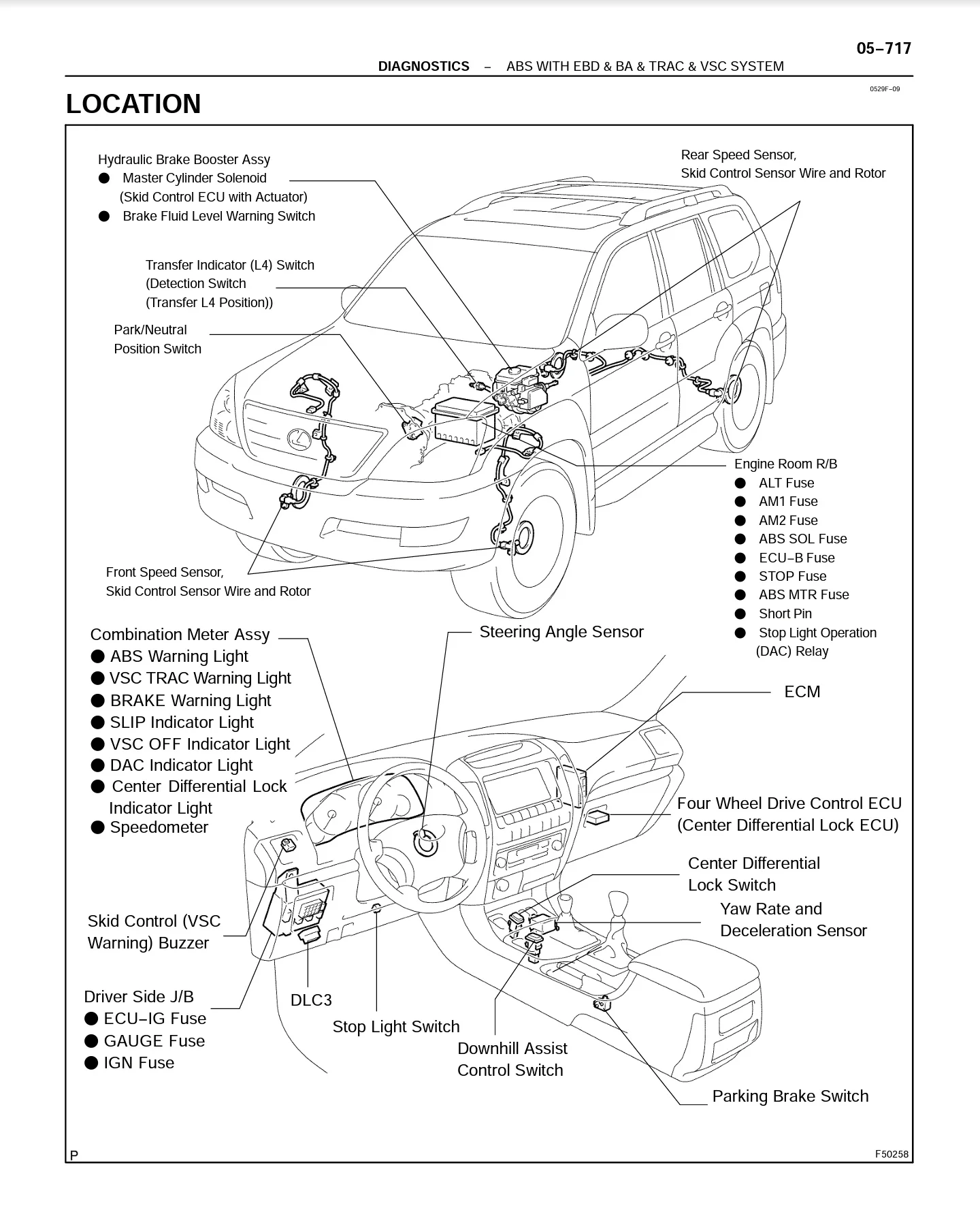

Might be the ZPC is not complete. It have to be done at same time.
Its located in the center dash. So lift install would got nothing to do with it.

I just messed with it more and it seems to be working fine now.
When I originally tried to run the ZPC I did it with the TEMS fuse removed. I put the fuse back in and tried again and it didn't work. I took the fuse out again and still had the C1234 code, but also had another code that said my yaw sensor was no longer calibrated. I ran the ZPC again and everything is back to where it should be.
