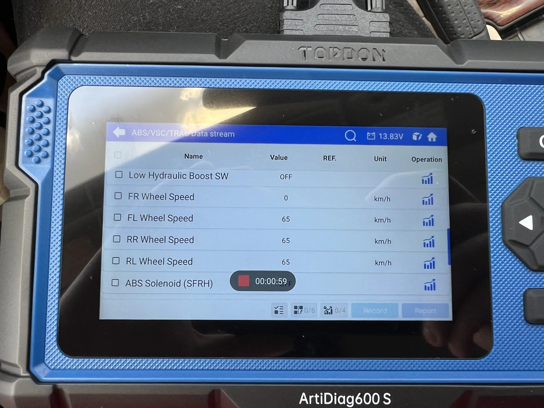

I recently bought a 1998 LC100 with a ABS light and Battery light running codes on it and I saw a bunch of codes. Cleared them and the C0200 code is persistent.
Took the car out for a ride and had data logging turned on:
1) Cruise set to 40MPH
2) FR Wheel Speed is at 0km/h where as the rest of them are good and showing speed
I know I probably need a new wheel speed sensor or my Reluctor ring is messed up. (I'll check out the wheel speed sensor wiring later when the weather cools down a bit)
Has anyone had this issue before? I cant seem to understand why that battery light is on when it should only be ABS
No battery issues. Multimeter shows 14.11V when idling. Code reader shows 13.83 while in motion.
I've also put about 1000 miles on this LC with the lights on and the battery has not died so i know its not the alternator
