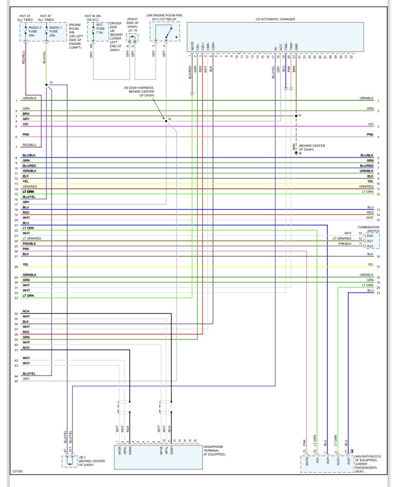

Not sure this diagram covers all years and ML or non-ML but maybe it will help.
If it was me and had nothing to lose (before sending in the amp for service) I'd experiment with disconnecting that main power at the amp via a switch, relay or feeding it with ignition instead of constant power.
I think my only concern would be if that constant power is needed for presets of any kind, radio stations, etc... etc.....

Yeah, I was wondering about that too. It shows on this diagram as always hot for power to amp so it must be intended that the amp be able to control the off and on internally. Hmmm.
