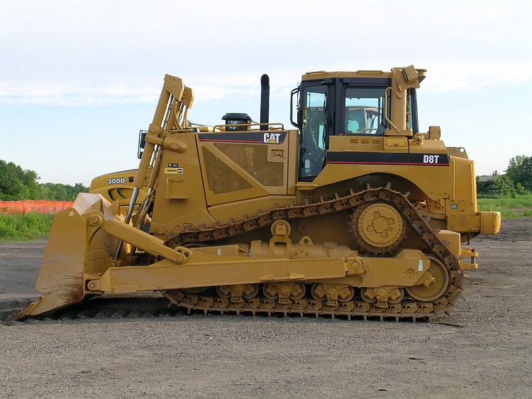

I want a bulldozer for my next birthday...!
that is all! :D
that is all! :D

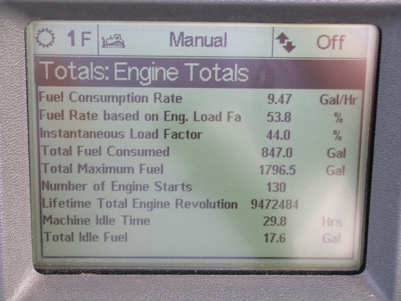

Ask your wife for one of these new T models. I ran this one for a few months and can vouch it is a very nice tractor indeed. Even has a neat computer to tell you your vitals. You should pick one up.;)
