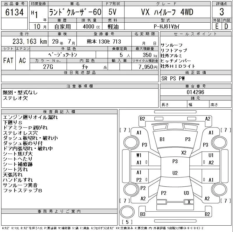

Odometer reads 134,XXX KM, truck was sold in Japan with 233,163 KM. Odometer has been rolled back 100,000 KM. Seller has listed on eBay several times and listed on Bring A Trailer. Auction sheet showing correct mileage when sold in Japan is included in the photos at the bottom, but description still claims "134k kms". Seller is aware of the discrepancy.
