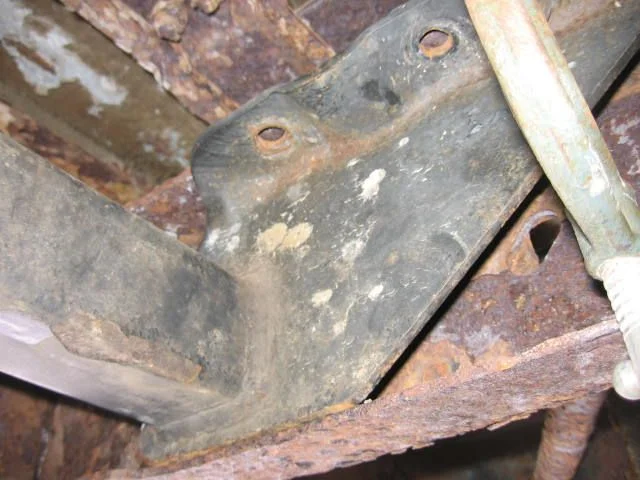

Here some photos. I did not get the tape measure back out too dark, but I think its closer to inch and 3/4 on both sides. not the original one inch.
The photos came out decent to see what i am talking about here.
First photo is of the passenger side, you can see 2 of the 3 OEM top mount bolts and at the bottom of the hitch you can see how the whole receiver sits inside the frame rails.

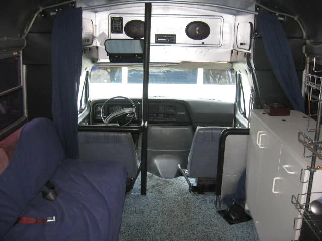

More of the inside and what I have done so far.
More yet. Kenwood CD player, bummed as it does not play MP3s. so no theme song from Shaft.

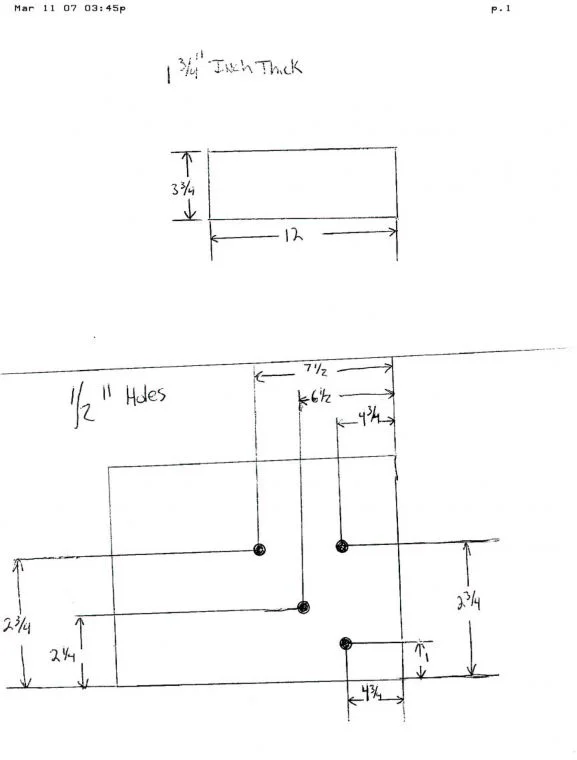

Well see if this works, The plate needs to be inch and 3/4... 4 holes drilled in it. 1/2 inch each. Need two of them.
Since no one has shouted out that I would die bolting this to the frame I will move forward.
