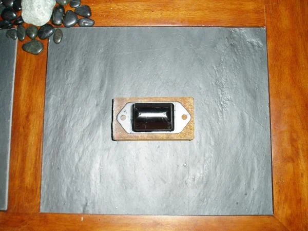

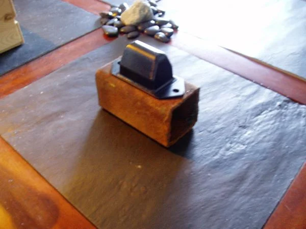

Well I went to the scrap yard today . Spoke with a nice older French Canadian . (Gumby would have gone running in the other direction .. we know he hates the French :flipoff2: ) . Anyway , originally I asked for 2" square stock . We found some , but dang I didn't realize it would be solid !! I backed down .. and we looked for square tube instead . We found a pc of 3"x3" .. x 24" . So we took that and he took out his plasma and cut it into 4 x 6" lengths .
I'm hoping I don't actually need solid stock .. that seemed excessive . Picked this up for $10 , and that included his time for cutting it all , so no biggie if I have to replace it .
Junk mentioned 3" tube in the rear , so I was thinking I might be able to get away with 3" all around ... plus with 16x10's around the corner I'm happy to go overboard a little at first . I can always redo the fronts .
On my next block at work , I'm going to grind the ends of these pcs clean , and then use black rust paint on them after I drill the holes .
I have a few questions :
- I'll be needing 8mmx.125 bolts , but I have concerns with strength , as they will be over 3" long . Is there a type/strength rated bolt I should be on the hunt for ?
- Should I be concerned fo rthe strength of the square tube , in regards to potential collapse . (seems beefy as hell , but what do I know ?) . If so I was thinking I could slip a heavy gauge steel tube over the bolt as I insert in thru the square tube .. grinding the sleev tube down to size so it just wedges into the square tube ...
Thoughts ?
TY
3"x3" seems to accomodate the size of the bumps quite nicely ..

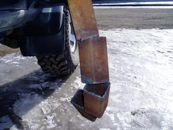

if you can collapse what looks like 1/8th wall steel tubing you have other things breaking.

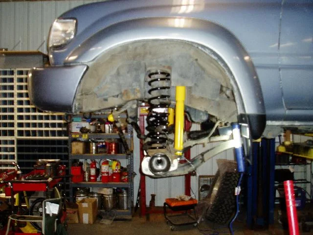

Not sure about the 3x3 up front. Hold it up there and look to see if you think the spring will rub against it. Can't remember and I hope not, but look to make sure. My butt is too fat and lazy to go look right now :D
But yes, you are correct that tube is what you want. 1/4" is super beefy so if you collapse it then you gotts mega other issues and I ain't talking about the shaved ones.
I grabbed my grade 8 bolts from boltdepot.com - it was a long time ago so not sure what they have etc.
The tube is 1/4 wall :D
I'll buy some grade 6-8 bolts today , and locktite .
As far as the tubes hitting the coils , I just looked at my manual and it looks like it will clear ok . I'll drag my ass out later and double check on the truck . If it seems close , I can always move the centre of the tube inboard slightly to compensate .
Crushing didn't seem a real concern with the beefiness of these tubes . What got me thinking was the idea of them becoming a fulcrum on some twisted off camber trail . :eek:
