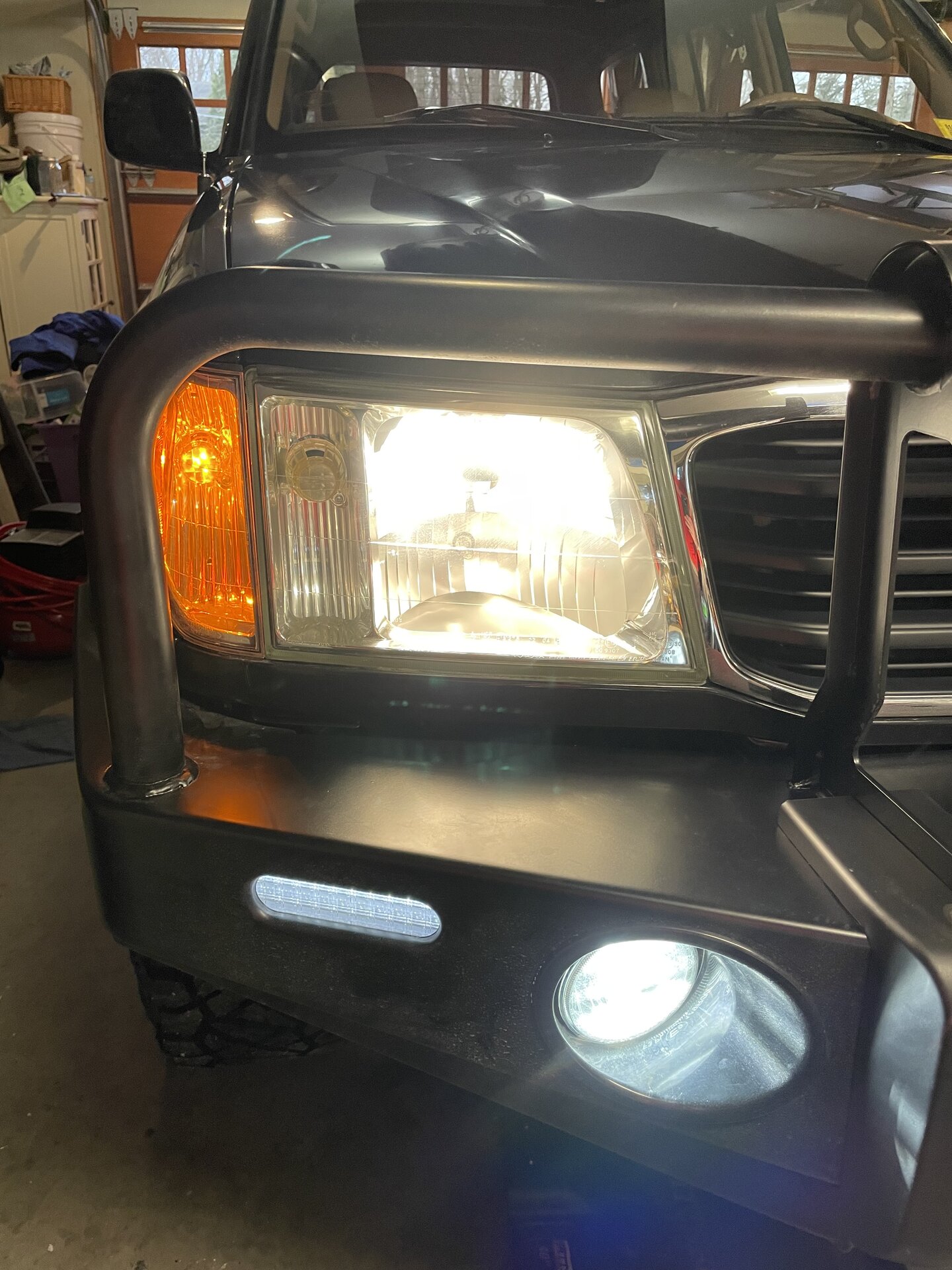

So I ended up doing the following
Yellow from bumper to Green and Yellow on blinker light.
White from bumper to white / black on blinker light.
Result: Orange turn signal.
On the marker light, the one circled in the photo above, I connected
Brown wire from the bumper to the green wire.
Result: white light when marker lights are on.
I did not use the red wire.

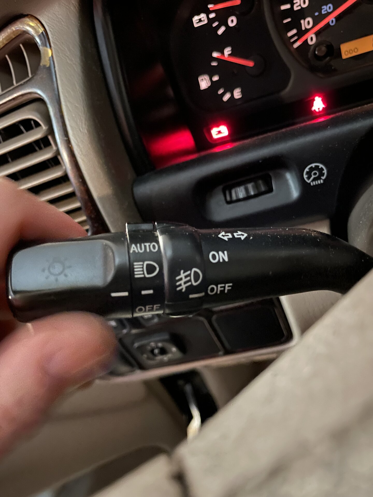

Fog are on the fog turn switch.

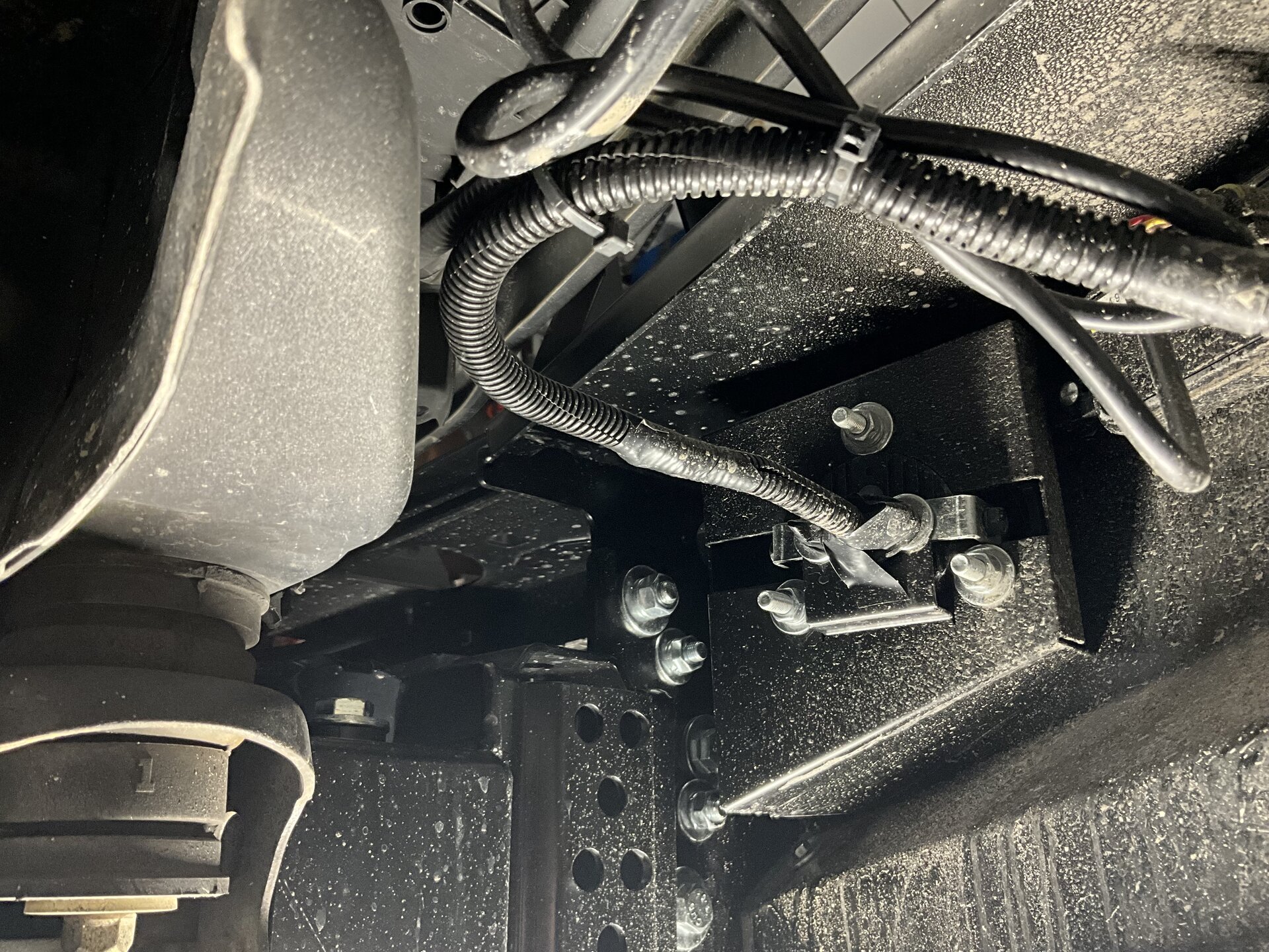

On the fogs I cut off the connectors that came on the bumper wires (first photo below) and connected the wires to the original truck fog light wires after cutting off the connectors that went to the original bumper fogs. Then I used spade connectors on all wires because I had them, but you can use scotchlock or solder seal (search on Amazon for those). I heat shrunk all connections and the put wire loom on everything and zip tied it up.
On the wires coming out of the bumper fog lights I though that Ironman should have protected the wires better as the metal edge could cut into the coating overtime and short out, so I ran the loom into the opening and put tape around it for good measure too. Photo 3.
