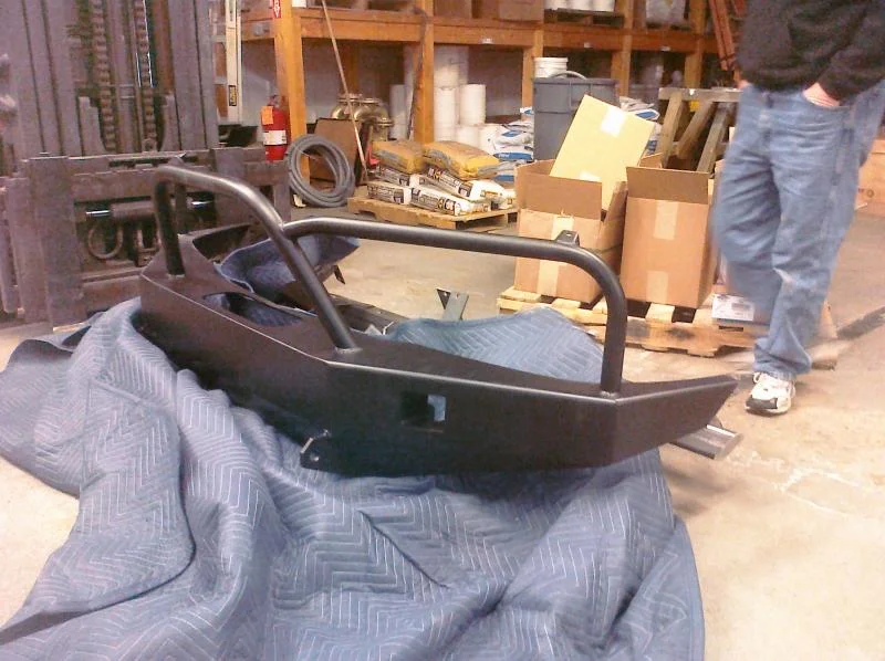

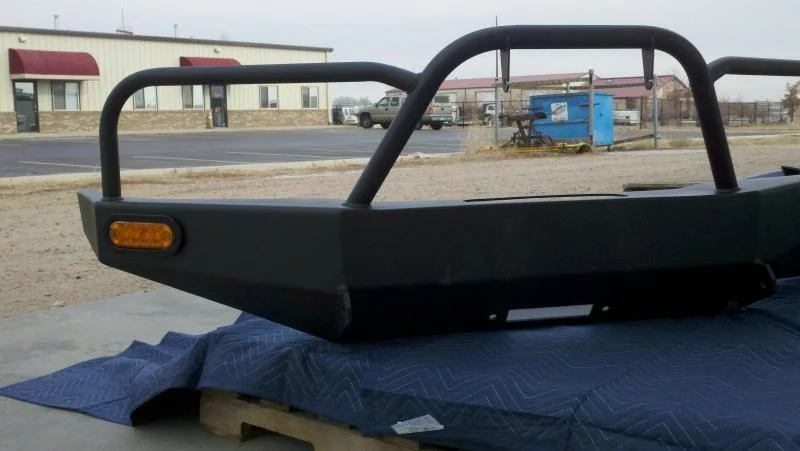

Here it is pre shipping...to go out today on her way to Charleston SC. I will include full install pics and such in build thread as soon as possible.
Center hoop is forward about 20* to allow for clearance of my LX grille that lifts with hood. Think this is his first Lexus version so I am guinea pig but we took a lot of measurements so should work.
yellow items on ends of bumper are LED turn signals to connect to my Lexus wires since our signals are in bumper and not in headlight housing like Land Cruiser. I am also the test mule for these...LOL
Then you will notice two brackets hanging down from center hoop...
That is for a Rigid 10" LED Offroad Light Bar! :)
I was going to put it on bumper in that hoop but covered hole for winch too much...
a Titan 12k Winch is being stuffed into her as well....and yes I am testing the fitment for that as well. :D:D
I am psyched.

looks like mine except i had him put driving light holes in.
btw, i put a M12000 in mine and it was a bitch to get it to fit. Had to use a BFH to get it to line up and sit.
Ahh yes, Mjollnir. Nice little hammer.
Looking forward to seeing how the whole package comes together... Very Nice Brock.

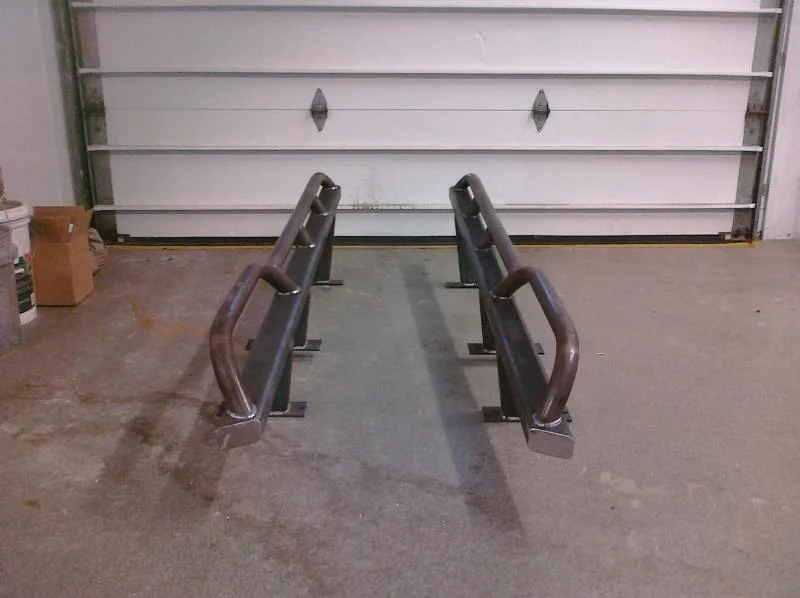

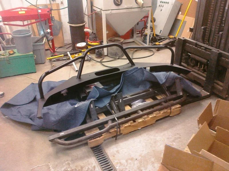

The bumper and sliders have arrived. They were packaged well on the pallet, with shipping blankets to keep it covered and from getting scratched.
The install will probably start on Monday next week.
I've attached some pics of the bumper and sliders as they were shipped. The guy at my shop took the blanket off to inspect the contents of the shipment before I got there.
congrats! Bumper looks real stout! And nice sliders! Im guessing you will rattlecan them?
Man, those sliders look beefy! Whats the wall thickness on those? 3/16"?
Seriously debating between these and WKOR sliders now.
Yeah, I'm going to rattle can primer them and finish them with spray on bed liner. The plan is to make them good for helping :princess: get in the truck (grip) but easy to touchup after some trail abuse.
From the Bump It Offroad website:
"My new 100 series tube sliders are constucted of a 2x3x1/4" main rail with a 1 3/4" x .120wall tube rub rail. They attach to the frame with a 2x2x1/4" outrigger with 1/4" plate that is gusseted at the frame. U-bolts are used for mounting."
I liked the BIO sliders better than the WKOR sliders because the BIO use 1 3/4" Tube for the rub rail, and WKOR uses (I THINK) 1 1/2".
