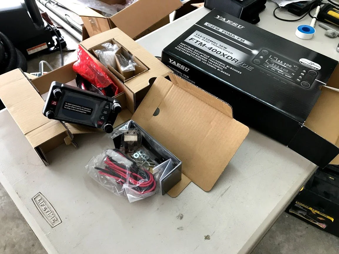

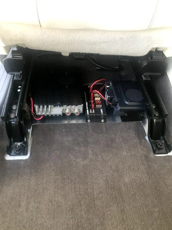

Now next project: FTM450-XDR installation.

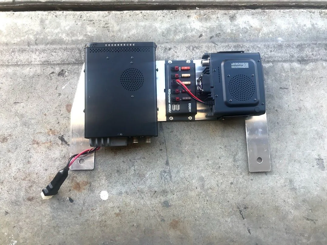

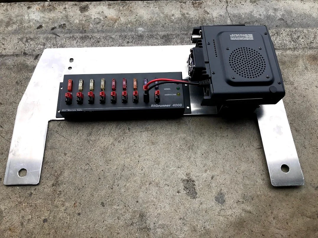

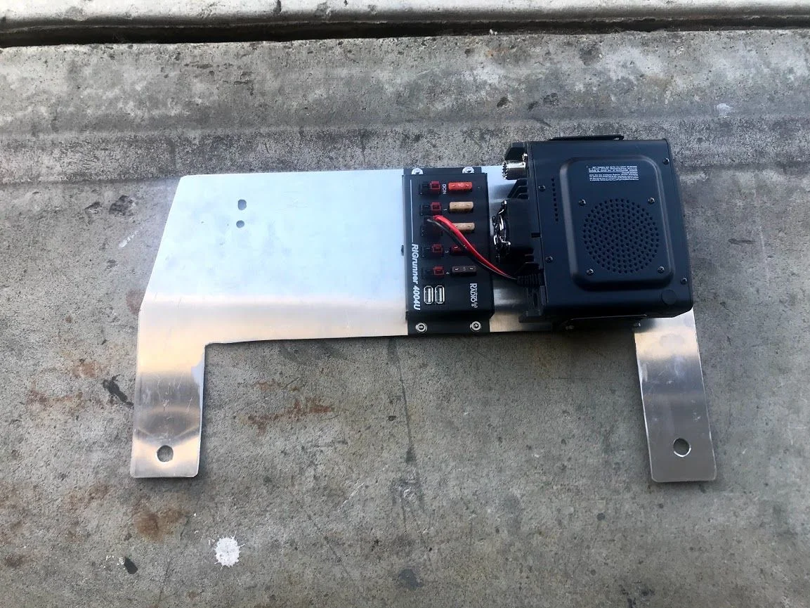

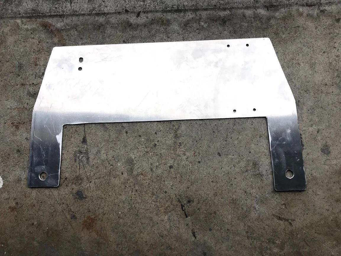

My plan is to build bracket for the radio under driver seat. On the bracket I will install EMI filter for radio(s) power and power distribution block.

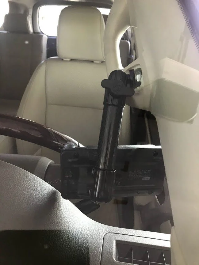

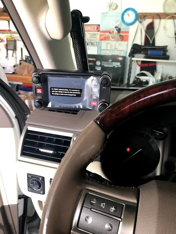

My initial plan was to install RAM rail on the center speaker grill and attach holder for FTM-400 and FT957 control heads on it.
For right now I decided to install permanently only VHF/UHF radio. For HF will do different setup later.
Still not 100% sure where to install radio itself. Without mods like 3rd row elimination there are only two reasonable options:
1. Under the front seat. Pros - easy. Cons - potential water damage in case of high water crossing.
2. Jack compartment. Pros - more protected area from water. Cons - more work for setup, extension for mic and speaker needed.
At this moment will install under the driver seat. Bracket under construction will post some details soon.
Bracket is done. A little issue with components. I ordered Rigrunner 4004U, which is 4 ports plus 2 USB ports. Will be delivered next Monday.
Put another model just for photo.

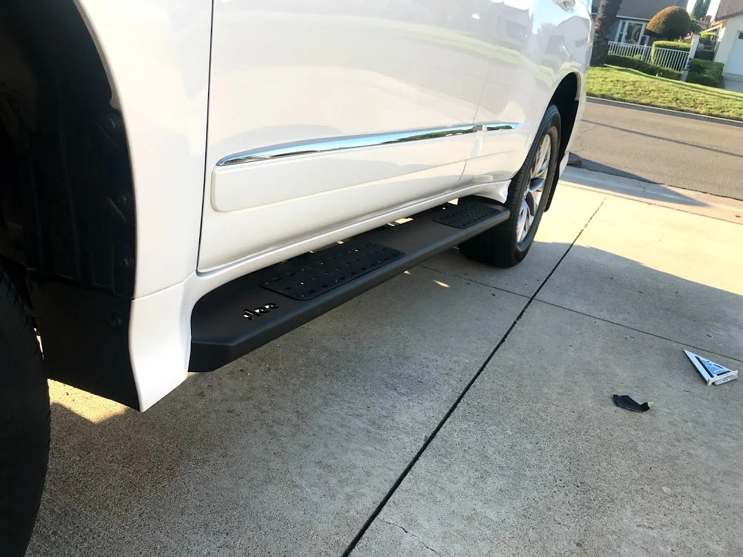

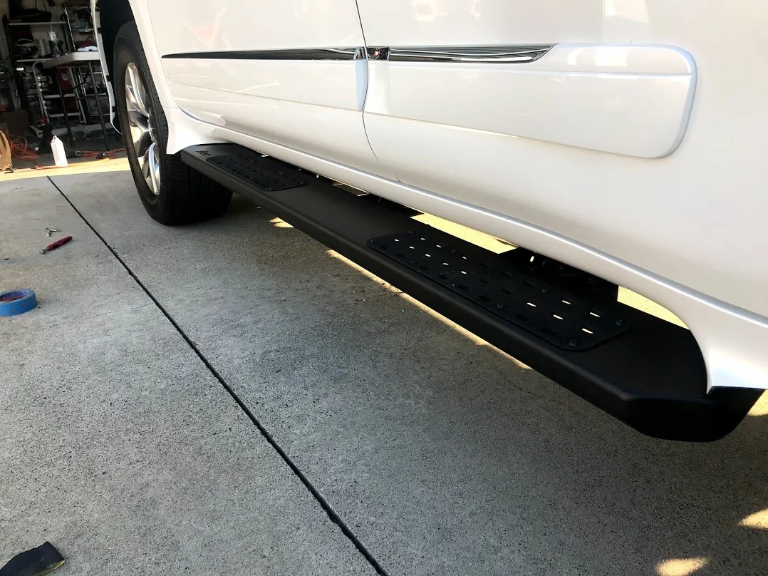

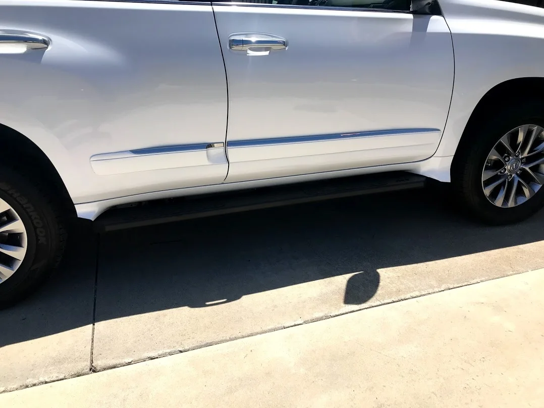

Slee rock sliders are installed. Few words about product and installation:
1. Outstanding manufacturing and packaging quality
2. No frame drilling is needed. Only cutting plastic parts and KDSS lines skid plate.
3. Installation is a little bit intense but nothing hard. I did it alone in one day with brakes to watch soccer game.
4. On GX460 light kit can be installed after sliders installation. I did it before, which is much easy.

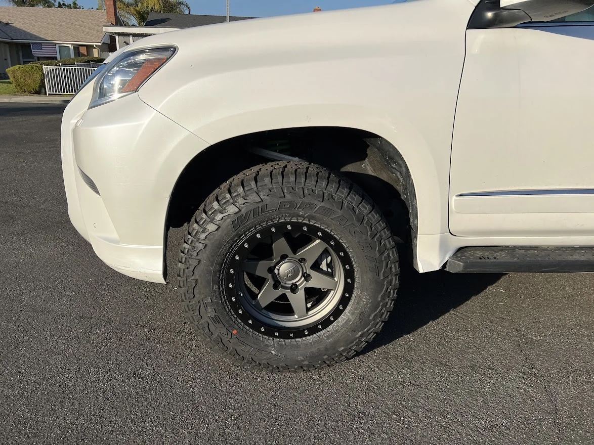

SCS BR6 17x8.5 -10mm offset with..... Not decided yet
Between all this mods I went to few trips to North of CA and AZ got some scratches on the stock wheels, body and rock sliders.
After alignment there is a little rubbing on body mounts both sides. So BMC is needed. Tires are Falken Wildpeak AT3 285/70/R17
