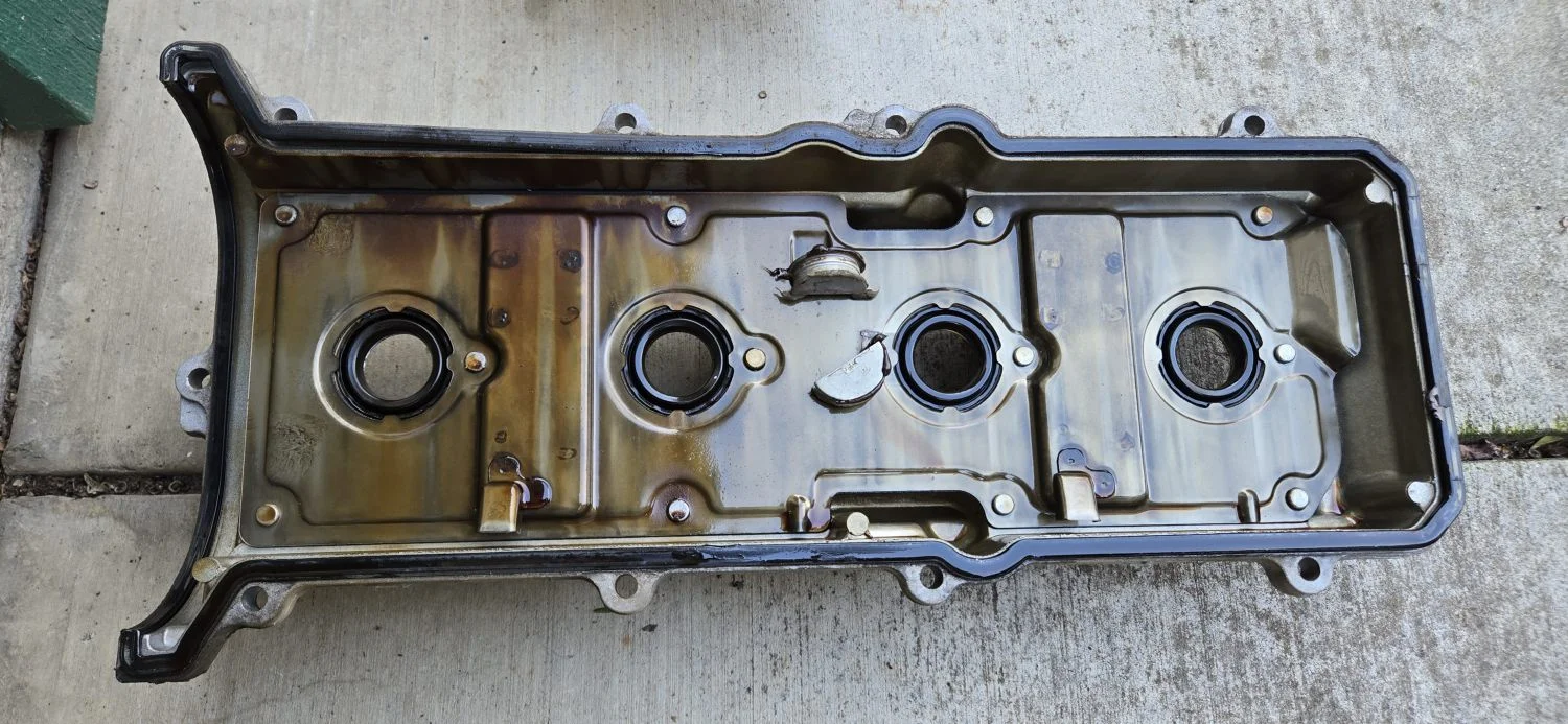

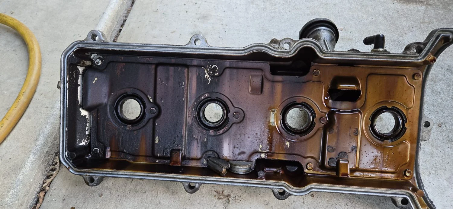

2003 LC (US model) with 227,000 miles. I'm the original owner and it has always had scheduled oil changes and maintenance. Around 150,000 miles it blew a spark plug out of the head, I think the driver's side but I don't know which cylinder. It was repaired with a coil insert.
I was doing it's first valve cover replacement today after I found a lot of oil leaking down the left side of the engine. When I pulled the valve covers I found lots of build up and discoloration of the driver's side rear and valve train. The passenger side looks fine. The engine runs great. The oil only has about 3 or 4,000 miles and looks good but it's due for a change anyway, it's been a year.
Is this a problem? Or just clean it up and go?
Thanks,
Chris
Driver's side valve cover, rear is left.
Driver's side valve train
Passenger side valve cover, rear is right
Clean it up and go. Make sure you replace the spark plug tube seals, they are probably hard as a rock.
Yep, new tube seals are in.
Thanks.
