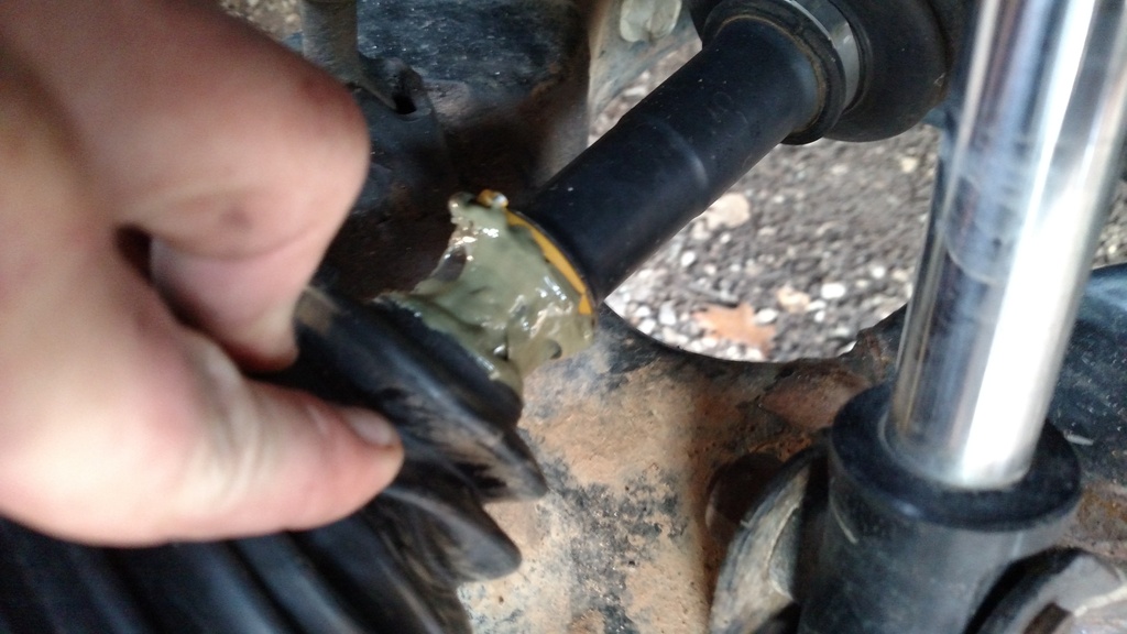

At first I thought maybe it was the front diff but upon inspection I seen this
The boot tore underneath the small clamp and broke somewhere internally. I can't take it apart to inspect it yet as Toyota will warranty it.
Over 200k miles were on the old axles and the only reason I replaced them was for worn out splines. About this time i had also installed icon remote resi shocks. The new factory axles have only 3500 miles on them and I can't see why it would snap other than overextension. Has anyone else had this problem with long travel front shocks?
