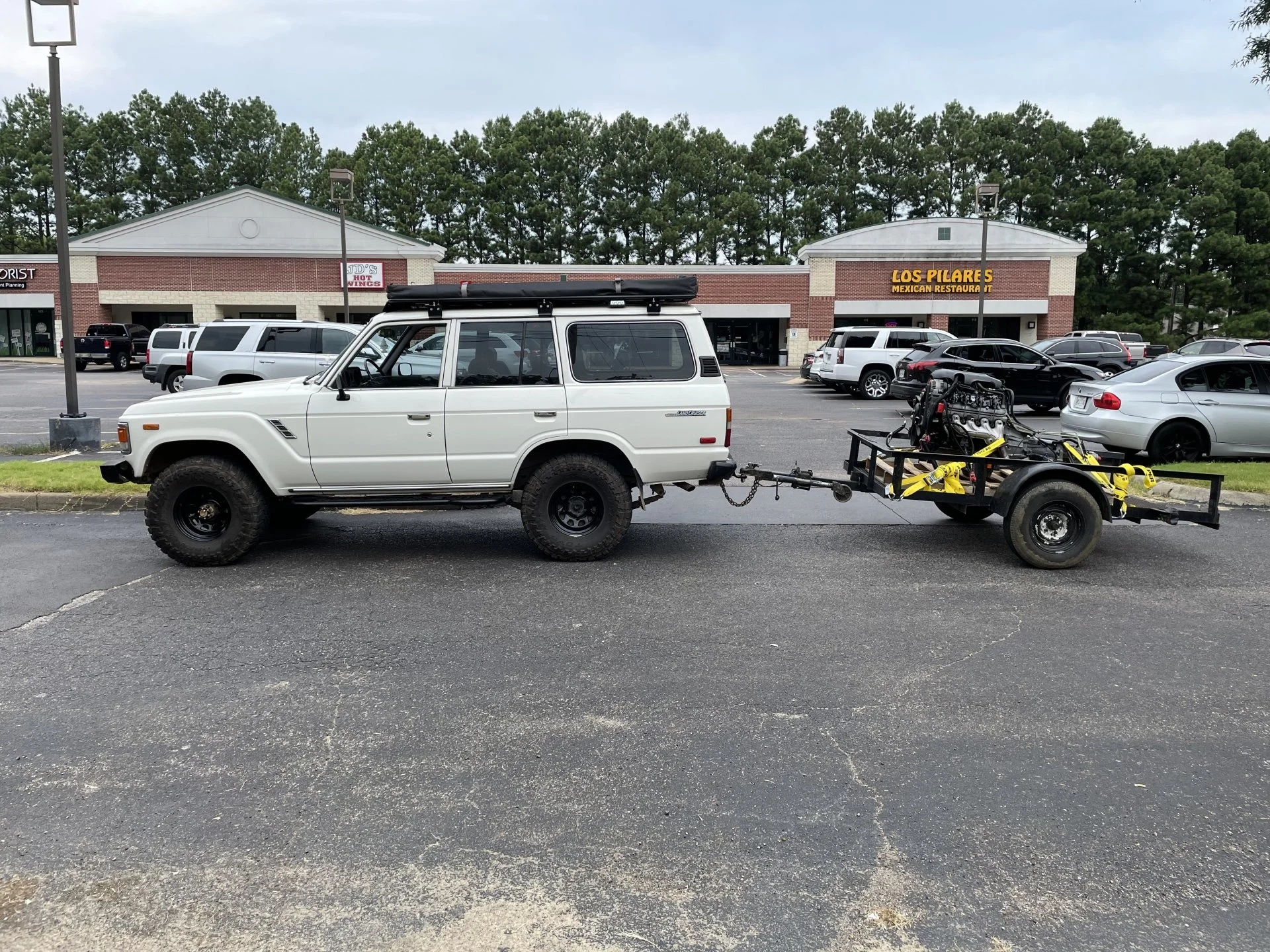

LM7 5.3 with 70K miles and a 2wd 4l60e off the back of it.
Brought it back home and felt kind of bad towing it with the 2f in the 60

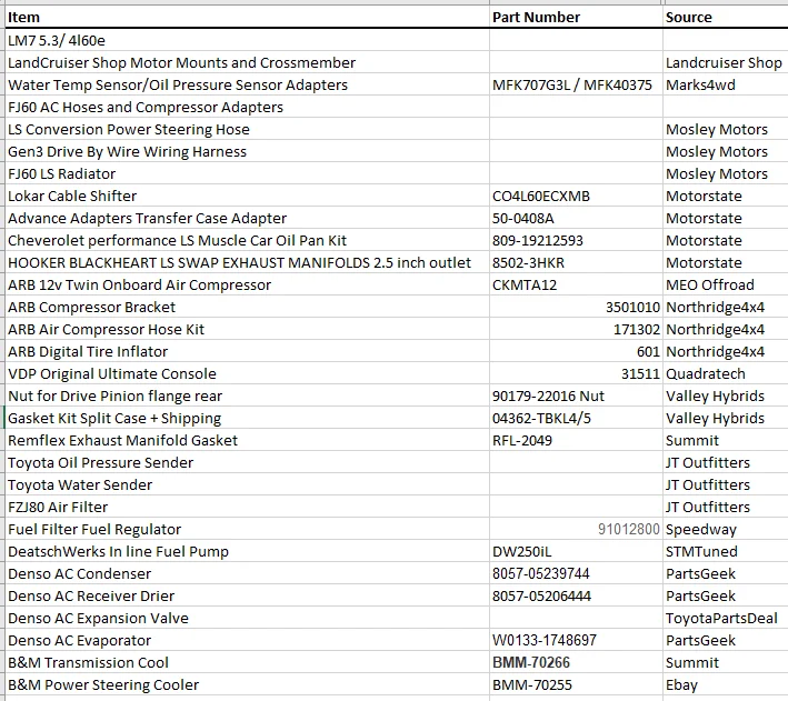

Parts list so far. Just in case anyone was looking to do the same. You never know who is reading this.... so the prices have been secretly omitted.
