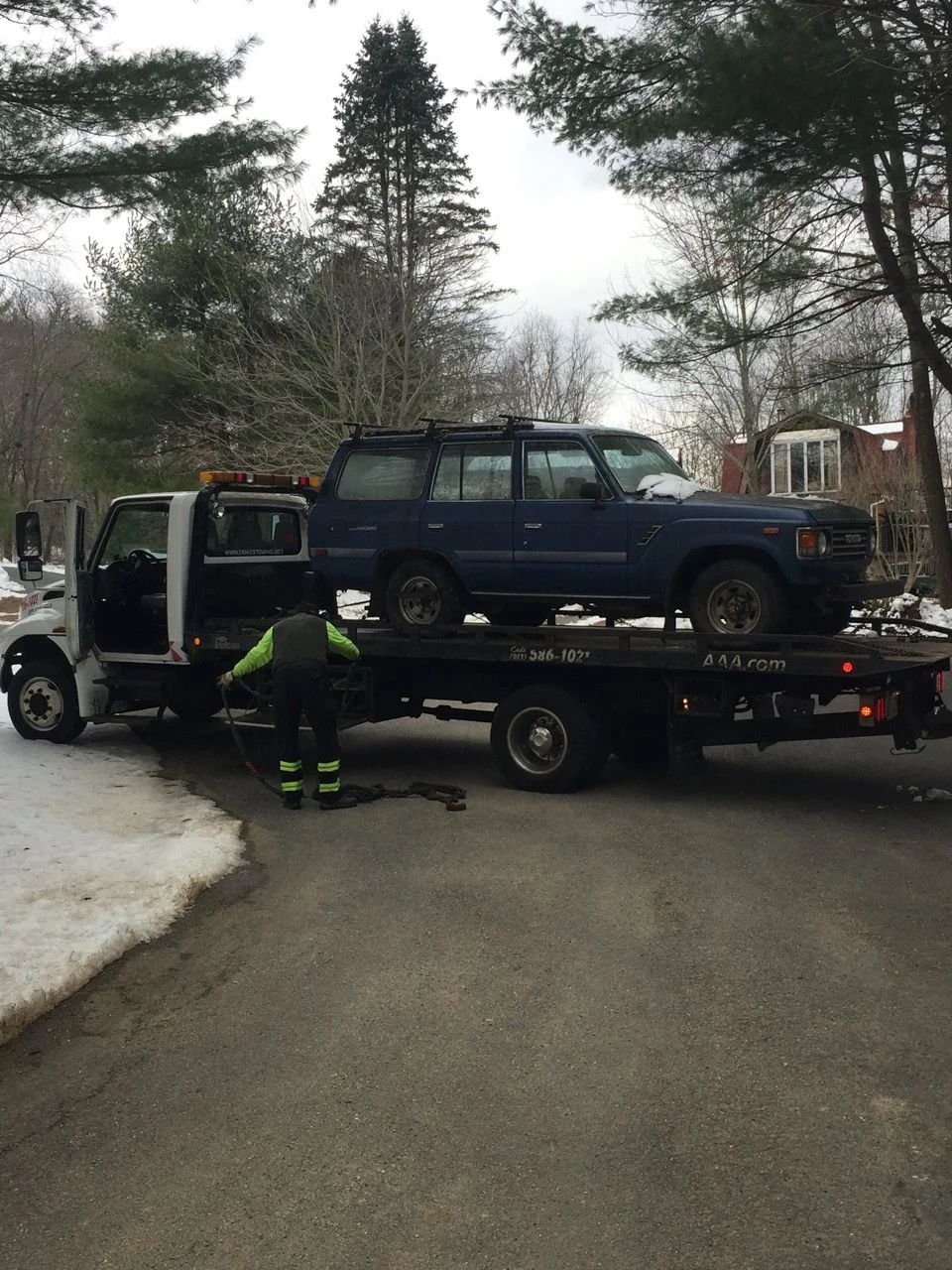

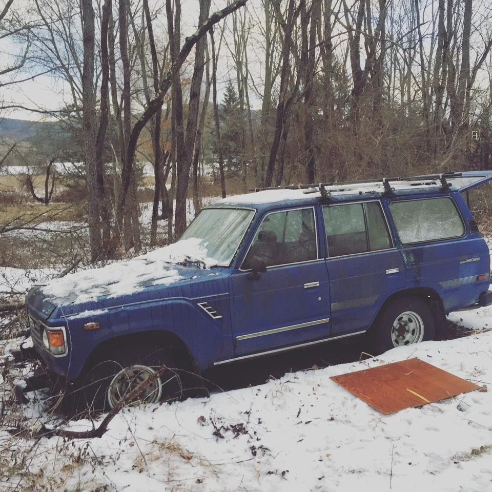

Buddy of mine was looking for a new home for his '86 FJ60, which has sat in a field for ~ 4 years.
Price was right ($800), and he's got boat loads of parts for both 40 and 60 series trucks that were included in the deal, so I couldn't say no. Especially since the :princess: said, "Oh, great! This one can be mine!"
Anyway: frame, body panels, glass, all are solid. It hasn't run in ~ 4 years, but the 2F is intact, oil looks fine, and this weekend I'll charge the battery, try to turn the crankshaft a bit by hand, check the plugs, and add a bit of gas to the carb to see what we've got.

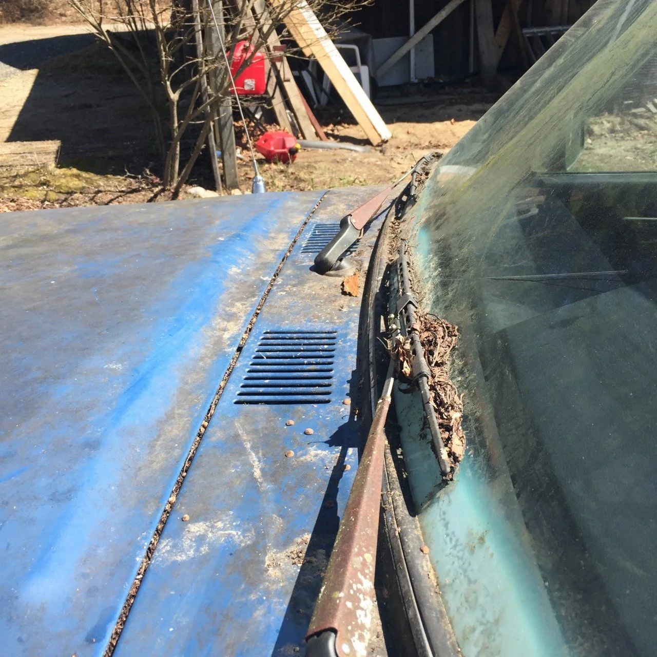

This pic shows 4+ years of mouse nests, choke cherries, and other crap that was blown out of the exhaust pipe today:
If you've got that much mouse mayhem in the cruiser, chances are extremely high that you've got a city of nests built up under the headliner. Not sure what you could do about that though.
@Output Shaft, yeah......I think it's likely, too. The liner in the hood is eaten away and clearly has been nested in. Will have to pull almost everything out, I bet. But, that'll give me a clean slate, chance to throw some dyna-mat in, and put it back together. I have no illusions that this'll be a rough work / chore truck!

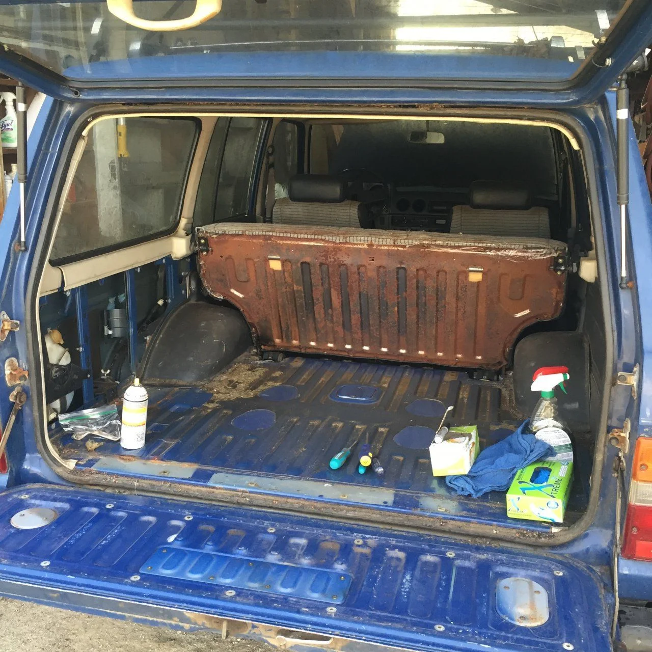

Had some time to make some progress on the 60 this weekend. Pulled out the rear carpet, sorted some spare parts that came with it, and did a bit of cleaning.
Seems like I need to replace the fuel pump, and then hopefully it'll start moving around on it's own.
Panels underneath the rear carpets and bench seat looked to be a good shape.

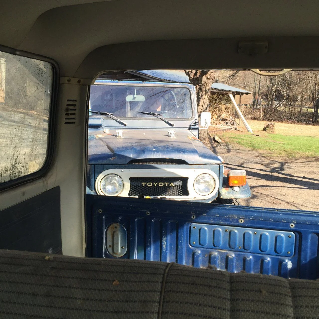

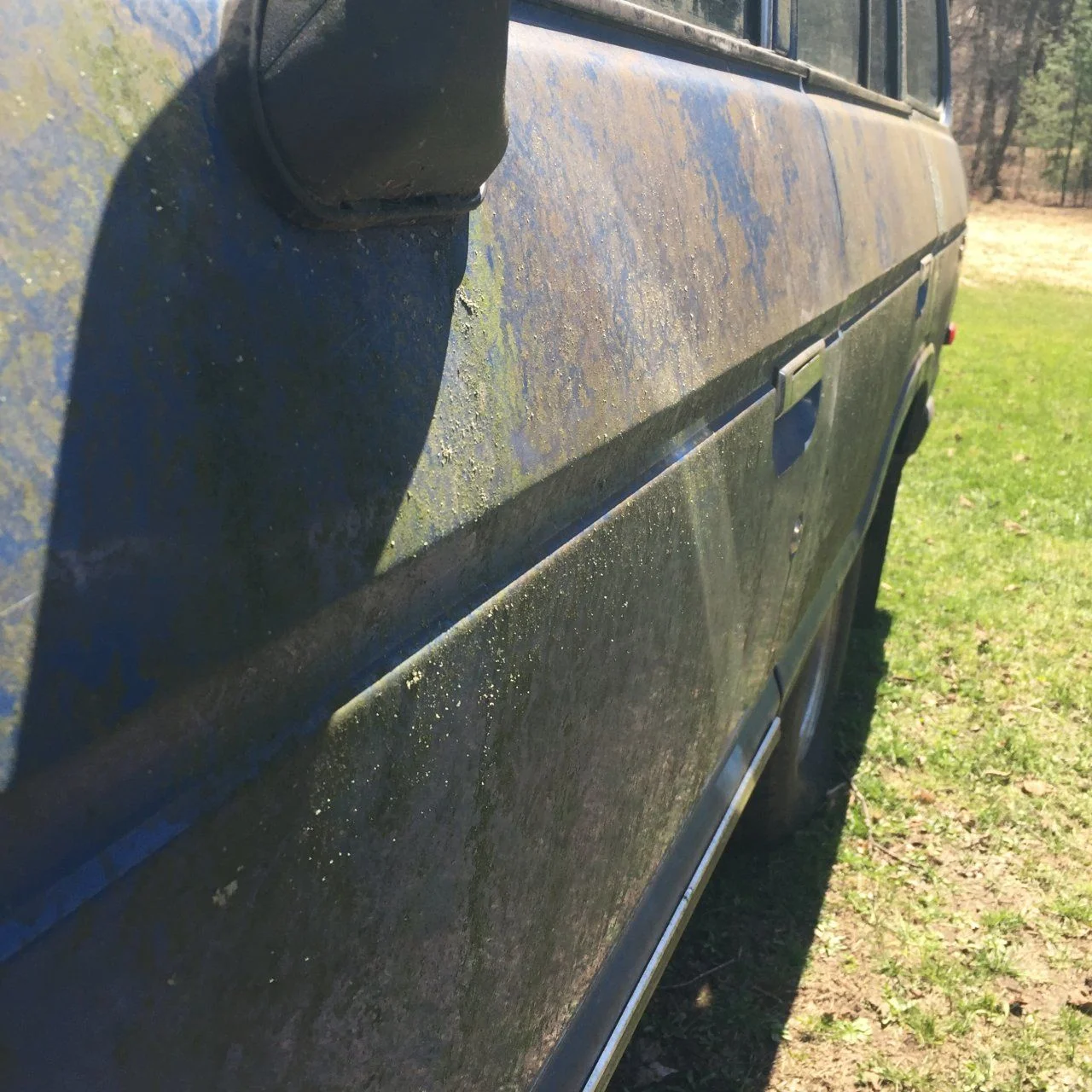

Got some help from my younger brother today. He drove my FJ-40, and we used some logging chain to help pull the "new" FJ-60 out of my barn and into a more open space for cleaning and work. Some light pressure washing and cleaning should get the exterior into a more sanitary condition, and I'm hoping to get a new fuel pump in this week. I've got a busted foot right now, so progress is slow....

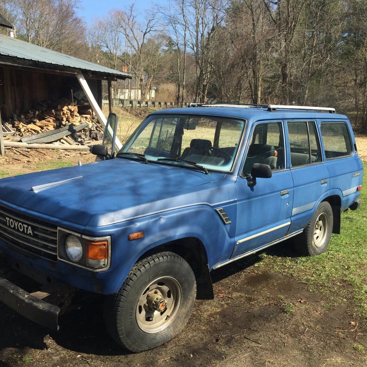

Made a little more progress this weekend. Took a pressure washer to the outside to clean off 4+ years of lichen, moss, mold, decaying leaves, and who knows what else. I'm pretty happy with how it turned out!
Also spent a bunch of hours vacuuming out the inside. Took off as many access panels as I could find, and was met with nasty mouse nests at every turn. So far only a couple of wires look chewed up.
Looking good! I've actually always enjoyed the full interior tear out and clean up on an unkept old rig. Pulling out all the seats and carpets and panels isn't easy but it makes cleaning up so much better. After you reinstall everything and it's all clean and the whole car smells like Simple Green it's a very satisfying feeling.
I've never had to deal with a lot of mice nests though. Definitely check and recheck all of your wiring. It would be a shame to get a fire or something in it after all that work.

Ha, yeah. Just randomly happens that both are blue. The 40 is destined for a repaint in it's original lighter blue color, but that's a few years out.
