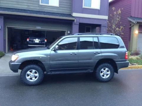

Hi I'm new to this site and wanted to say hi. My name is Joel. I recently got a 100 series and have been using this site to help with building it which has been a huge help. I'm coming from an 06 4runner.

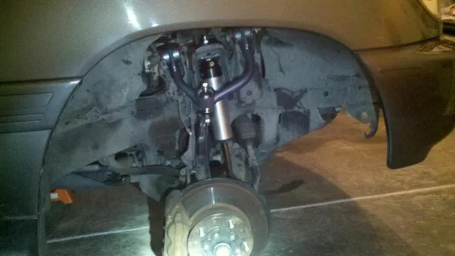

Now to my 100 it's a '99 with the rear diff lock. I have installed Radflo 2.5 shocks front and rear. I had these on my 4runner and loved them! I also put on Iornman front torsion bars and rear coils, and Total Chaos UCA's. For tires I went with Goodyear Duratracs 285/75/16's.
Before lift
Installing
After lift
I have since adjusted the tbars down in the front.
A lot left to do but that's the fun right!

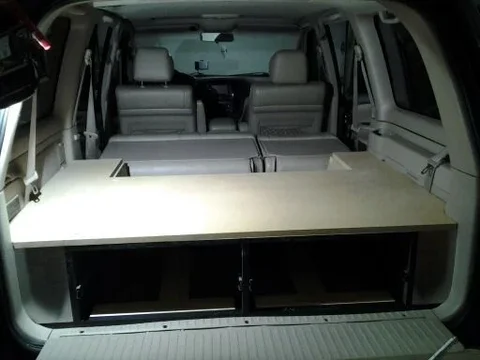

Here is an update. My brother is a custom cabinet maker. He is building me a custom drawer system. Here are some progress pics.
I will update when it's completed.
Also ordering my rock sliders today!
How are you liking your Radflo's so far? Are your front ones longer than stock to maximize the extra droop of the TC uppers or stock length?
Nice looking build.
Nice looking build.
I like them a lot so far only one short off road trip with them. Yes they are extended length shocks.
