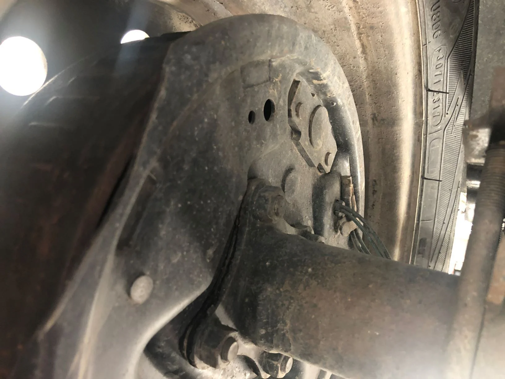

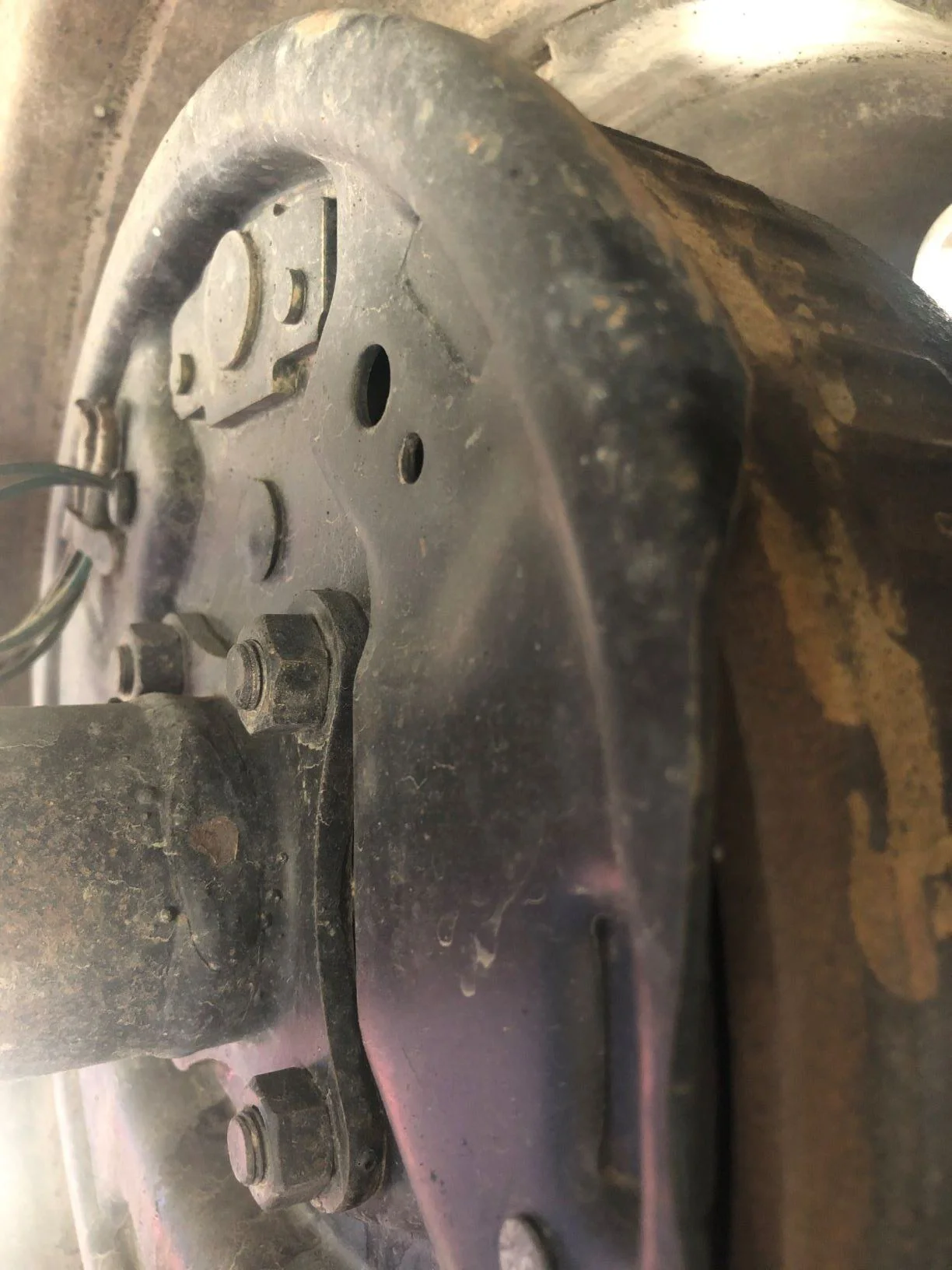

@greentruck I looked at my 3500 lb axle after browsing the other thread Trailer Park Break solved and took a couple pics. I don't have the lever so I must have the "TruRyde 10" Self Adjusting Electric Drum Brakes" choice from your 1st post. I know that they are the self adjusting, since I just packed the wheel bearings. I wouldn't touch drum brakes that weren't self adjusting, IMHO. I agree with your choice of electric brakes, especially after examples that @pb4ugo posted. In pics of mine, it's plain to see where the lever should go if I was to add a parking brake. The plugged hole between the rivets, on the rectangular plate at the top of the brake backing plate is where the shaft that the parking brake lever would be attached to, to activate the parking brake - if it was there. Not sure if I could purchase parts, but I'm sure that one could salvage what's needed at a well stocked trailer graveyard. But for now, tire chalks work fine for me.
Thanks for the pics, that does look like where the lever would go.

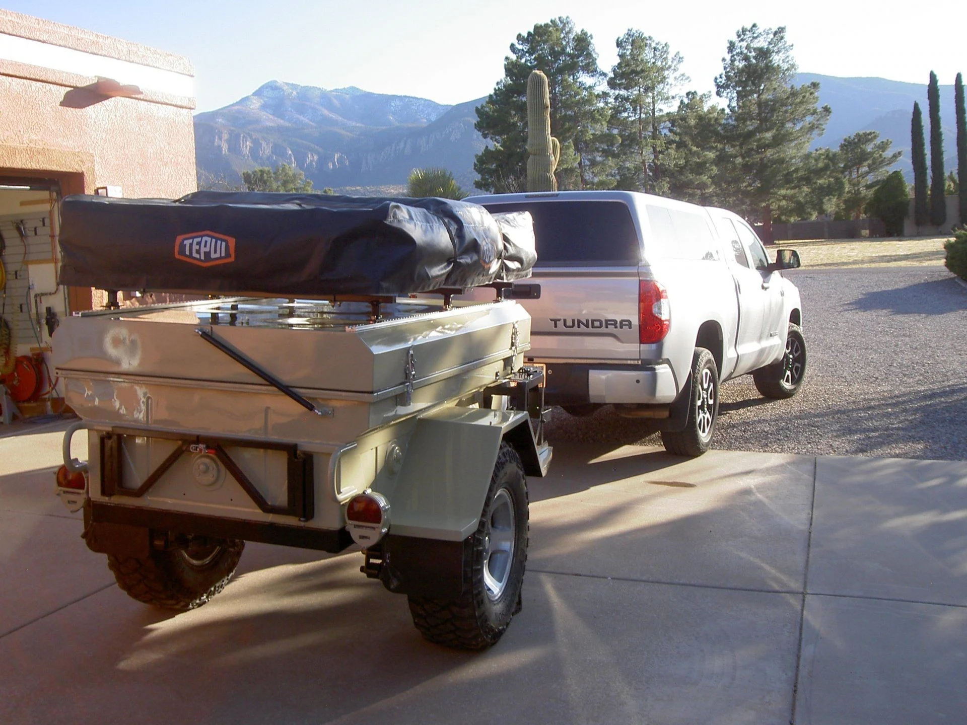

When I measured for mine I included measurements for the perches and they came welded on. It's a genuine Dexter axle I purchased through a broker in SE Texas.This was about 4 years ago and the axle delivered to SE Arizona
cost around $130 or so. Trailer is on 33" tires and 80 series wheels to match my 40. I built custom fenders for the trailer. Kept the original brake cables. just shortened them and had a friend machine new yokes for the Dexter brake
levers. I cleaned up the springs while I was at it. Hardest part of the whole job was removing the old bushings. Good luck with your trailer. They are really great rigs. Sorry for the thread hijack. 🍺

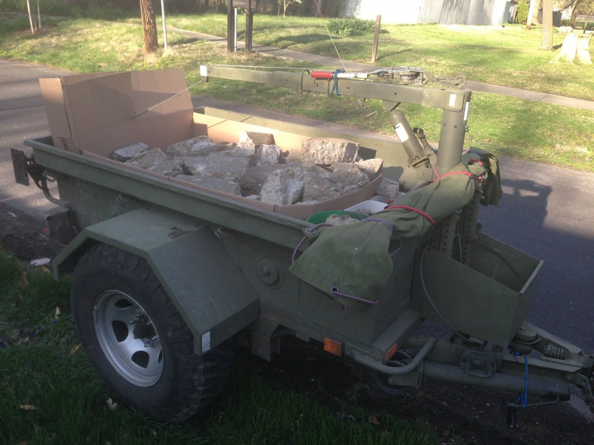

Nice looking rig you have there, Jim. Here's a pic of ours.
Today it's hauling chunks of concrete, so more brakes could be a good thing. Got the axle spec-ed out and almost ordered from Southwest Wheel. Their Hold spiel noted they take Paypal, but when we go to to the end the sales rep seemed confused about anything besides a credit card. Said he was going to check on that, then never got back to me, so will call them tomorrow to get that squared away. Glad I got my order # from him. They would take an extra 4 to 6 weeks to come up with a 54" axle, so went with the 55" they stock.
Thanks Mike. Ours used to look like yours complete with rock fill for the yard. I like the hoist you mounted on the front. The wider stance of of the new axle will be a plus.

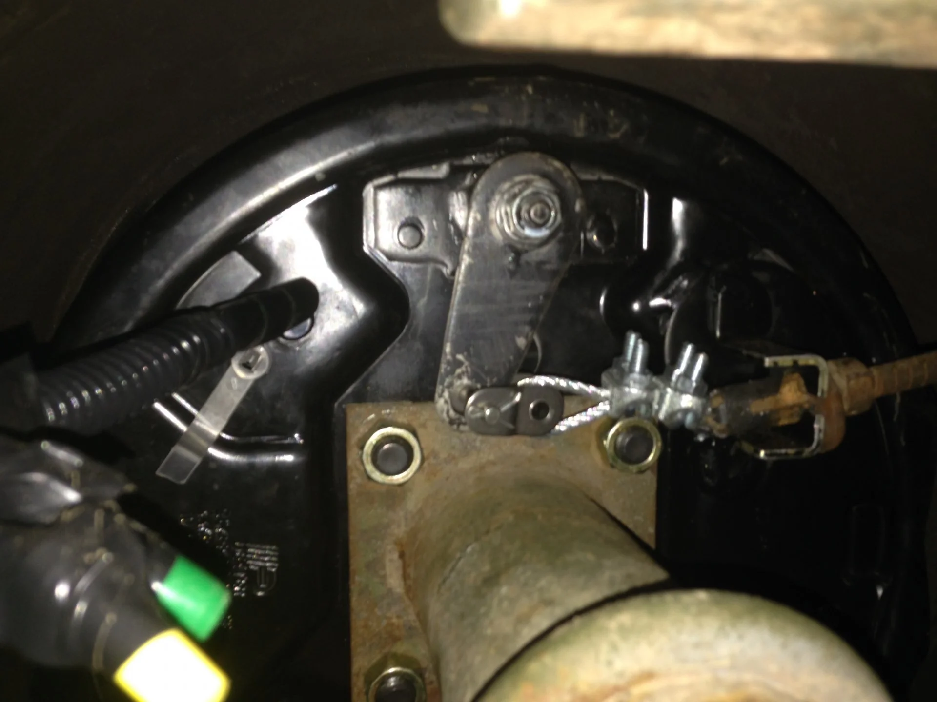

The new Dexter 10" electric brake assemblies bolt right on to the existing axle. The old manual-only ones should be in pretty good shape unless the trailer was drug around with the parking brake on. This led me to simply reuse the existing drums and save the new ones for future work, along with the bearings and seals that came with the new axle. If your drums/hubs/bearings are good enough to reuse would be another way to save money on this conversion.

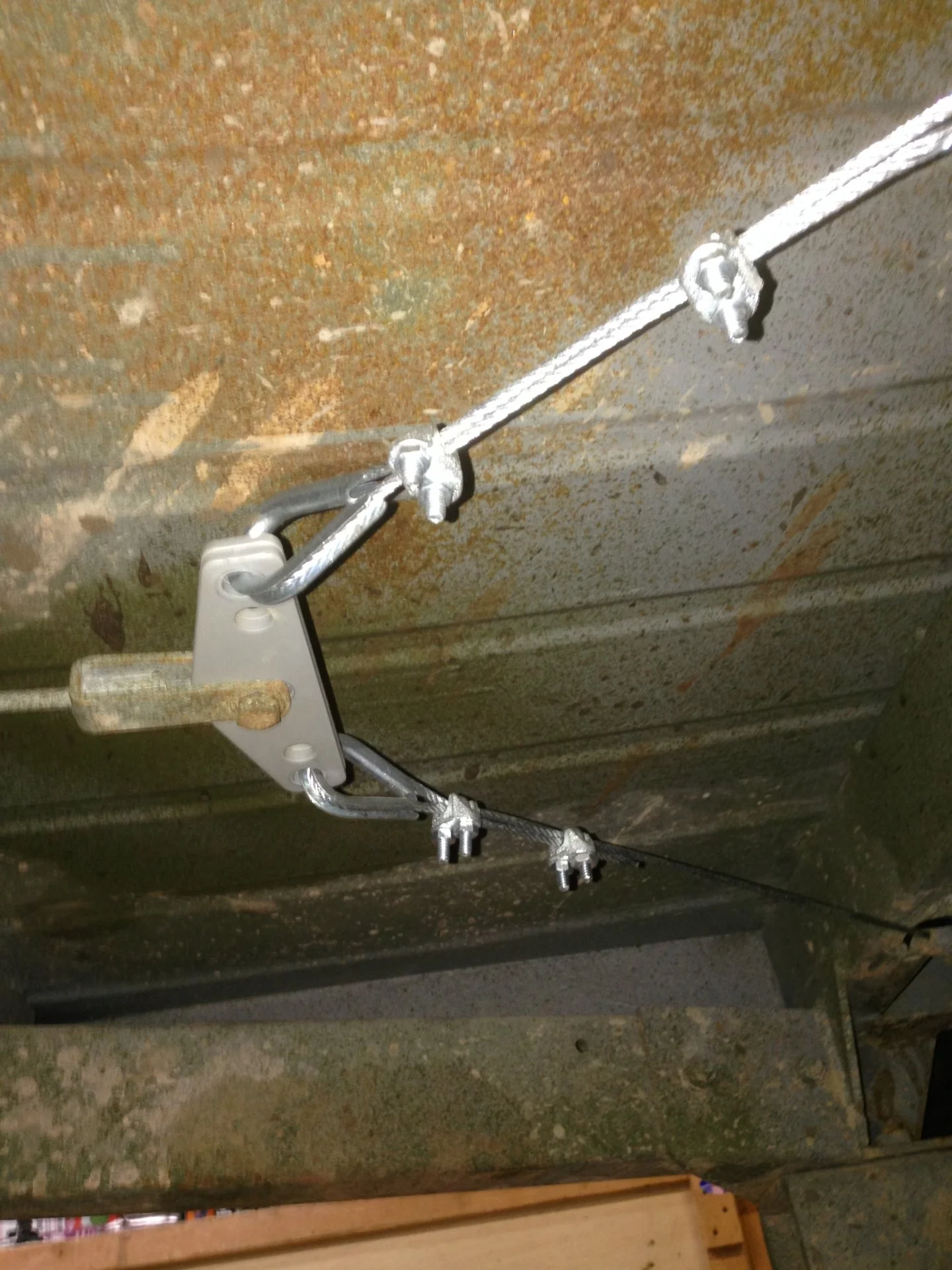

I replaced the back part of the parking brake cables with new stainless steel 1/8" cables. I had a nice recycled (from my wife's old Schwinn exercise machine) bracket I used to replace the old one where they split to go to each wheel under the front of the trailer.
I attached cables back to the wheels, using the old cable housings, to the brackets on the brake backing plates by using thimbles to protect the cable ends and 2 standard cable clamps to fasten each end. I hillbillyed the other end, using a offset chain drive link to attach to the parking brake lever.
Ideally, you want cables with permanently swaged on cable ends so there is no chance of those failing vs the clamps I used. Since it's a parking brake and I should be able to keep track of any loosening, it's good until I can arrange a truly suitable aftermarket cable set like this:

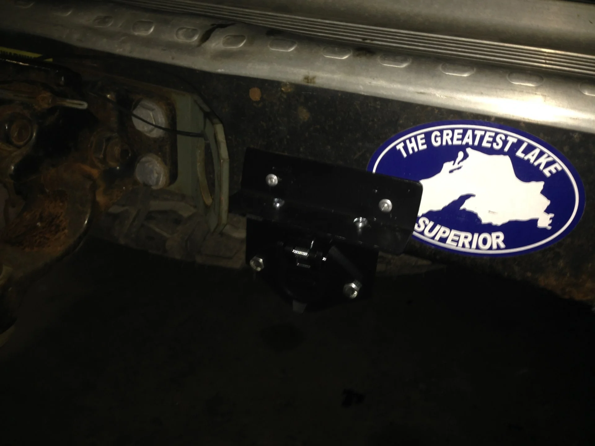

I had a flat 4-conductor connector on the trailer. I ran the blue brake wire I needed to add back to the brakes. The instructions say to ground the other side through the body, but for me it seemed worth the small added trouble to extend the ground wires forward to the original harness where it grounded to the trailer near the hitch.
There I used a round 6-conductor connector plug to add a brake circuit. It has one more circuit available if I wanted to run 12 v power back to the trailer, but I'm good for now.
I fitted a small brake controller to the left side of the underdash after fishingt the blue brake lead forward. I entered the cabin via the grommet around the rear sunroof drain, very easy to do. Hardest part was hooking one lead from the brake controller to the green with yellow stripe 2 wire in the ID2 connector in the driver's left kick plate. This is much "easier" than trying for one of the leads from the brake light switch itself, but still not easy. Beside it and the blue wire leads to the battery for + and - power finished things off.

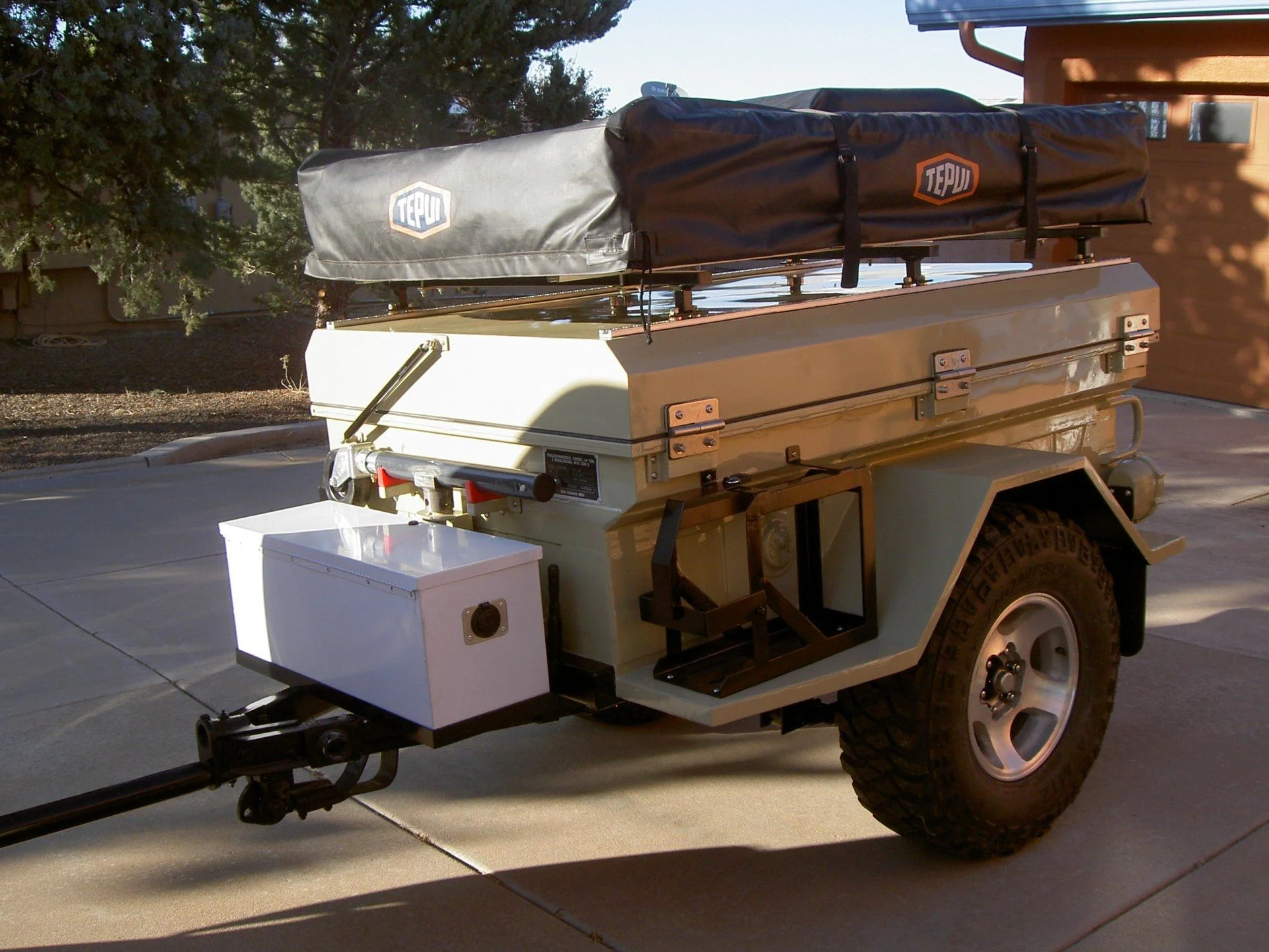

Jim, your trailer looks amazing. I love the fenders. I love the front box and the lid. It is all exactly what I want to do with mine.
Mine has been sitting for a long time because it is still on the stock tires and I don't want to waste money on new tires if I am going to do an axle swap to run 80 series wheels
A few questions--
When you ordered your axle did change the width to account for the difference in backspacing between the stock CDN 101 wheels and the FJZ80 series wheels? Or did you just stick with the stock length on the axle?
Do you have the specs on the spring perches?
Did you do a spring over or other lift to fit those tires?
Finally-- and this is off topic-- where did you get that extended lunette?
