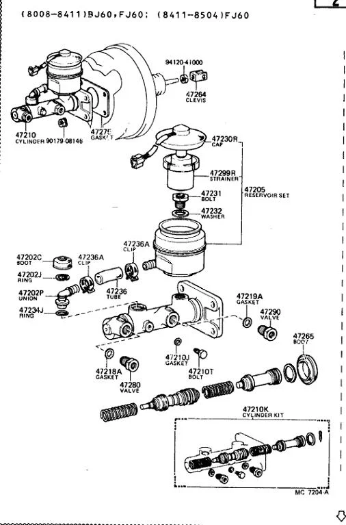

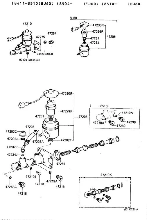

Here's the parts diagram. I don't know if you're replacement is the same. It doesn't make sense that a bad gasket between the reservoir and the MC would cause you to have to pump the brakes. Sounds more like there is air someplace. Did you bleed the master cylinder? have you bled or re-bled the brake lines?
yeah i've seen the diagram on sor, it doesnt show the o-ring. when i press the pedal i can hear the leak at o-ring, air is a possibility just changed left wheel cylinder.
