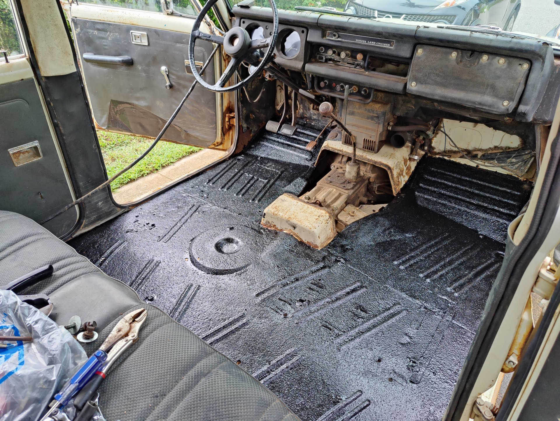

So I got around to sealing my floors up. Had some leftover bedliner and decided to coat the insides of the wheel wells. I think it turned out nicely. Days like today l, and the instant gratification that painting brings, really makes the truck feel like it's coming along well. Also got some gear from Ace Overland in today.

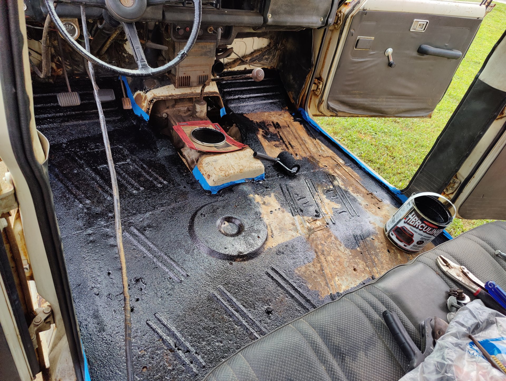

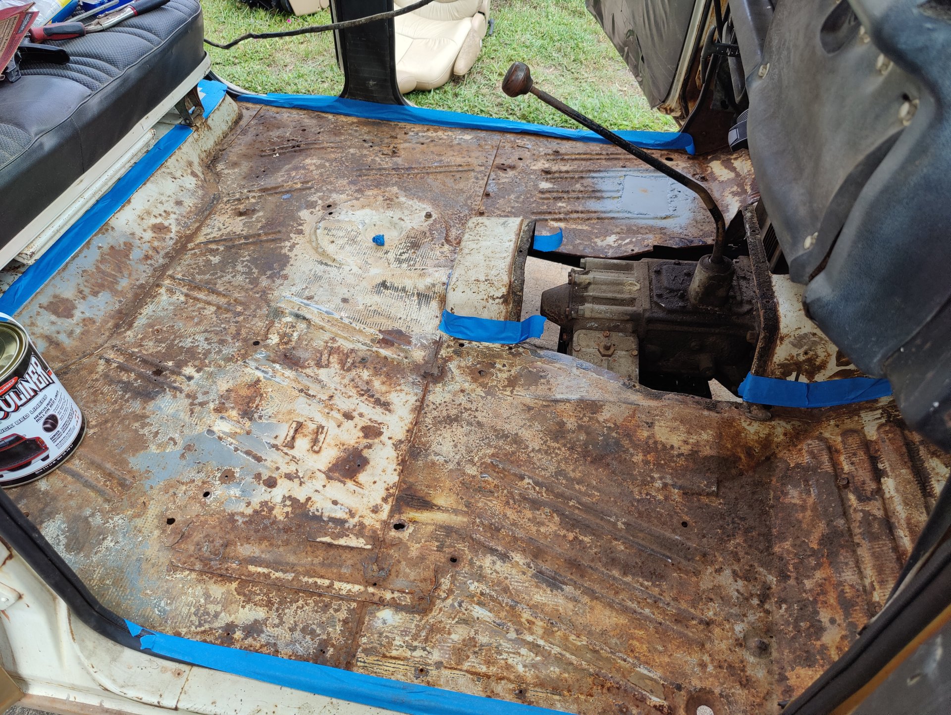

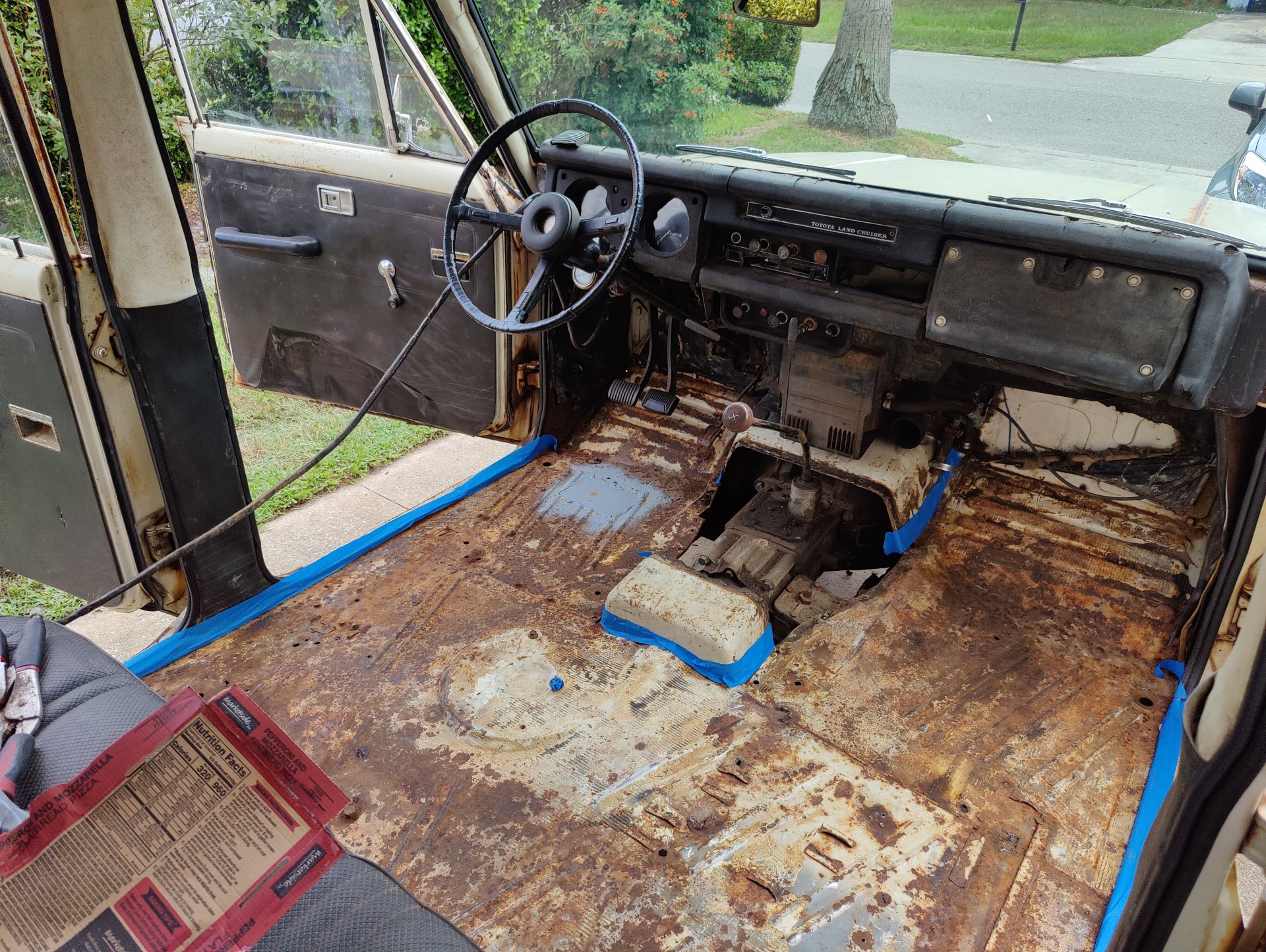

Did you passivate that rust with anything or just straight over with bedliner? Certainly looks better; just not sure how that works under bedliner if you don't remove or convert the rust first. :hmm:
There was no rot in the floors (lucky me). Just old paint, carpet glue, and seam sealer. The rust you see is just surface stuff. I do prep beforehand. I hit it pretty hard with a heavy wire cup. That knocks the loose stuff off. After that it get am acetone wipe. Then I start tarring.
I use herculiner because it's cheap and it works. I had this stuff on my 40. It lived outside unprotected and never had any issues. It's rubberized so it seals pretty well on the first coat of you take your time.
In the future you could use some naval jelly (or equivalent product) after wire wheeling and it will remove all the surface rust and you'll have bare metal to apply coating of choice. Apparently the POR stuff likes some rust to stick to, not sure if the bedliner is the same though. Back when I did body work and paint a lot in high school, surface preparation & cleanliness was key. Stuff doesn't like to stick to rust.
You are doing great work on this truck though, looks like it found the right home!
