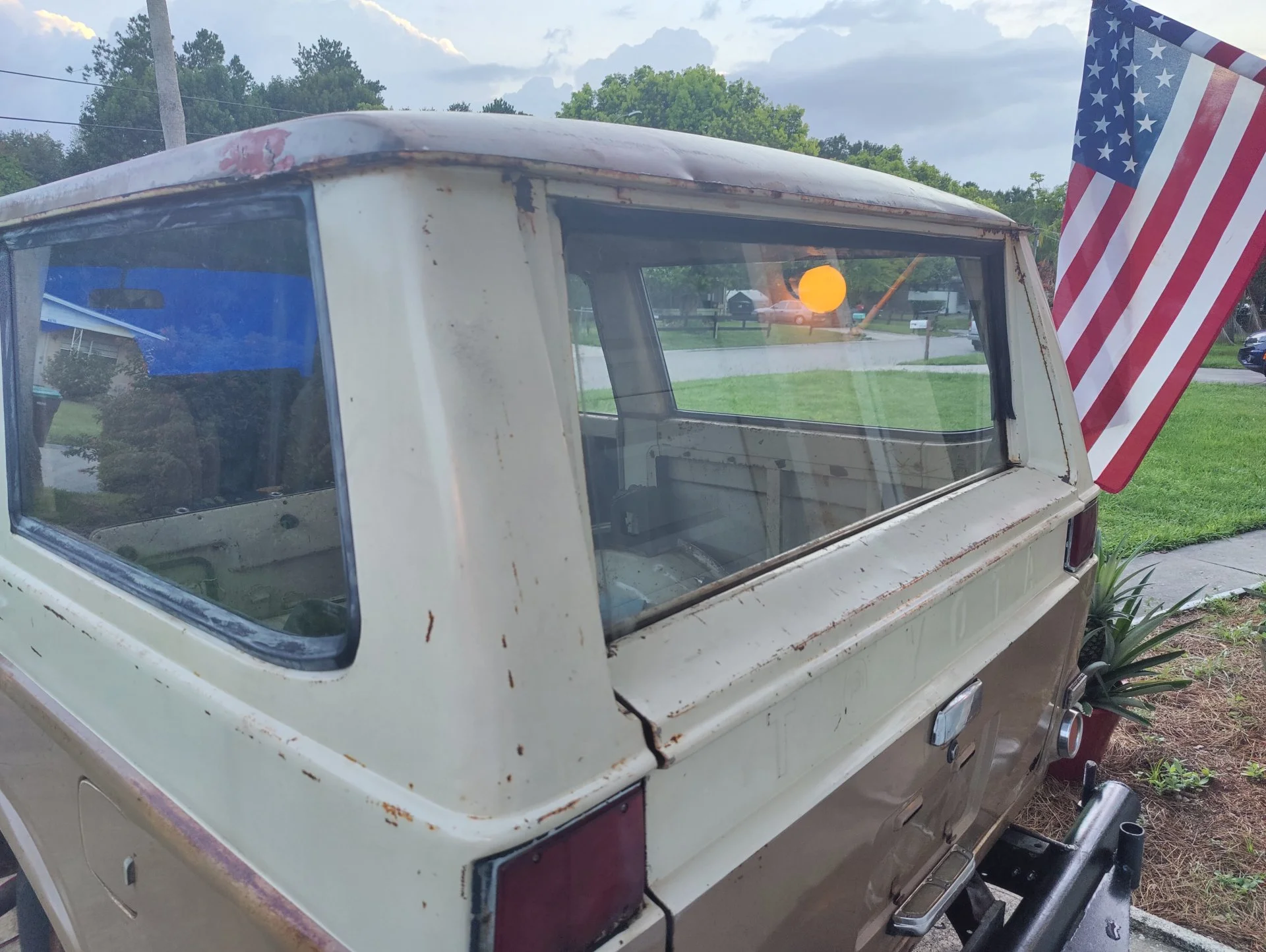

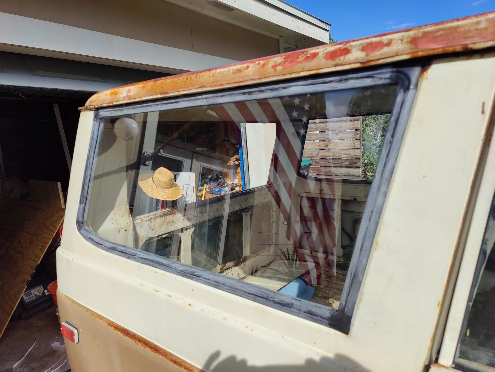

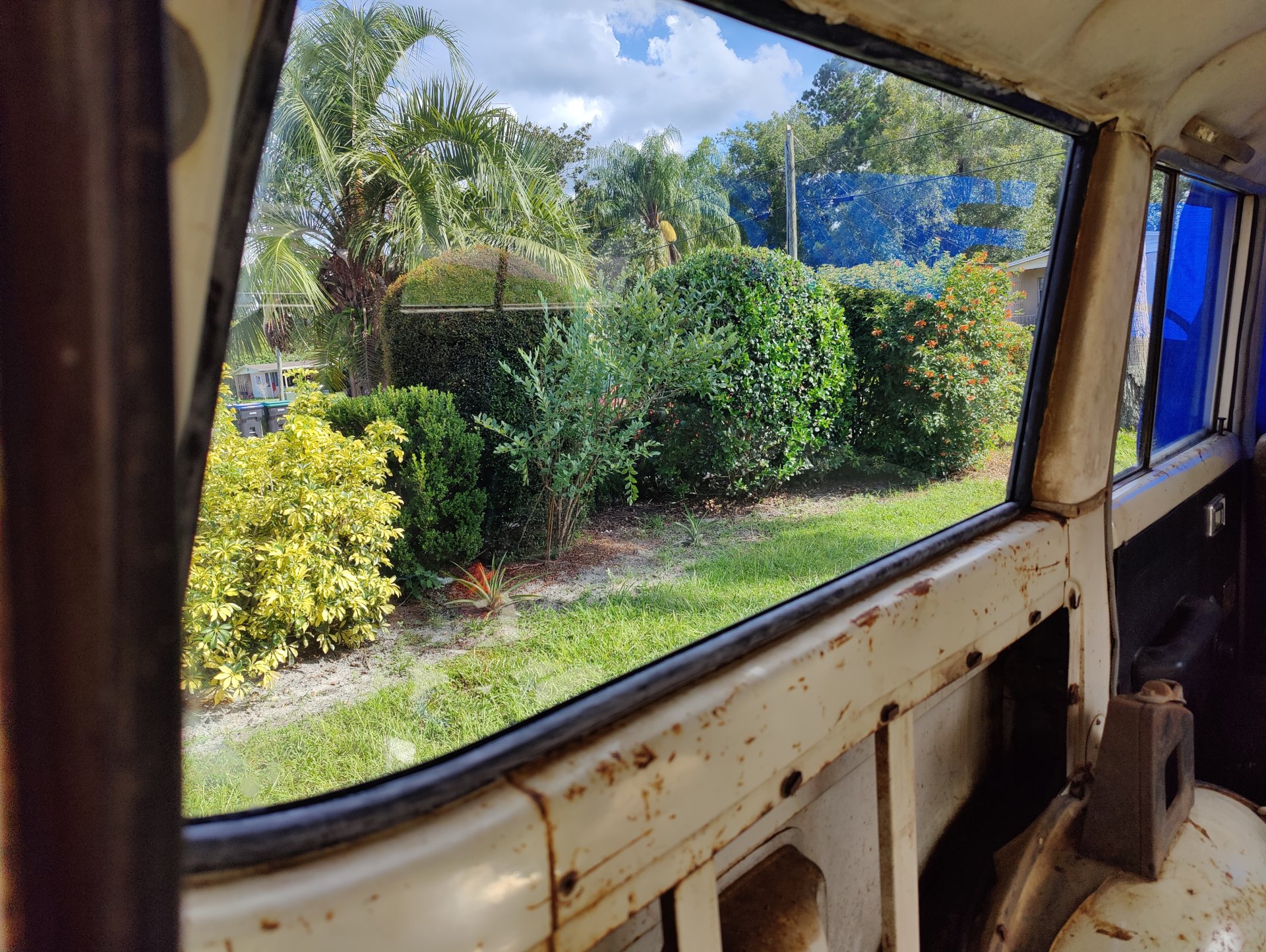

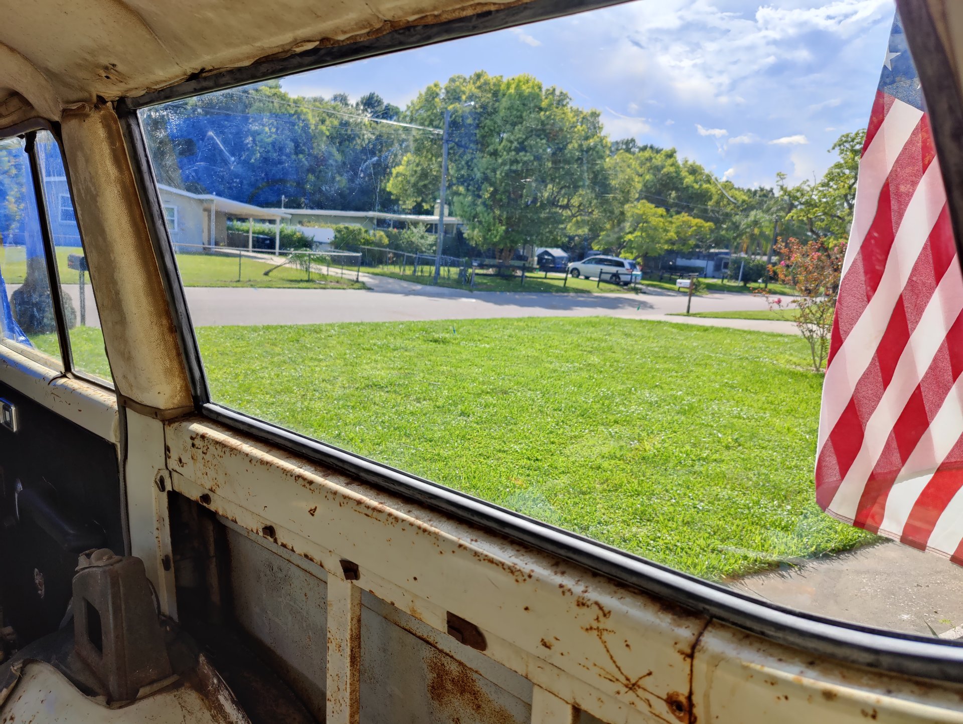

Got the cargo window seals roped in this afternoon. Used these as practice before finishing the windshield. The job went waaayyy easier and quicker than I was expecting.

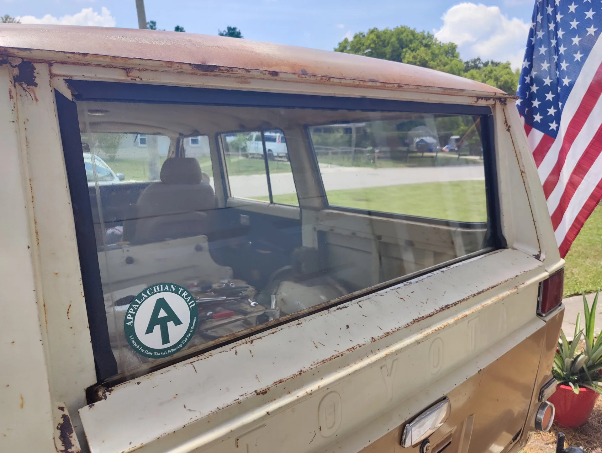

Well I got the tailgate glass to go up and down today. I did the five tooth offset, and I can't tell if it's binding or not or if that's what a 50yr old motor does, but IT WORKS!!!
I had to buy a used regulator from Specter. The pins on my original were rusted out and the rollers were completely missing. The arms were seized enough that I had to cut one off to get to the regulator bolt.
It's been replaced/repaired in the past seeing as all the Phillips head screws were already stripped (needed cutting or drilling to get out) and required new hardware. Other than cursing at the alignment and getting it to fit into the glass roller guides and the glass back on track it was pretty straight forward.

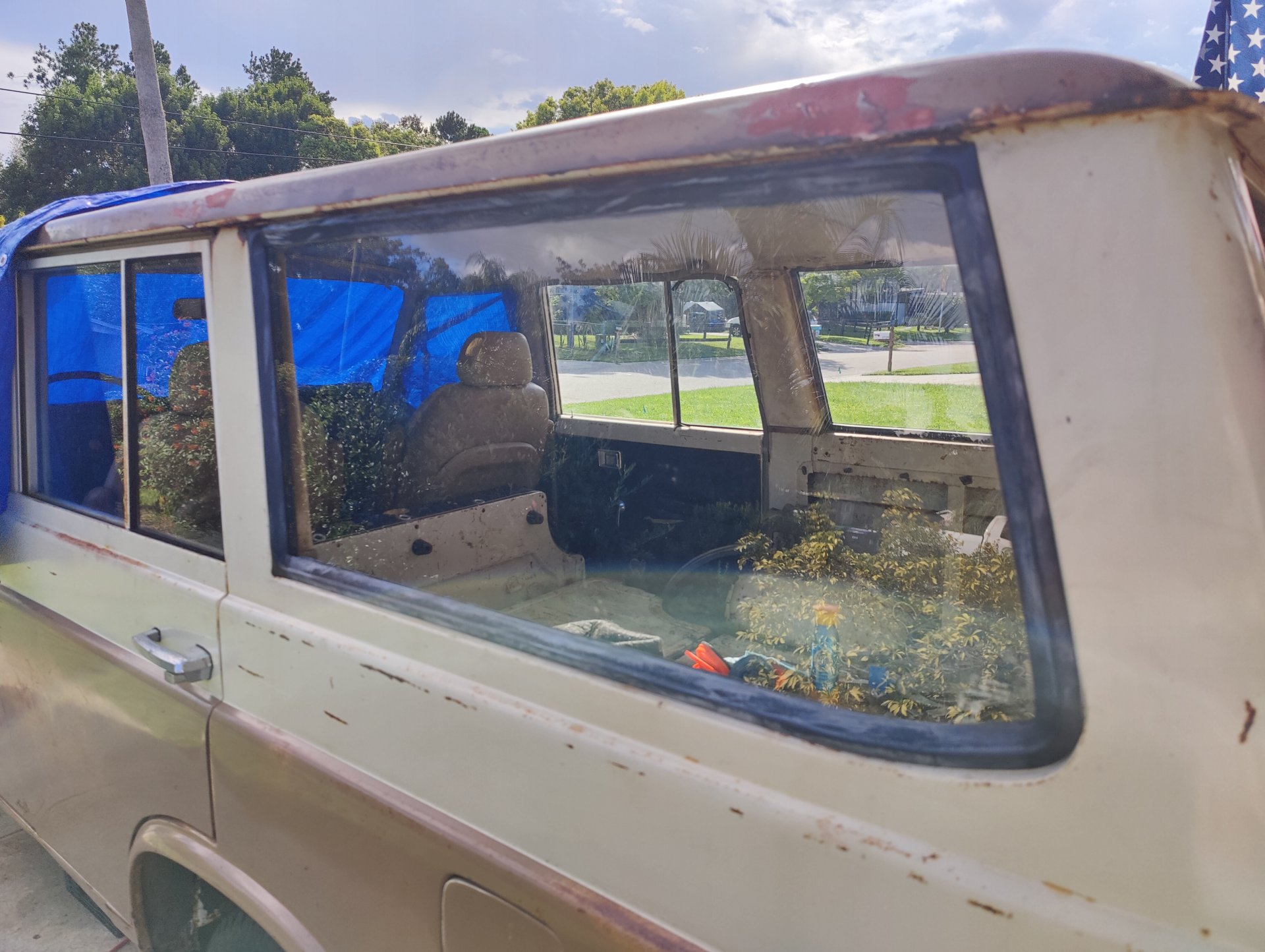

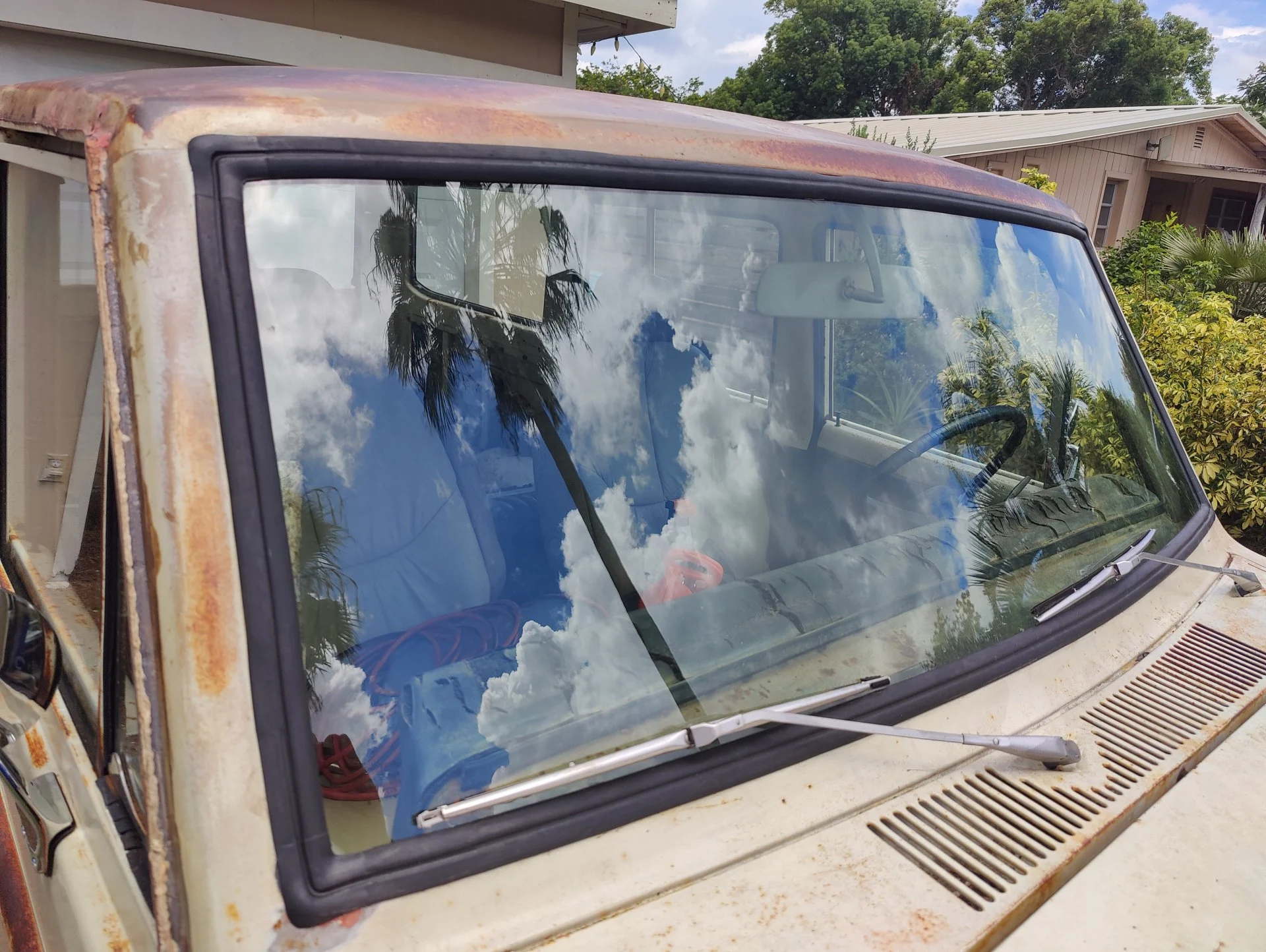

Tried to install the new windshield seal. As I started roping up the sides I was met with anoth crack. The windshield was already old/hazy and cracked. I was trying to be be cheap and save it. Guess not. New glass on order we'll try again with the new glass.
Meanwhile, this felt super tight while roping in. Any tips for windshield seal install?
Agreed! And if they break it they replace it on their dime not yours.
I was afraid y'all would say that. I already budgeted for new glass (the old one needed to be replaced) but I was being cheap. I'll give the new one another try and after that, glass shop it is!

It's all good. I'll always appreciate some advice. As luck would have it my folks had a rock wreck their windshield on a road trip the other week and I was able to talk to their windshield guy (big name company). He and I came to an arrangement once my glass gets here. It's over budget by a bit but totally worth it to get it done right.
So I haven't been updating here for a bit. My bad. I finally called in the glass for the windshield. The glass guy had me worried but he showed last minute and his 20+ yrs of experience outclassed my 20mins of experience. And now, for the first time in several decades, with the door and window rubber installed, this truck is officially leak free. Several Central Florida summer gully washers have tested that out.

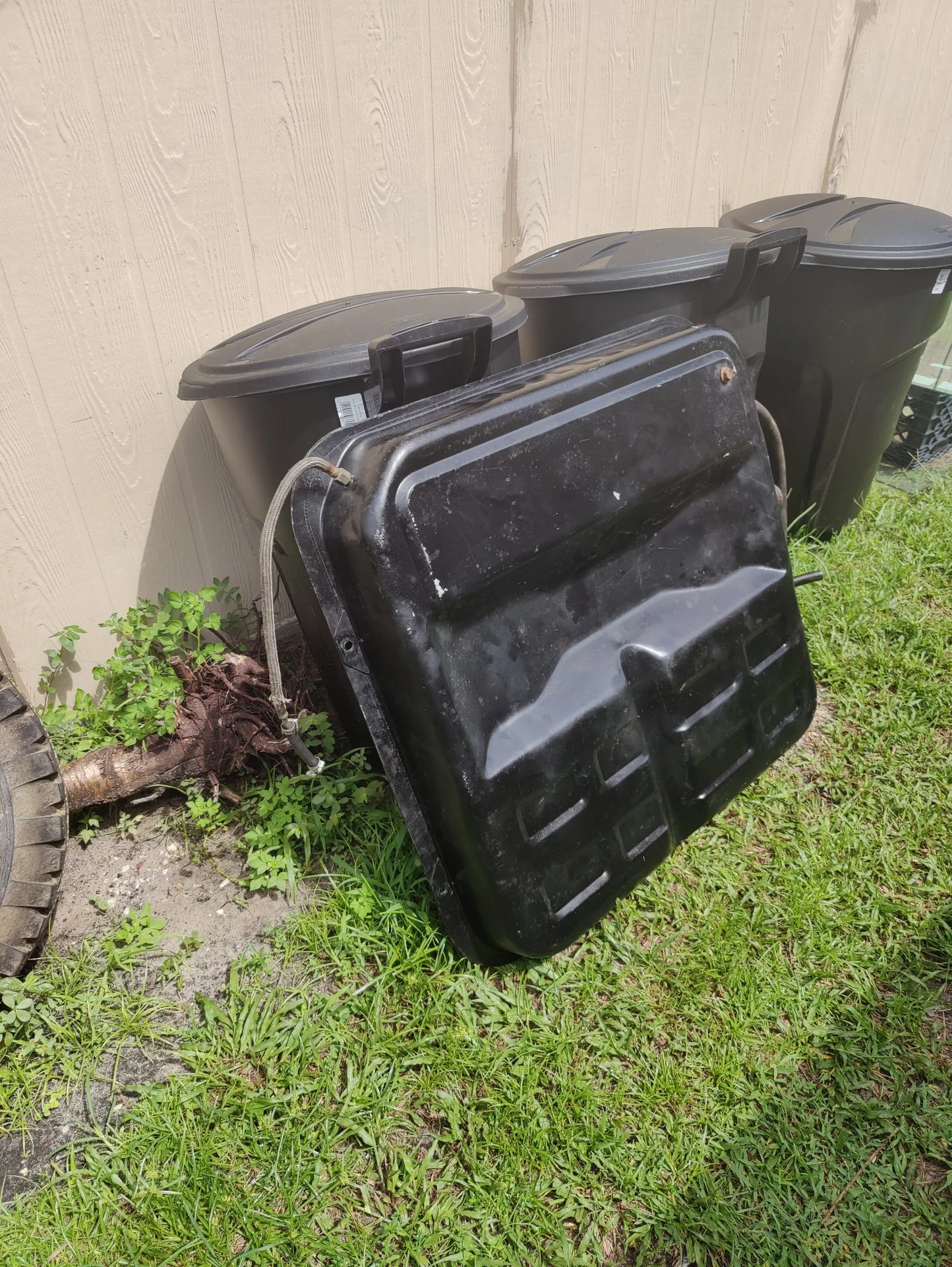

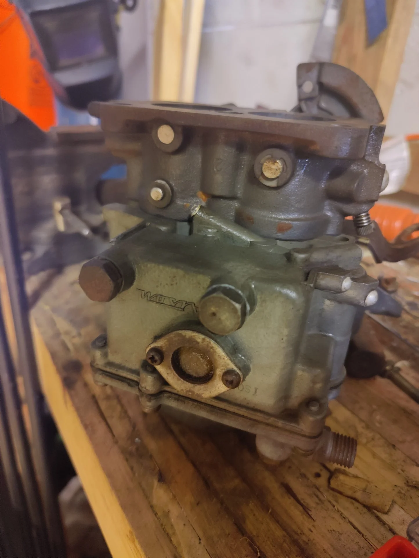

On a whim, I checked out the carb (sniper is already ordered) just for a bit of tinkering. The PO couldn't figure out why the truck wouldn't idle. I figured that out. The carb was all gunked up. The hard line from pump to carb had sand in it. The line out of the tank was clogged with gunk and rust. It's all apart and cleaned and the tank is on its second chem soak. Altogether the tank isn't too bad - just old.
