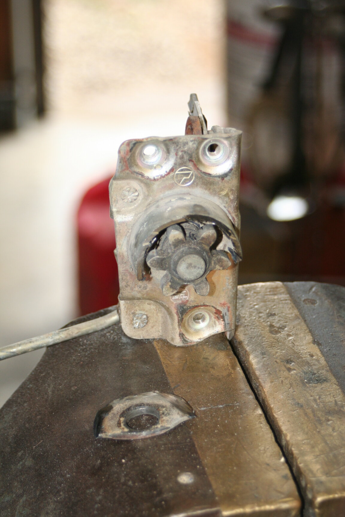

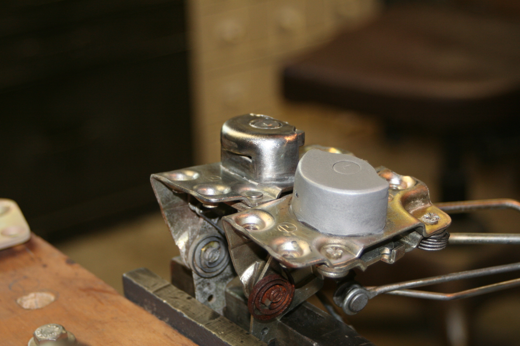

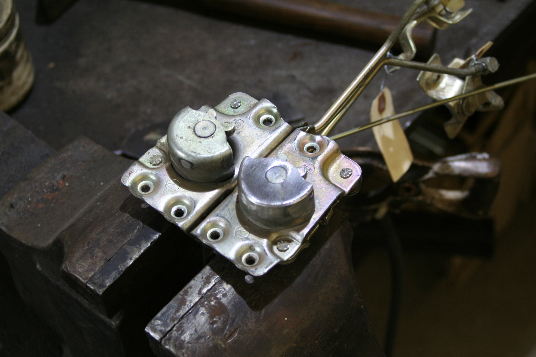

Yes, the star wheel wears a slopy hole in the housing (for lack of better terms) and binds up. I cut the housing off and weld in a new piece to hold the wheel tight.
P.S....I was not the one who came up with this fix, can't remember, but I stole the idea.
There are two different types (years)?, also.
Oh yeah I studied the heck out of this post beforehand. Didn't feel like re-doing the housing so just bought one. It's good.
