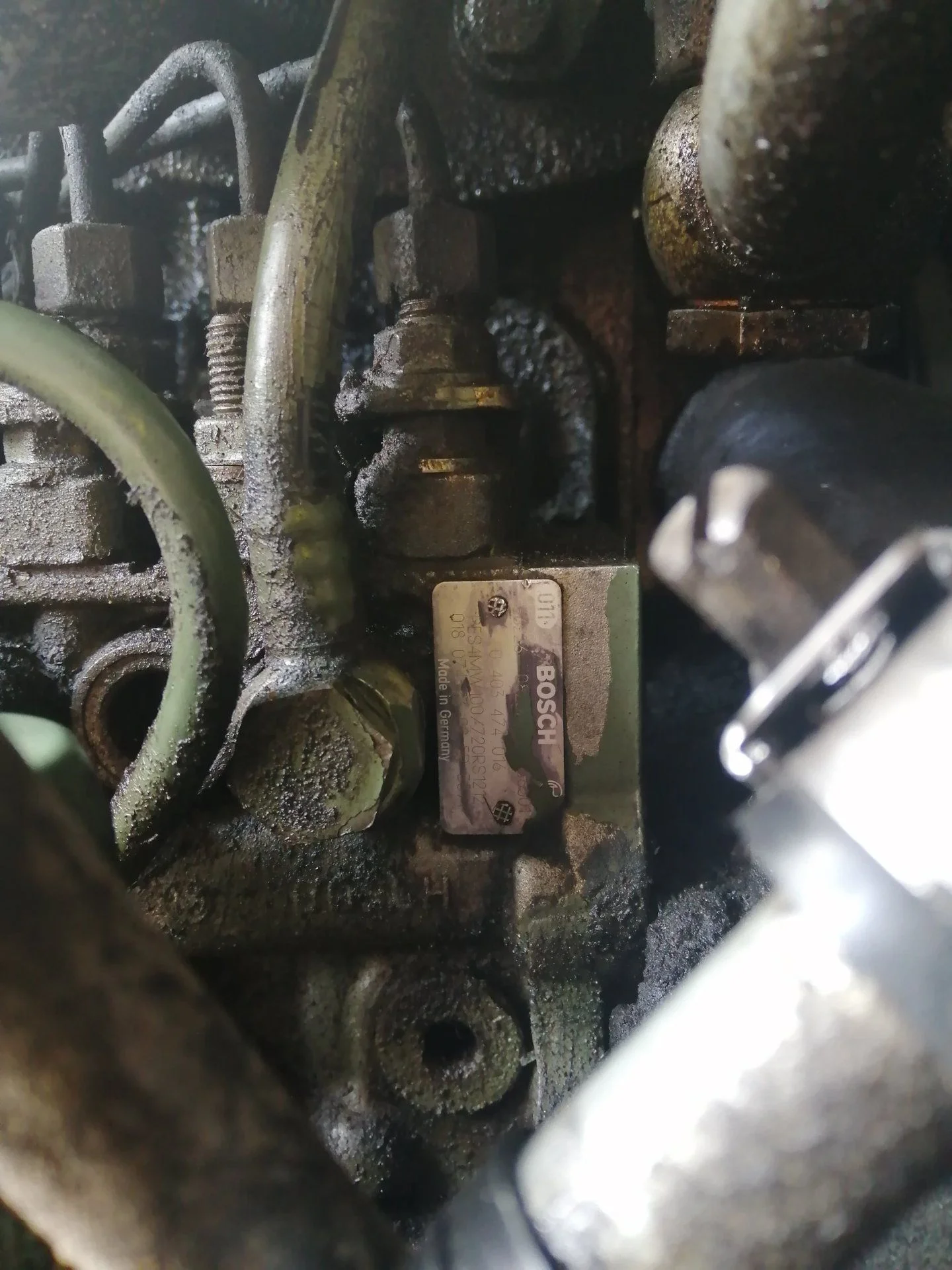

Anyone have any experience of giving these pumps a tickle?
Not had chance to mess yet, looking for a heads up.
MW pump... Should be 10mm elements. I thought MWs couldn't go anywhere near that big, hence why the mercedes guys like to swap to the M pump...

what do you mean by "couldnt go anywhere near that big"?
it on a OM 364 LA.

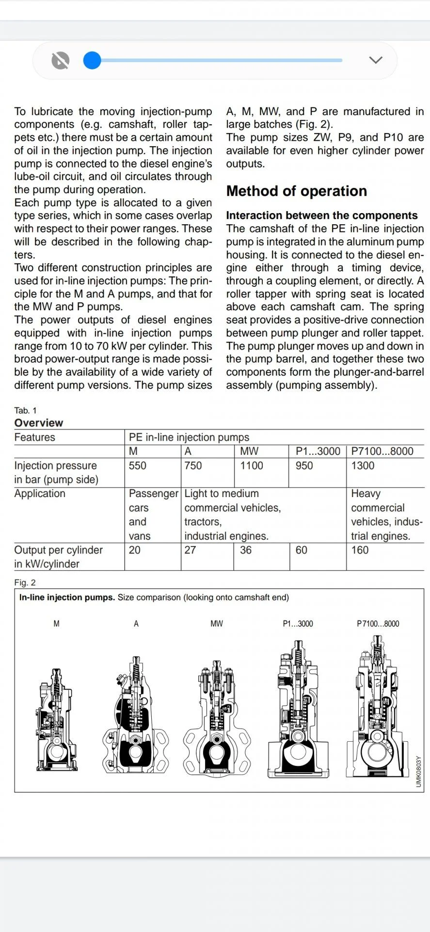

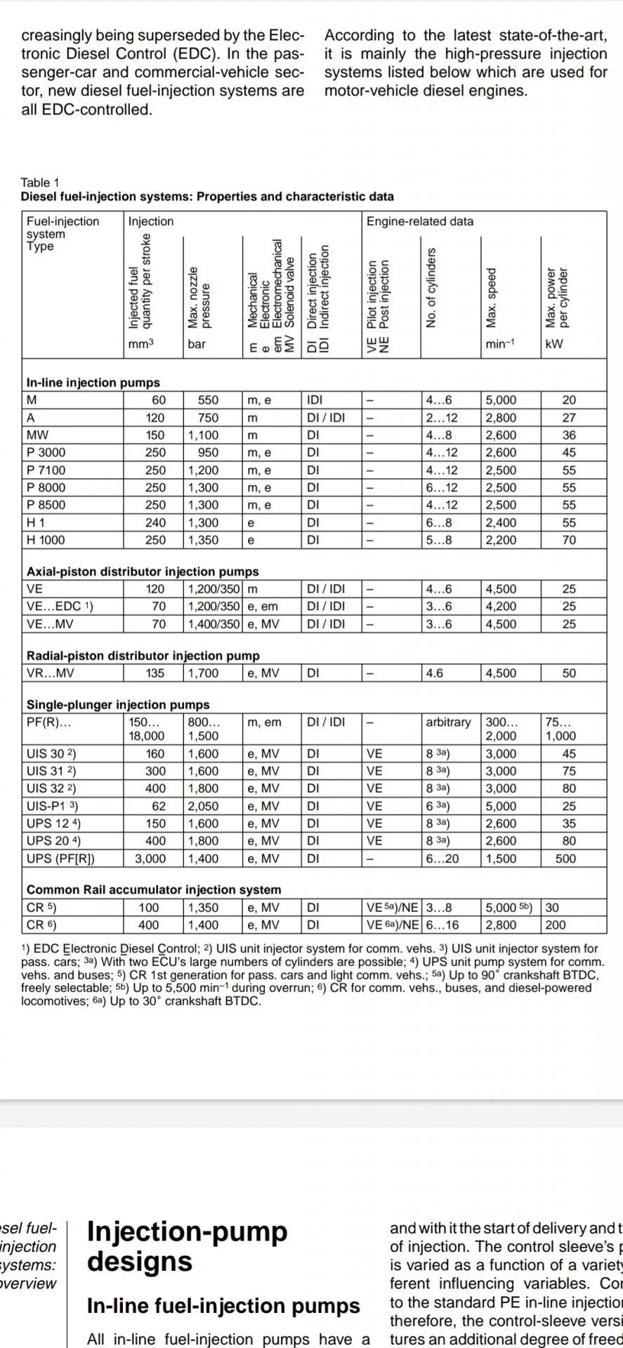

The different inline pumps are intended for different fueling levels. So there is a physical limit to how big the elements can be in each type of pump.
However I was wrong, the MW pump is a bigger/higher potential pump than the A pump. I'd read about the merc car guys swapping from MW to M and just assumed the MW was a small pump. In reality I guess they do that because there is an active community upgrading and tuning M pumps, but probably very little info on MW.
