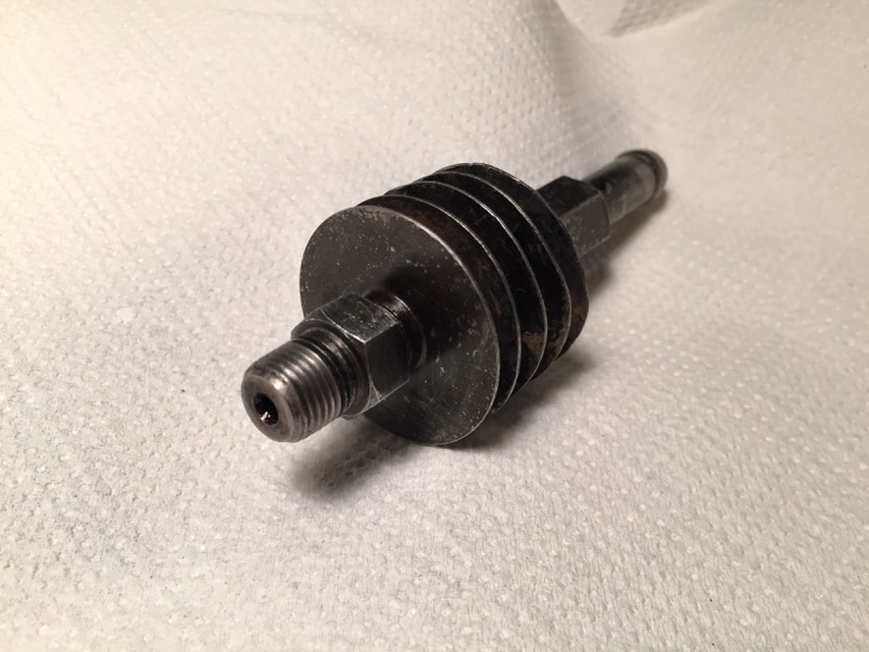

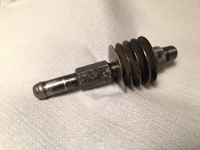

The union fitting (Toyota's name for it) is the union between the intake manifold and the vacuum hose to the booster. Here's a pic...
I'm assuming this part doesn't really do anything special except dissipate heat before connecting to the rubber hose. I'll put some anti-sieze on it, tighten it back down into the manifold, and check it in a few weeks to see if it loosened itself up.

Wow.. Never seen one of those before. Nice!
If the female thread is metal too, and there's risk of it coming loose, then blue loctite would probably be a good idea IMO. (It'll both "stop it from loosening" and "seal the thread".)
(Often using Loctite is preferable to "adding more torque" when you want to stop something from coming loose.)
