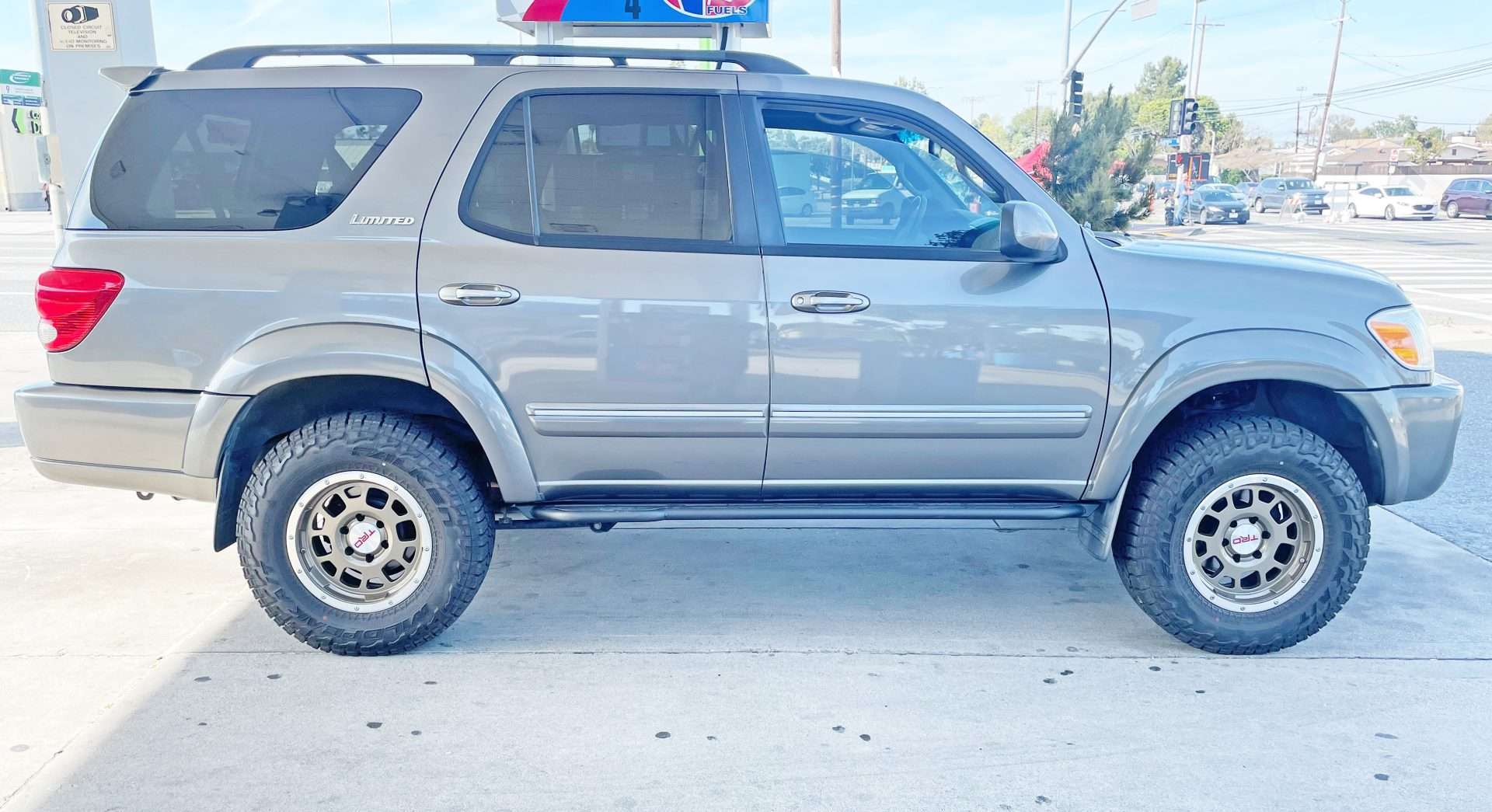

Bolt on rock sliders for 1st gen Sequoias
Bolts to factory step locations. Photos only show static load, not dynamic so its quite dangerous imo.
There's a reason the industry uses weld to frame sliders.

I watched the video and and agree that they are mounting to the stock factory step mounting holes. Not nearly as strong as mounting to the frame. Fine for everyday use just like the factory step, but I wouldn't feel comfortable using them on trails. I've nailed my frame-welded sliders many times and I have complete confidence in them. Not only can they easily support the full weight of the truck, but I can drop down hard onto them without fear of them bending or failing. I'd be concerned with the above sliders taking a hard hit. Would it bend the cab that it mounts to?
