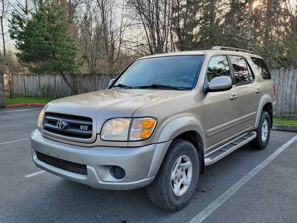

Hi again! So what advice does the group have on the perfect Sequoia for me? I am looking at a 2001 Sequoia with 239,000 miles which would normally be a deal breaker. Its going to be a overlanding toy and the household's 4th vehicle so I don't think the high mileage is that big of a deal because the one I am looking at has a full dealer service history including a Toyota replacement transmission at 197,000 miles. Oh, and its so cool I could look that up on "My Toyota".
