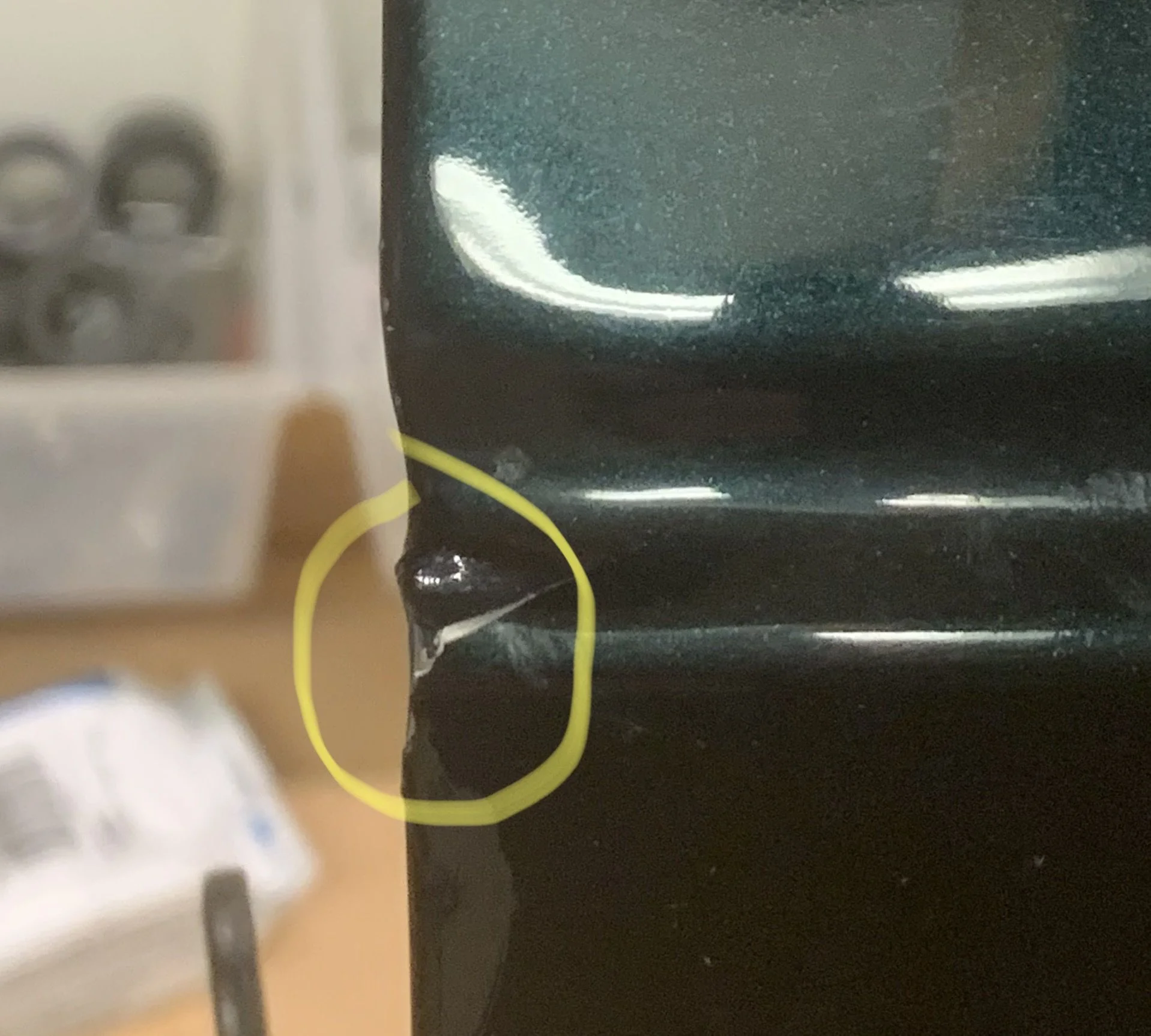

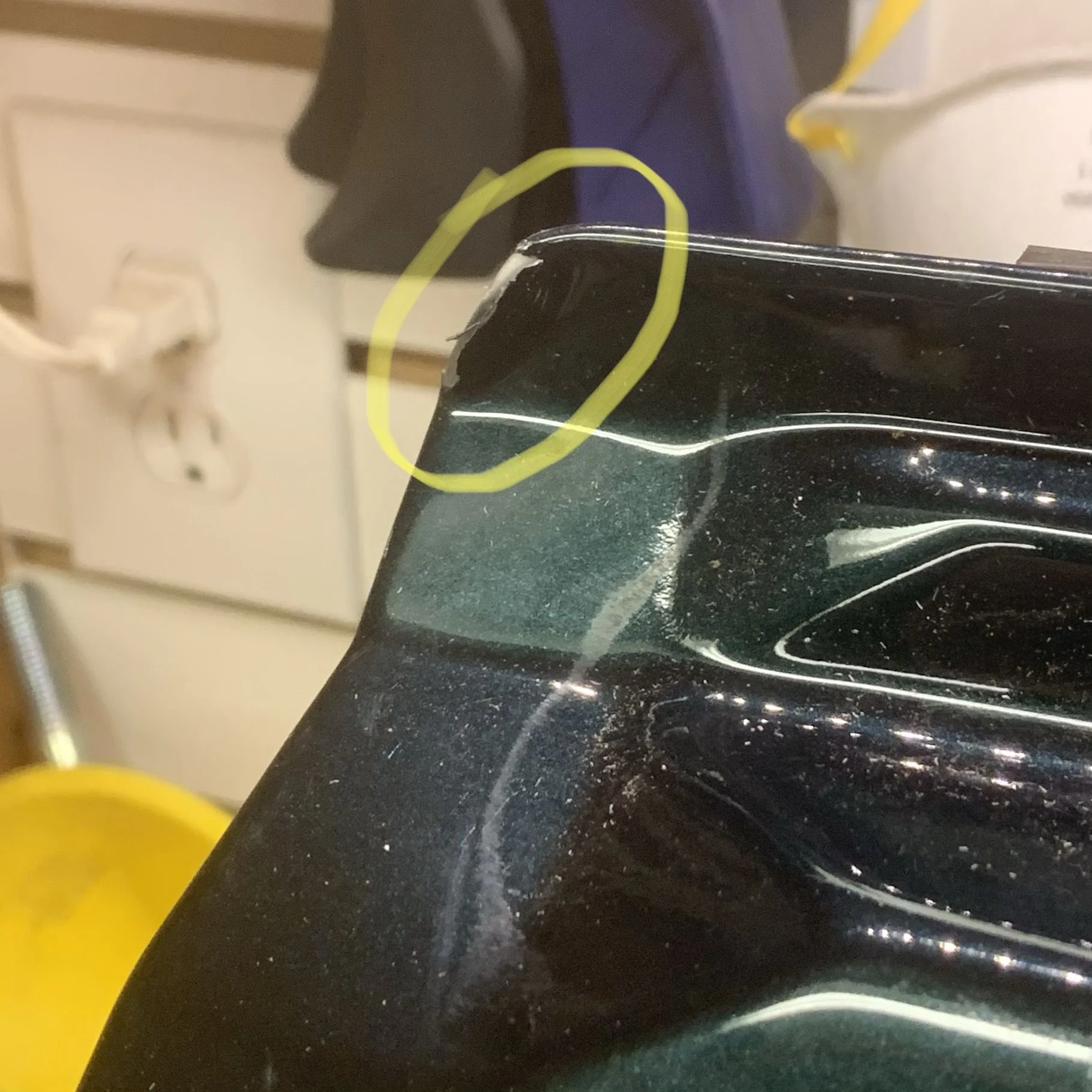

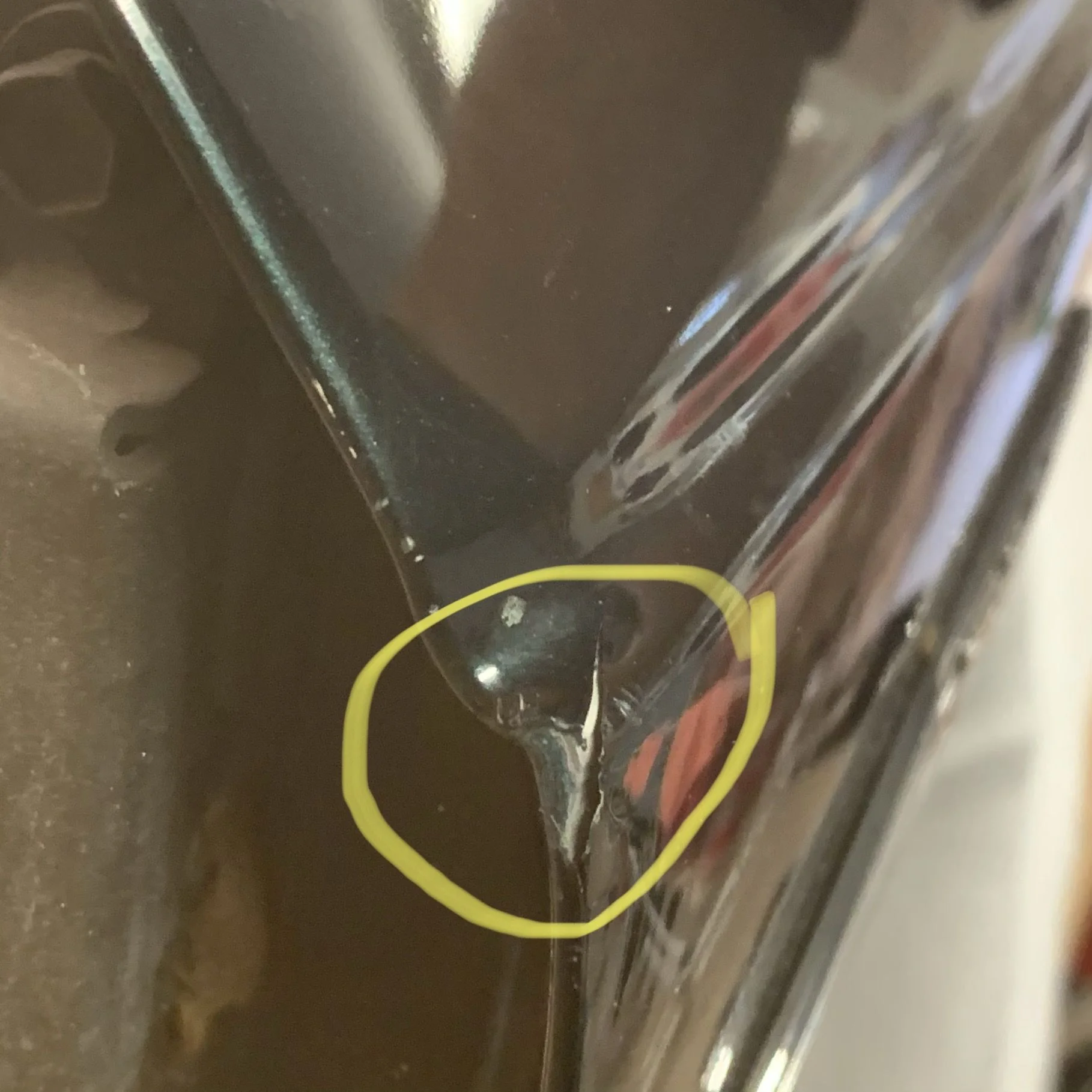

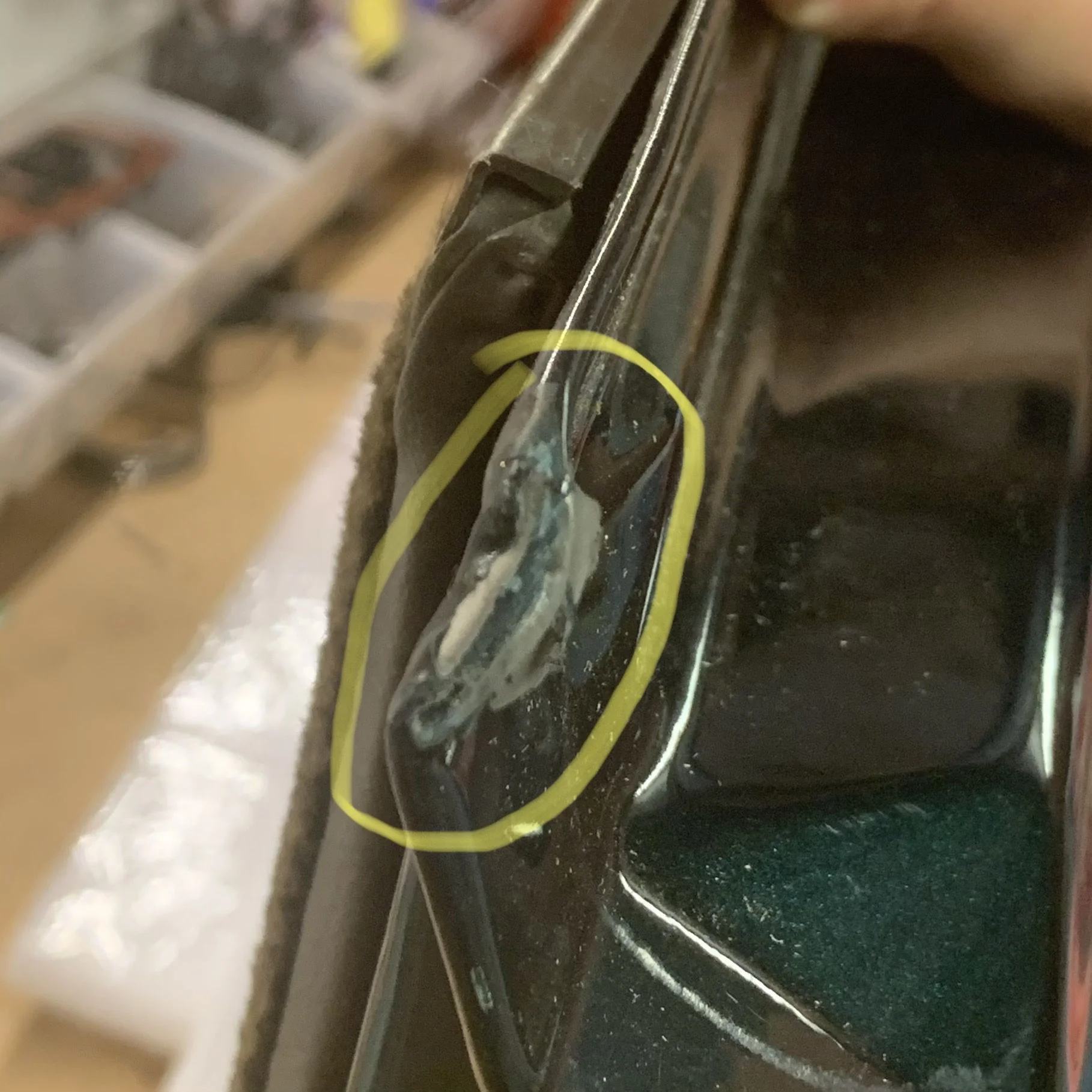

Just got this replacement tailgate and it looks like it was lightly dropped on its corner. How to I fix these dents?

The top corner is just slightly folded over, like an earmarked page in a book, This tool seems like it is for bigger dents?

That looks pretty easy to fix it's hard to tell if it's dented in? Go get an angle wire grinder and grind the paint off. Then get Hammer & Buck and just to flatten out the sheetmetal. I don't think it requires much work. And then top it off with some body filler to blend with the sheetmetal
Thanks haryv
I ended up doing just this and using a hammer and dolly. worked great.
