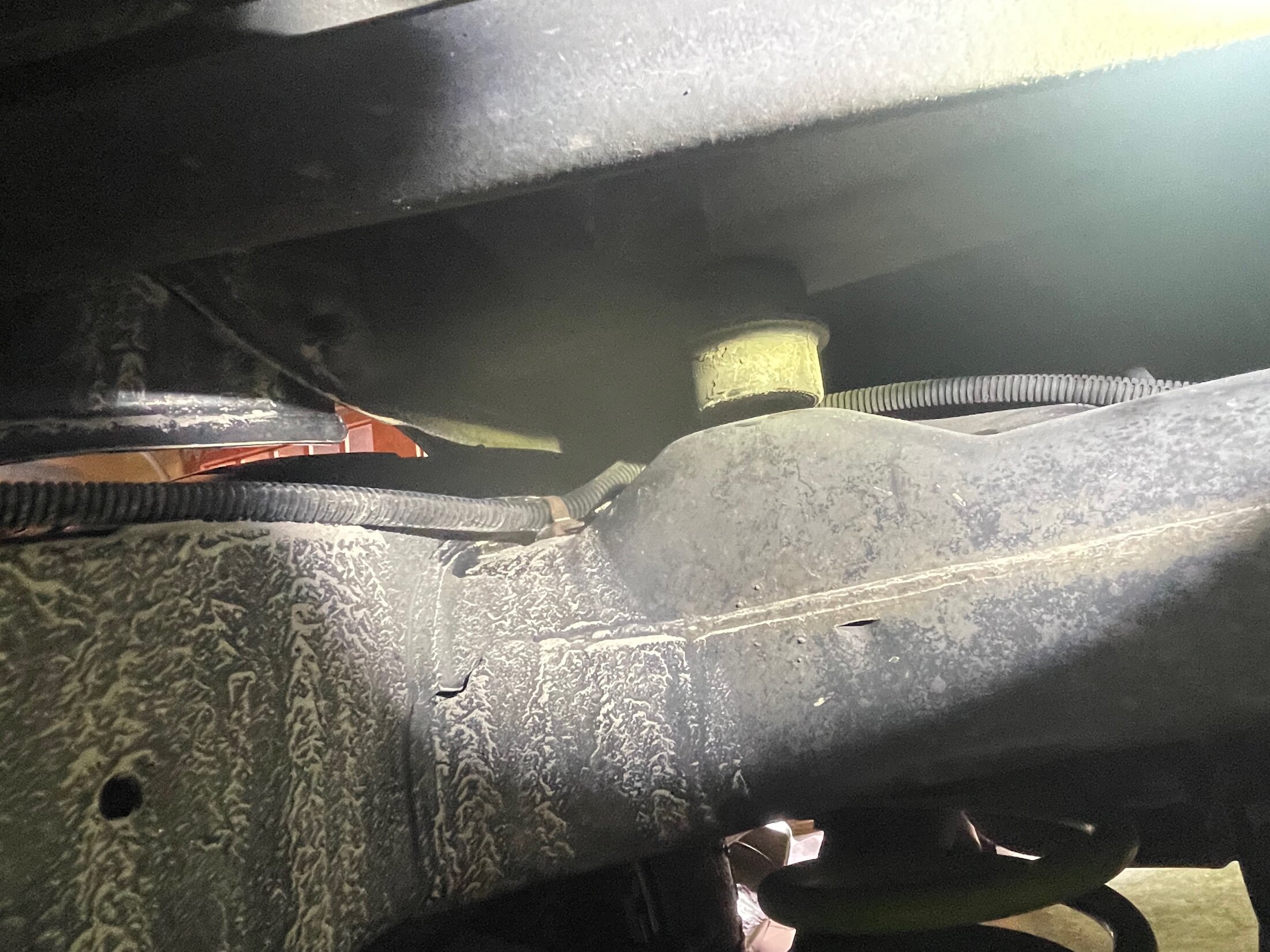

The truck is lifted and has the panhard relocation bracket and extended sway bar links. On flat ground, the panhard bar is not quite perfectly horizontal. See photo.

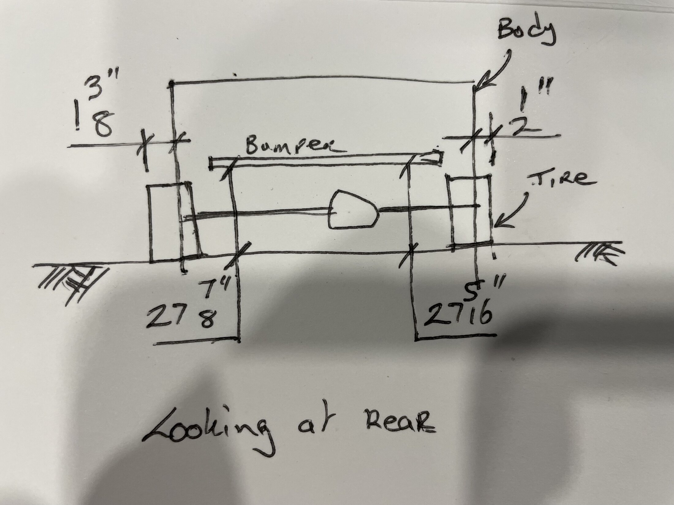

The rear driver-side tire projects 7/8" more from the body than the passenger side.
I measured the rear axle at either end on flat ground and it was equal, yet measurements to the rear bumper indicated the right side is lower on the driver's side by 9/16".
See the sketch below for some measurements.

I also noticed that the right rear lower control arm bushing was shot and the others look cracked.
Any advice on what the best course of action would be to get rid of the pull to the right and rear tires sitting equal to the body would be appreciated.
I might be making things up here - but aren't there typically specific left/right springs for the rear to account for the weight of a fuel tank? Is it possible these were swapped during install of the lift?
Again, not an expert by any means here, just throwing out a thought.
