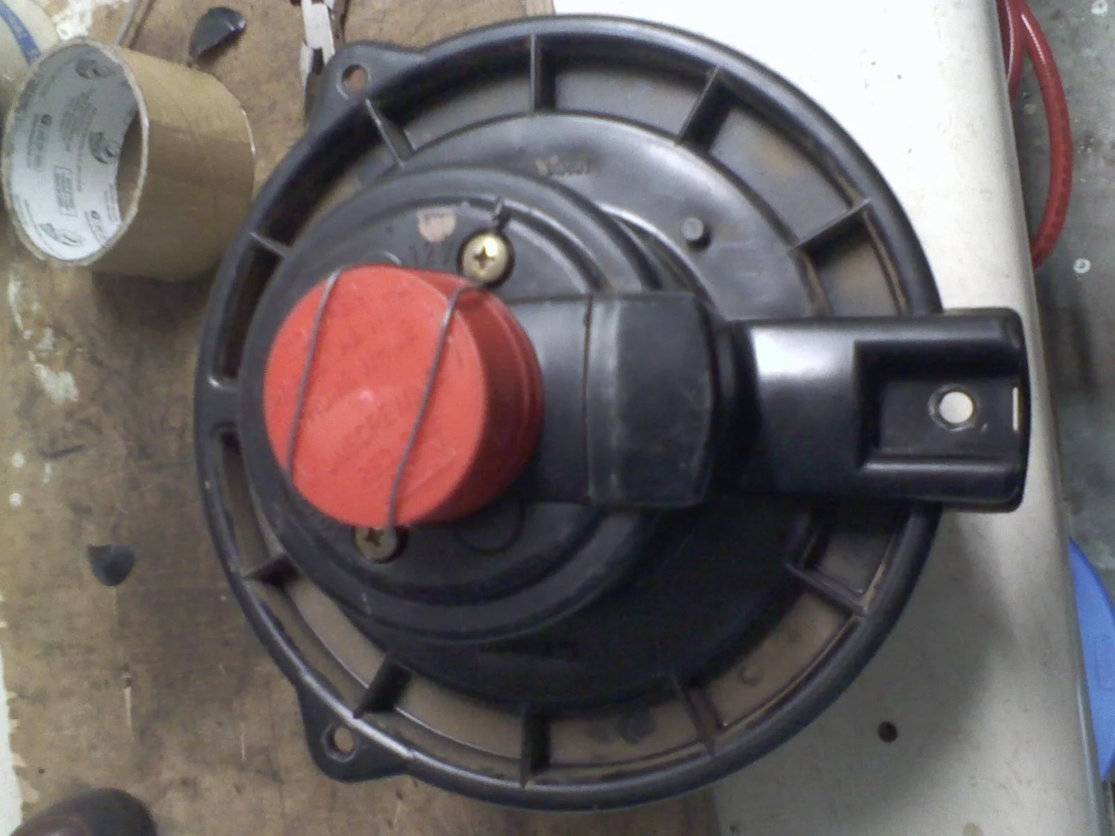

Fan wheel is just about impossible to get off. If you want to explore the insides, remove the L-shaped plastic cover by prying off, then the two screws. Next pry the motor/fan out, it's just a friction fit inside the plastic housing. It's difficult. I disassembled & lubed mine twice, it didn't help the squeaking. Ended up replacing with OEM.
Remove the clamp shown by the arrow.
The metal shaft "armature" (in the middle of the clamp) should come off from the blower plastic fan blades (first Pic). Sometimes it could be fused too tight. I was in a hurry (most of the time) so I hold the plastic fan blade unit and then asked a friend to hammer down the metal shaft. This caused the bottom of the shaft to come loose from the housing (Also broke the housing: Second picture).
So be gentle at removing the blower fan unit from the armature. Soaking with WD40 or PB blaster is a good at this state.
I found my own remedies to fix the problem I caused but I enjoy quite blower now.

Don't lube from the squirrel cage side, lube from the other side, where the little nub sticks out on the motor housing, just a small drill bil in the center of that nub, go slow, you'll know when you're through the steel.
Then lube, turn the fan, lube some more, then place duct tape over the hole to keep the lube in.
Should only take you 5-10min from the time you start drilling to done.
