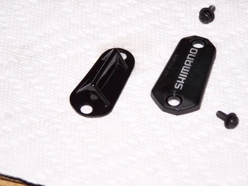

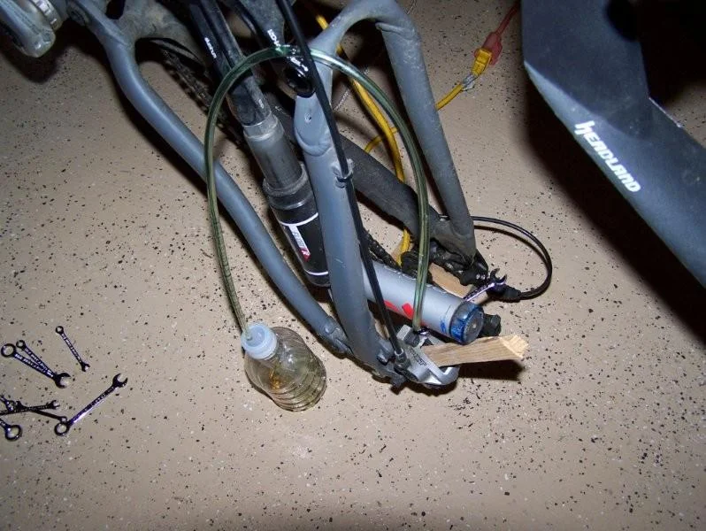

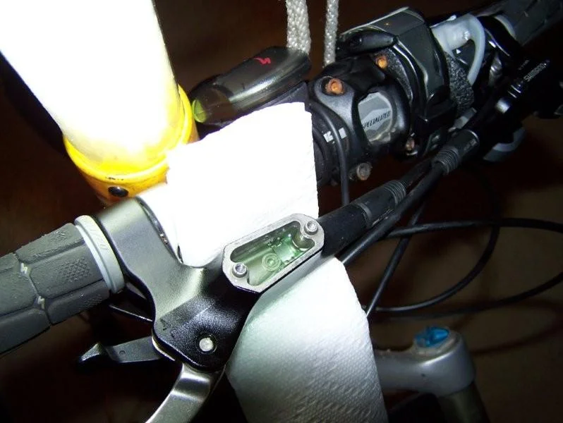

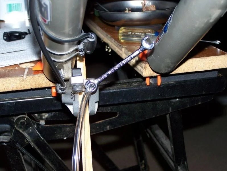

Ok, that worked, no surprises. It was no problem doing it solo, I could comfortably reach the brake lever and rear bleed screw. When I opened the bleed screw, the brake lever went almost immediately to the limit, it would've been difficult to coordinate that between two people. I pumped a lot of fluid through the rear caliper, one tiny bit at a time, refilling the reservoir every five pumps of the lever. The piston in the reservoir didn't always return fully to give a complete stroke, but seemed to improve with fresh fluid.
The brakes seem better in a quick ride on the driveway, the rear brake lever doesn't need as much travel.
The bladders that sit on top were expanded quite a bit when I took them out, which indicates some fluid loss since new. I haven't noticed any fluid loss, but this bike gets pretty messy sometimes. It's a year and a half old, but has ridden daily through two Michigan winters.

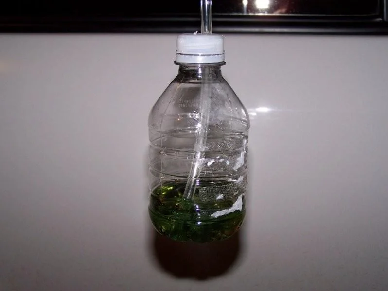

It was a little messy pouring a liter can into the small reservoir, I kept plenty of paper towels under the reservoir to catch the spills. Mineral oil is pretty forgiving, glad it wasn't brake fluid. The clear hose stayed tight on the bleed screw, no spills around the calipers. The other end of the hose is tight through a hole in the water bottle lid, so it stays put and doesn't spill even if it tips. I drilled a small vent hole in the lid as well.
