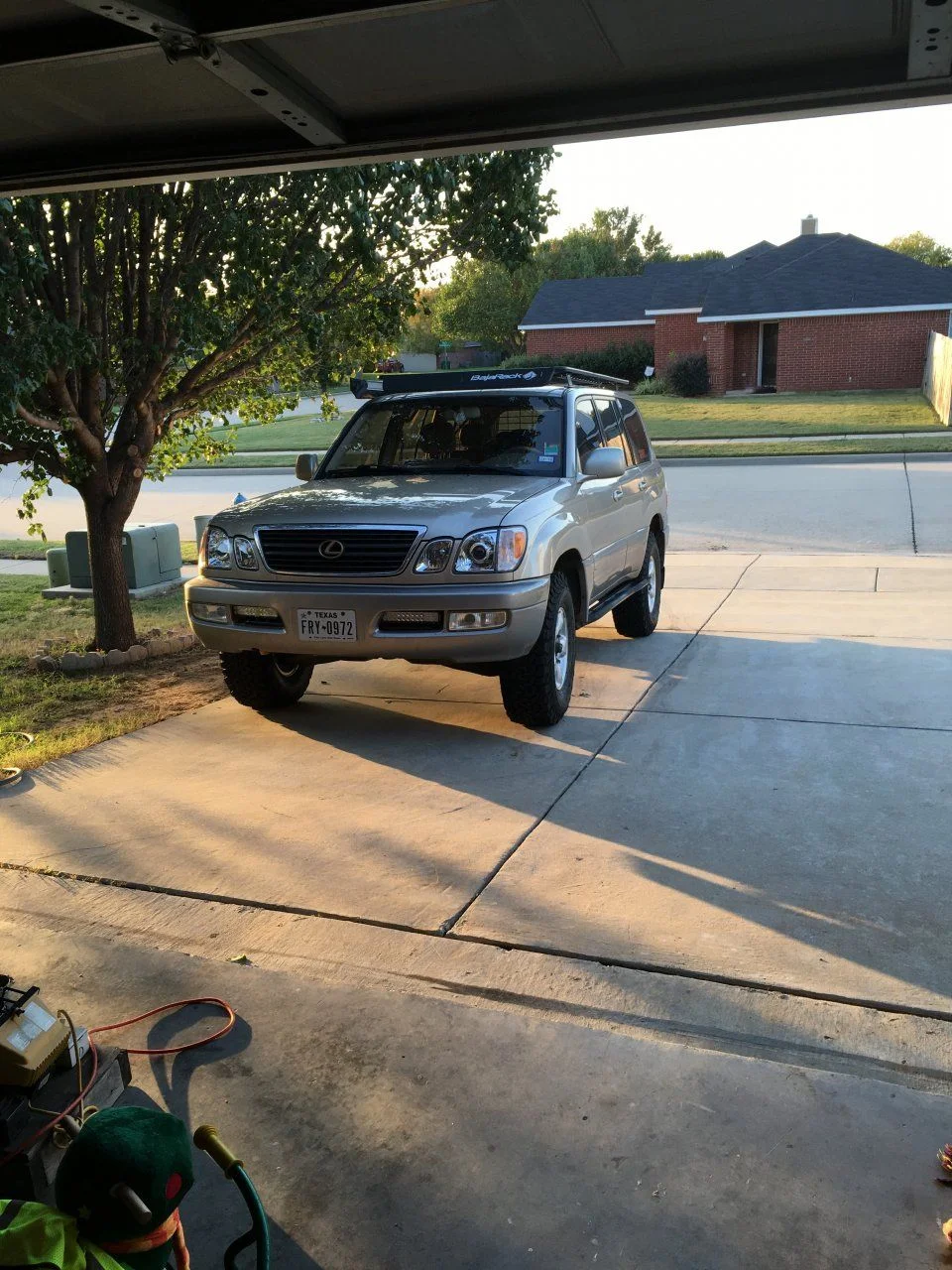

Hey y'all. I have been hanging around for long enough I figured it was time to post up my LX. I bought my LX to replace a Extra cab Tacoma that I had for years. My wife and I went all over the US in that truck with a rtt over the bed. We are teachers and love to travel during the summers.
So my lady decided it was time for kids and so we now have a monster that is about to turn two. My truck didn't accept a car seat and so she was sold . I found my LX at a BMW dealership as a trade in and we bought her the next day. Since then she has taken us on a few road trips and has been wheeled a few times. Currently she is my daily driver.

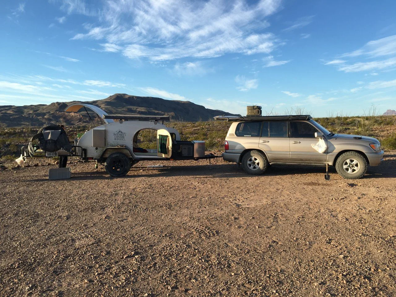

This past thanksgiving I rented a SoCal teardrop for our 5th wedding anniversary trip to Big Bend NP.
It towed really well and besides watching the fuel gauge drop you would have never know it was there. We drove every back country road they have, Black gap included with the trailer and it was great.
We LOVED the trailer, but not the price to own.

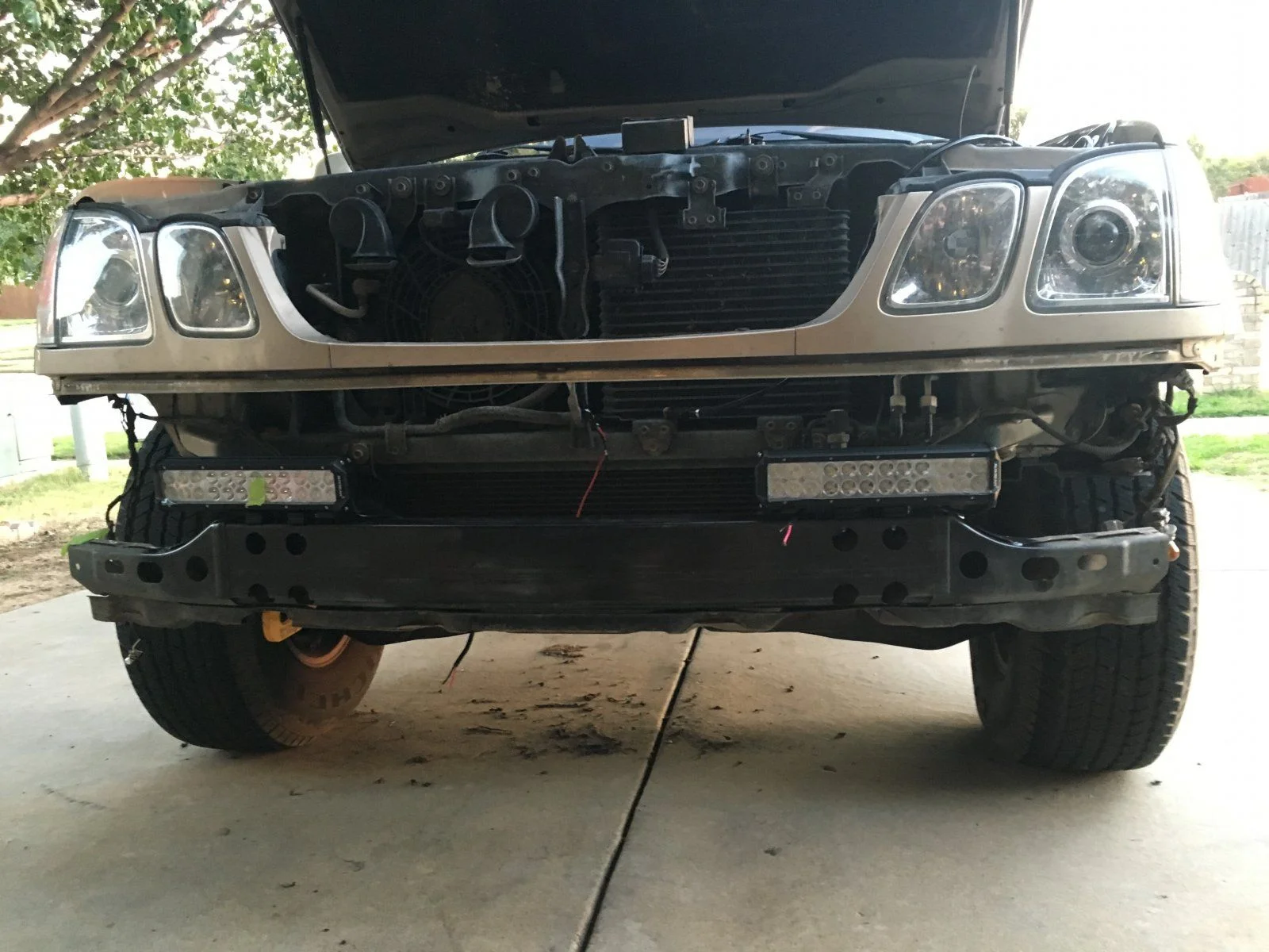

@beachbumin - SO I was looking for light output for dark country roads. I had some huge HIDs on my last truck, but I didn't have a good way to mount them. I have seen some dudes here with later models put a 20-30inch bar in a larger opening that mine doesn't have.
I started with Auxbeam cubes. They weren't worth the $25 they cost from amazon to me. So after talking to a buddy that works for Baja Design he told me I needed to use a 'real' brand and plunk down some real cash for quality lights. I didn't believe him.
So they are Auxbeam 12" combo bars. I bought the $12 wiring harness to try and make things easier for myself. It was a good buy.
If you want, I'll post some pictures with the bumper off, I had to drill 4 holes through the bumper support to mount them.

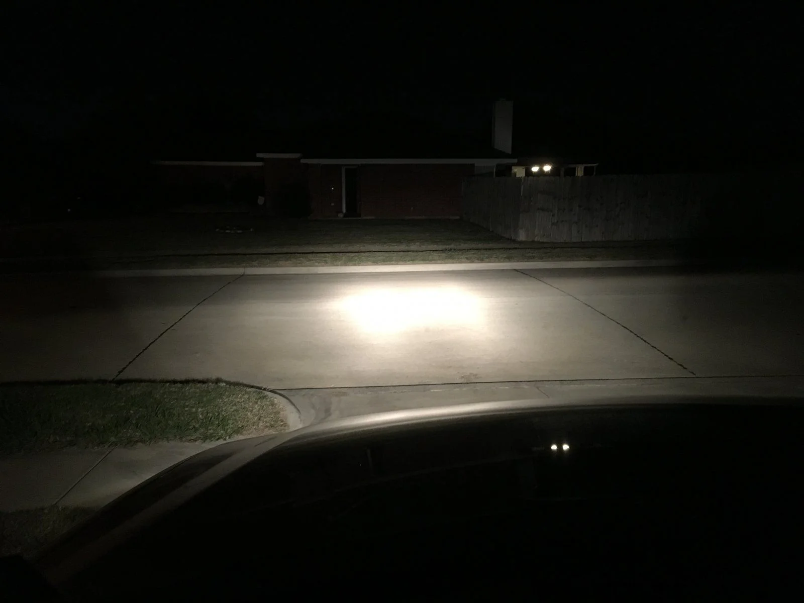

I used 12 inch Auxbeam combo led bars. I cut the trim out of the openings in the bumper and after fitting it a bunch of times I was ready to drill. Two holes per light, they were easy to drill, but the nuts were hard to get inside to thread on.
The Auxbeam lights mounts are under the light instead of on the ends. As a result the lights sit a little too high for my liking.
1st photo is without the light bars, 2nd with.
I would suggest buying higher quality bars for better light output.
