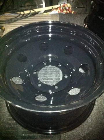

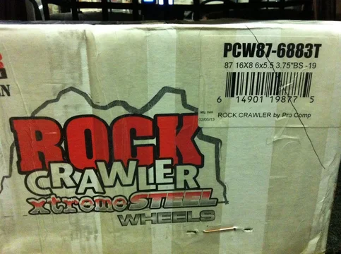

Personaly I dont like the "wagon wheel" look. I run almost the exact same thing in a modular design
http://www.4wheelparts.com/Wheels/S...x?t_c=11&t_s=209&t_pt=100021&t_pn=PCW87-6883T
The actual wheel has less cut outs then the pic shown in the link and the backspacing is 3.75" not 4"
