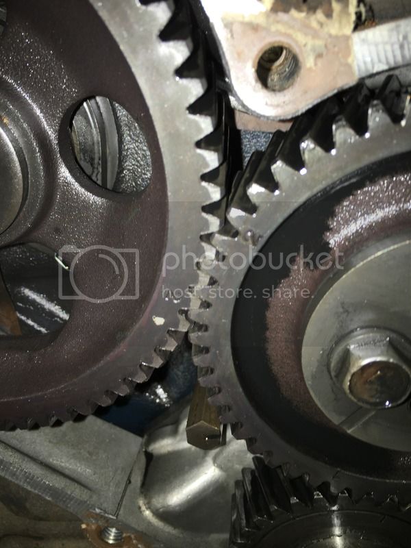

Blew head gasket, trashed 2 push rods and a lifter.

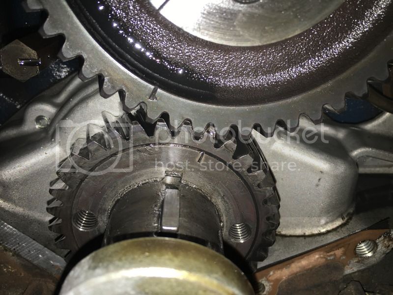

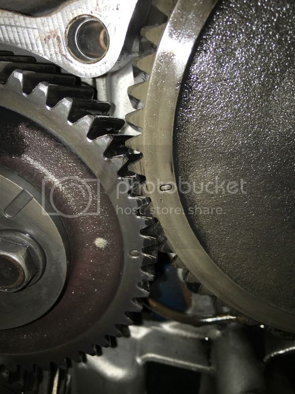

Now here is the question. I take the timing cover off to pull the cam, and because I am super anal and check everything to see if anything is jacked up. SO here is my confusion, I drove this damn thing into the garage.... how in the piss is this timing this screwed up? Or am I just reading the manual wrong.
some pics for you.

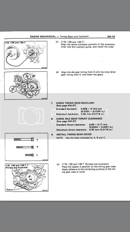

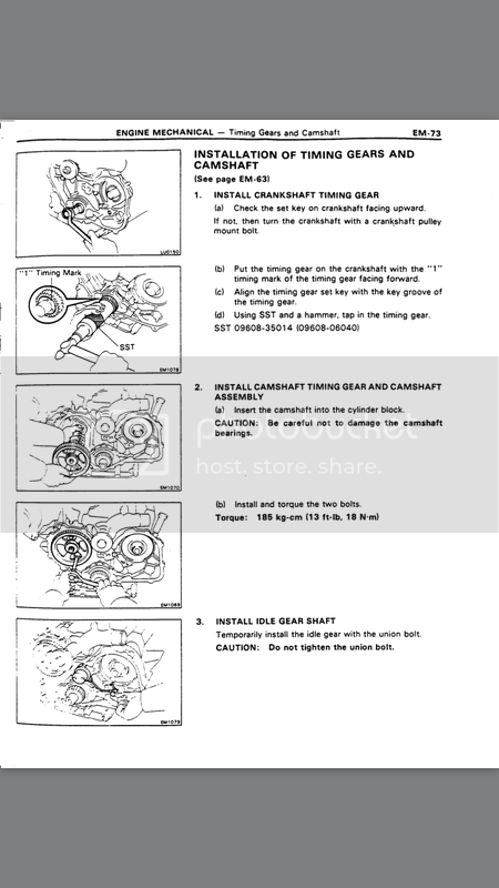

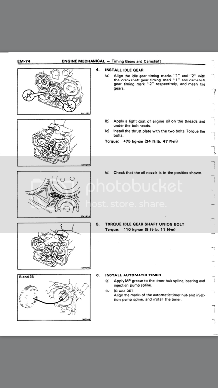

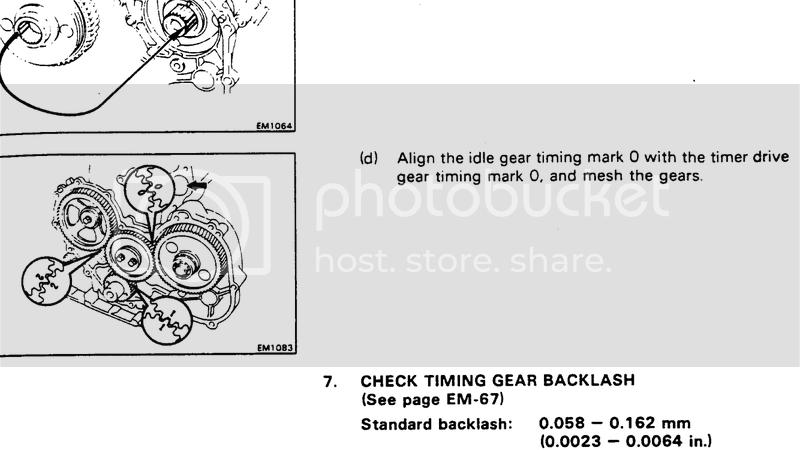

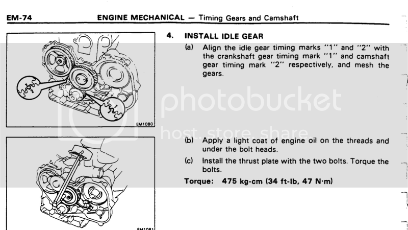

Here is the manual
Pretty simple right? turn s*** and line up the numbers seems pretty much idiot proof.. like seriously
now here is my confusion, was this s*** screwed up from the factory? am i on drugs and reading s*** wrong? or whats going on here
(for the record i may huff alot of jet fuel in my job; not by choice; but i don't do drugs)
Should I just time this s*** correctly? i mean i feel like i should because it would be right but how the piss was this girl running?
