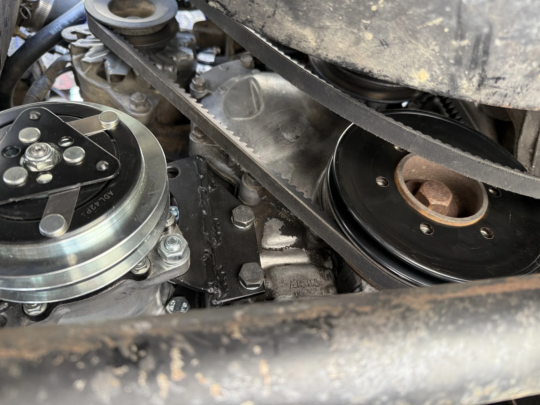

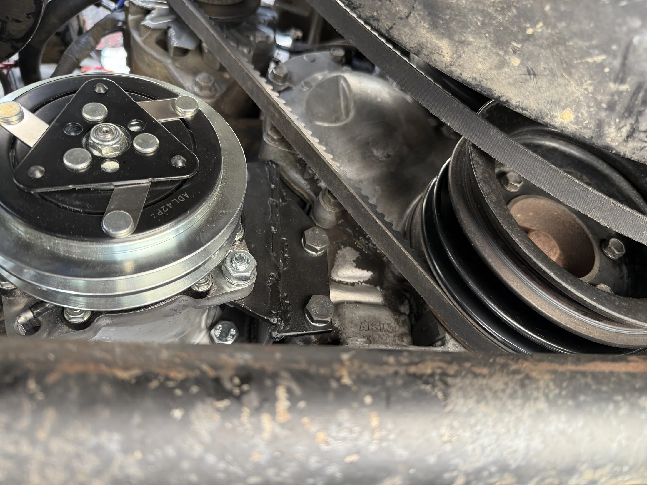

UPDATE! Problem solved. 14bt pulley bolts right up and it is in perfect alignment for belt!
The alignment is perfect.
With a leaky custom made soft top, my factory ac has to work pretty hard but it does the job.

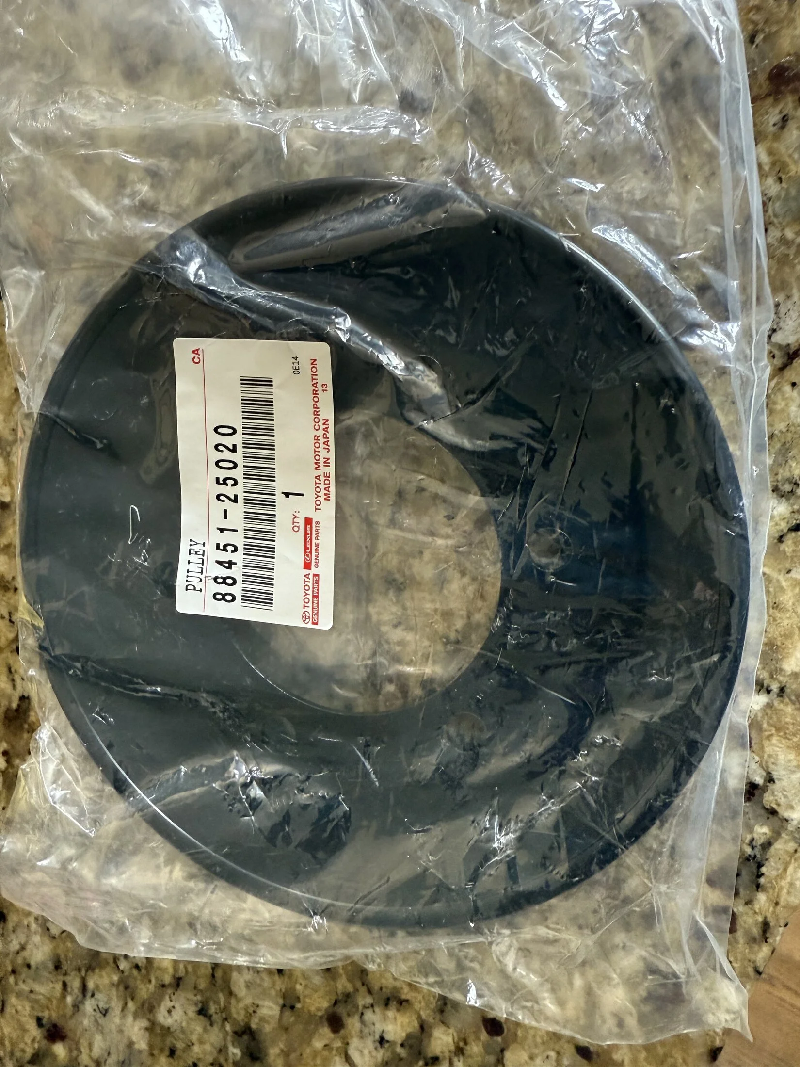

I don’t as I did not change it. I only added the AC pulley to the crank with the part number in the previous posts.
The part number for the bolt-on crankshaft power steering pulley for B Series Land Cruiser engines is 13477-60030. It is no longer available, so you'll need to look at second had options.
