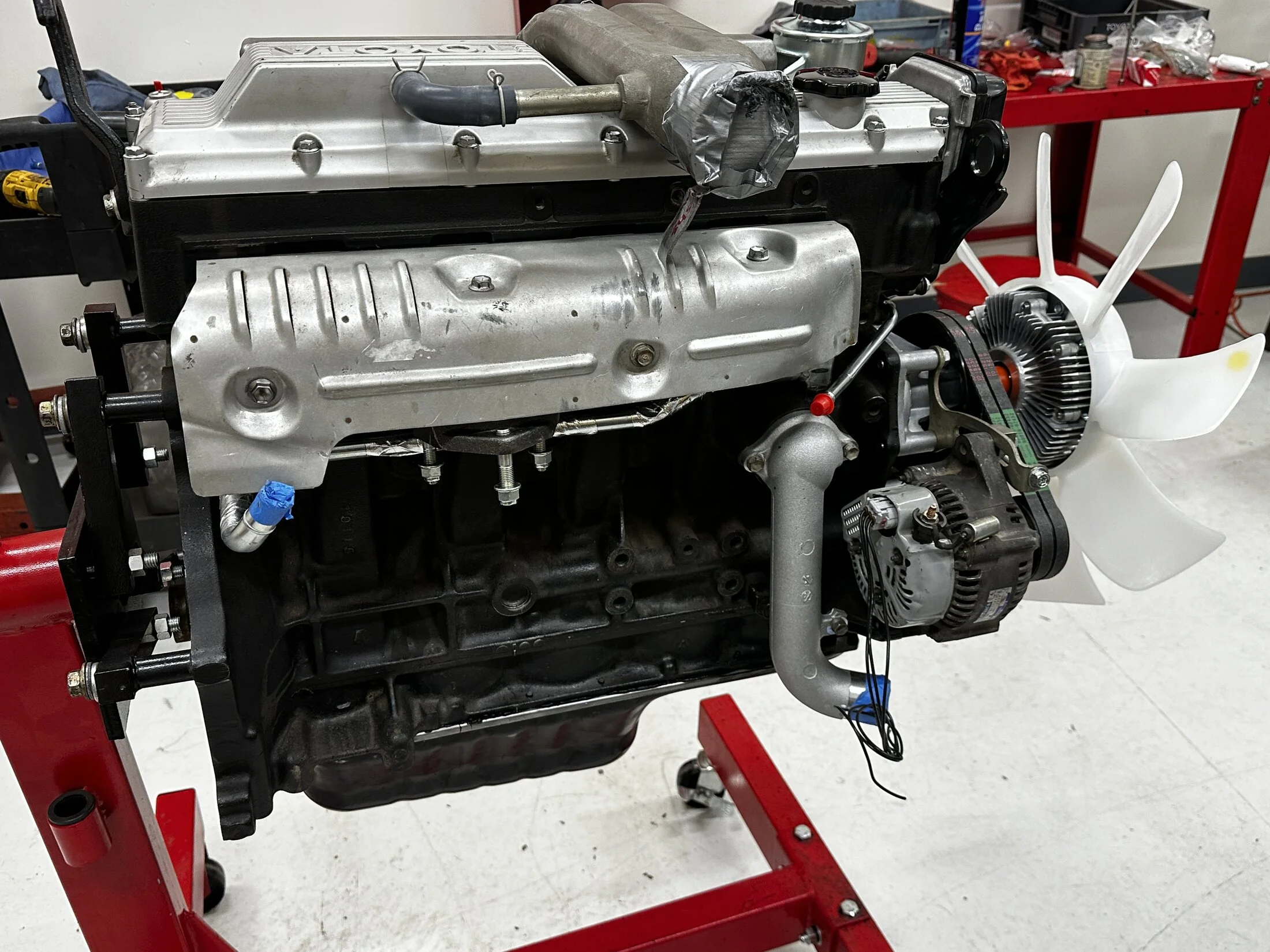

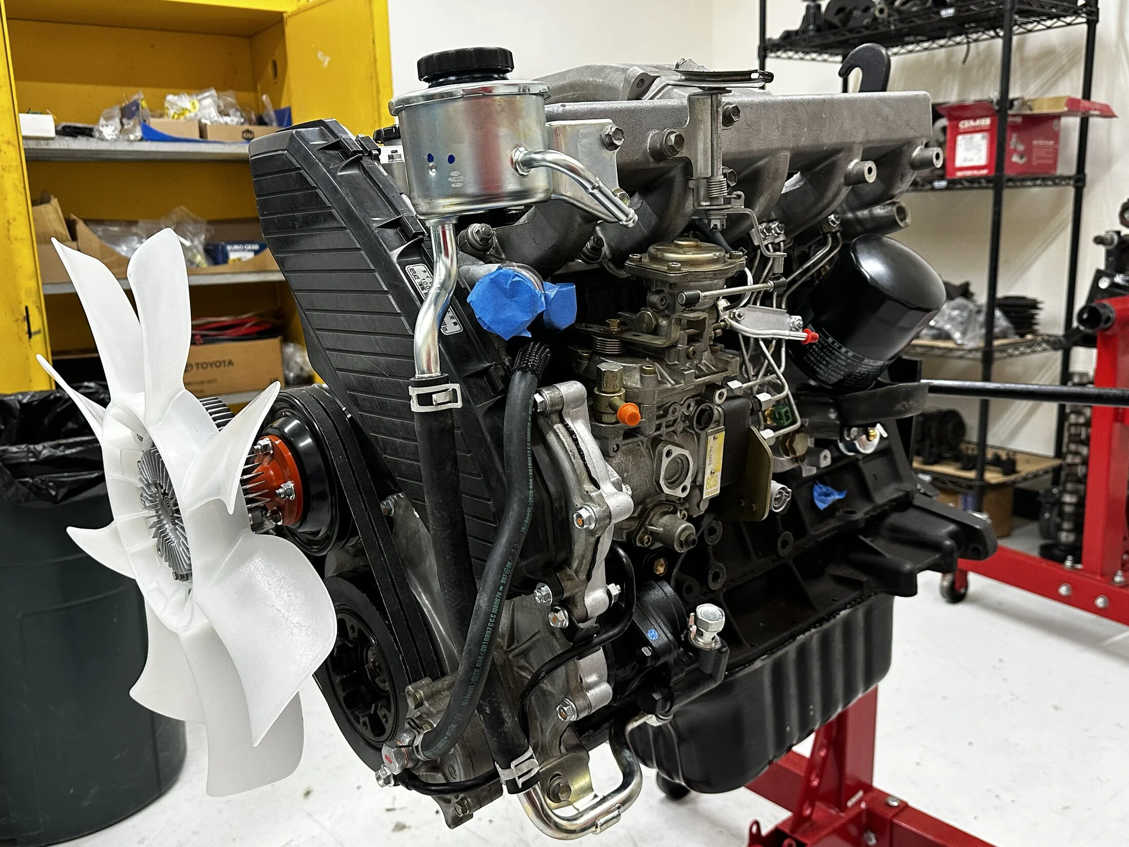

Quick update: been awhile and as the old adage goes, my interest in working on my own junk is literally zero after spending 40-50hrs per week working on other people’s junk. 😂😂
One of the negatives of having my engine around is that it often gets used for parts to fix customer trucks: “Vacuum pump is bad. Wait! Onur’s engine has a new one let’s get that…”
:rolleyes:

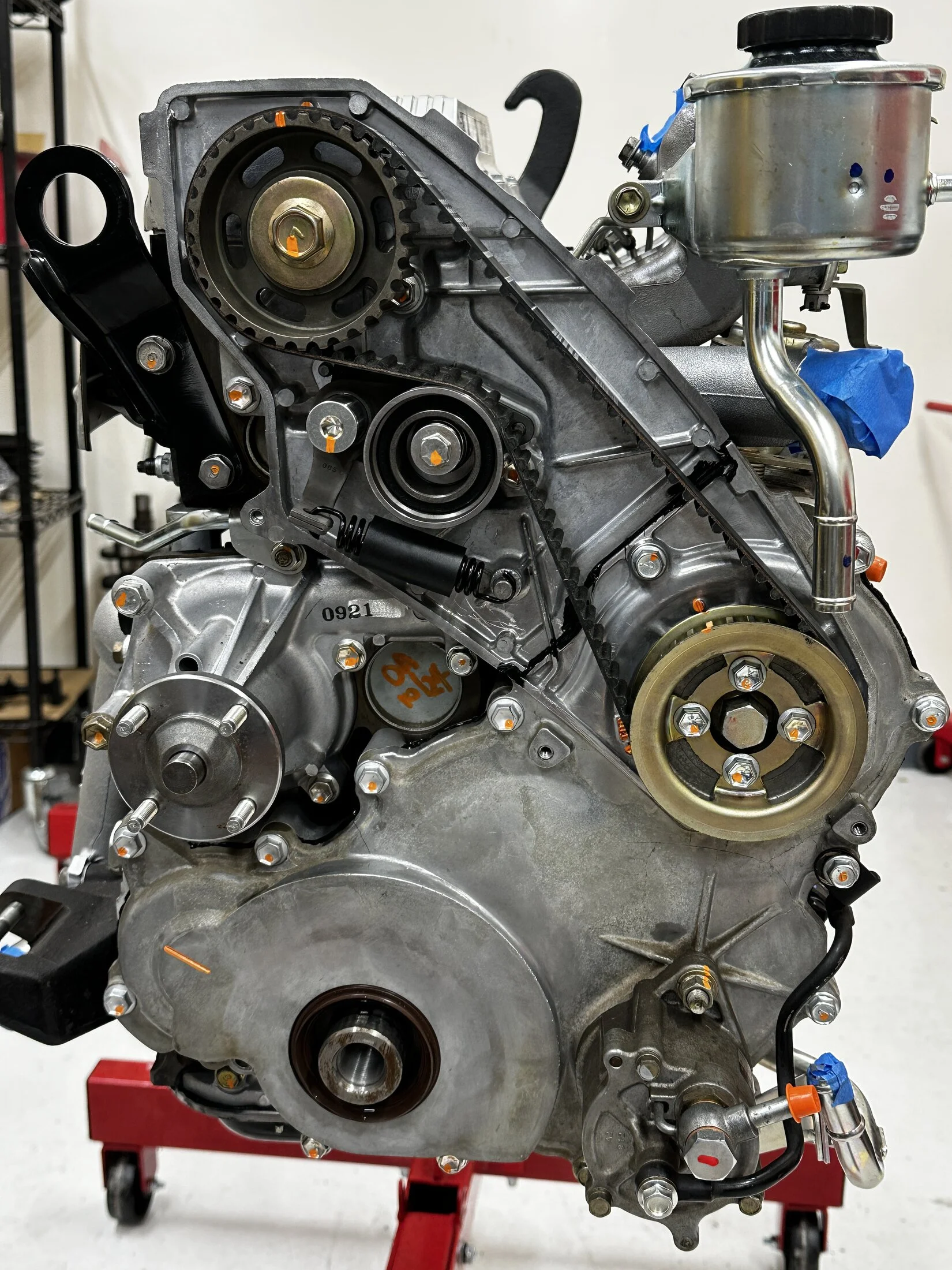

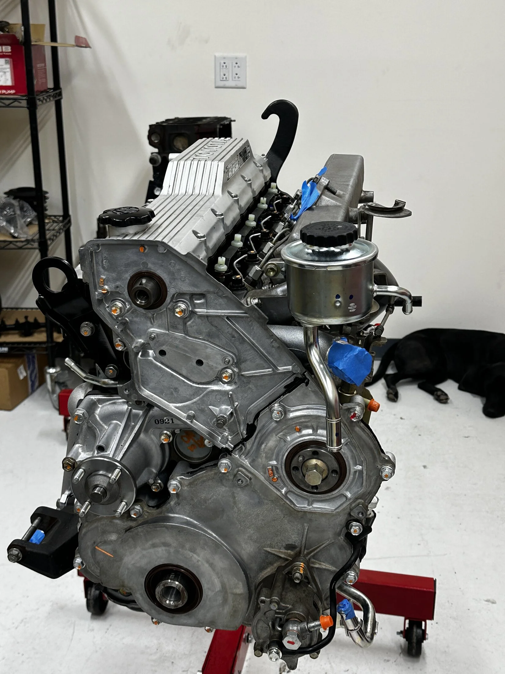

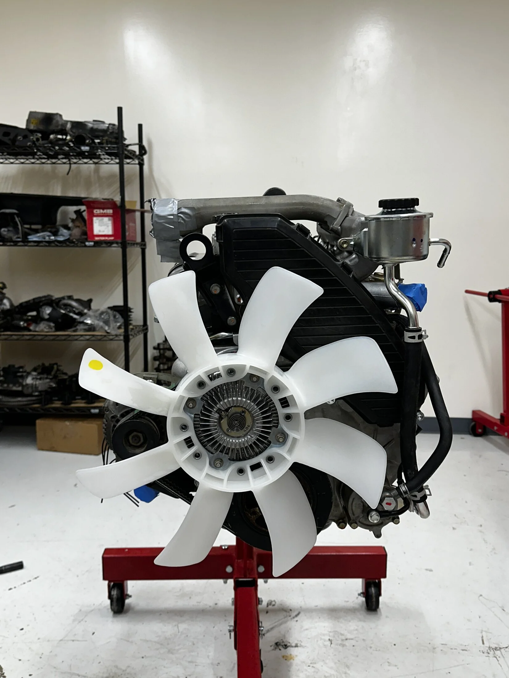

Anyway, new vacuum pump acquired and installled along with another “let’s use it from Onur’s engine”…. Power steering pump…
Also, for those with 1PZ/HZ/HD family iteration motors, the PS oil reservoir soft line is not available in the US. 1FZ soft line will work…part ID/OD are the same. 1FZ soft line is about 7mm longer…. Works perfectly.

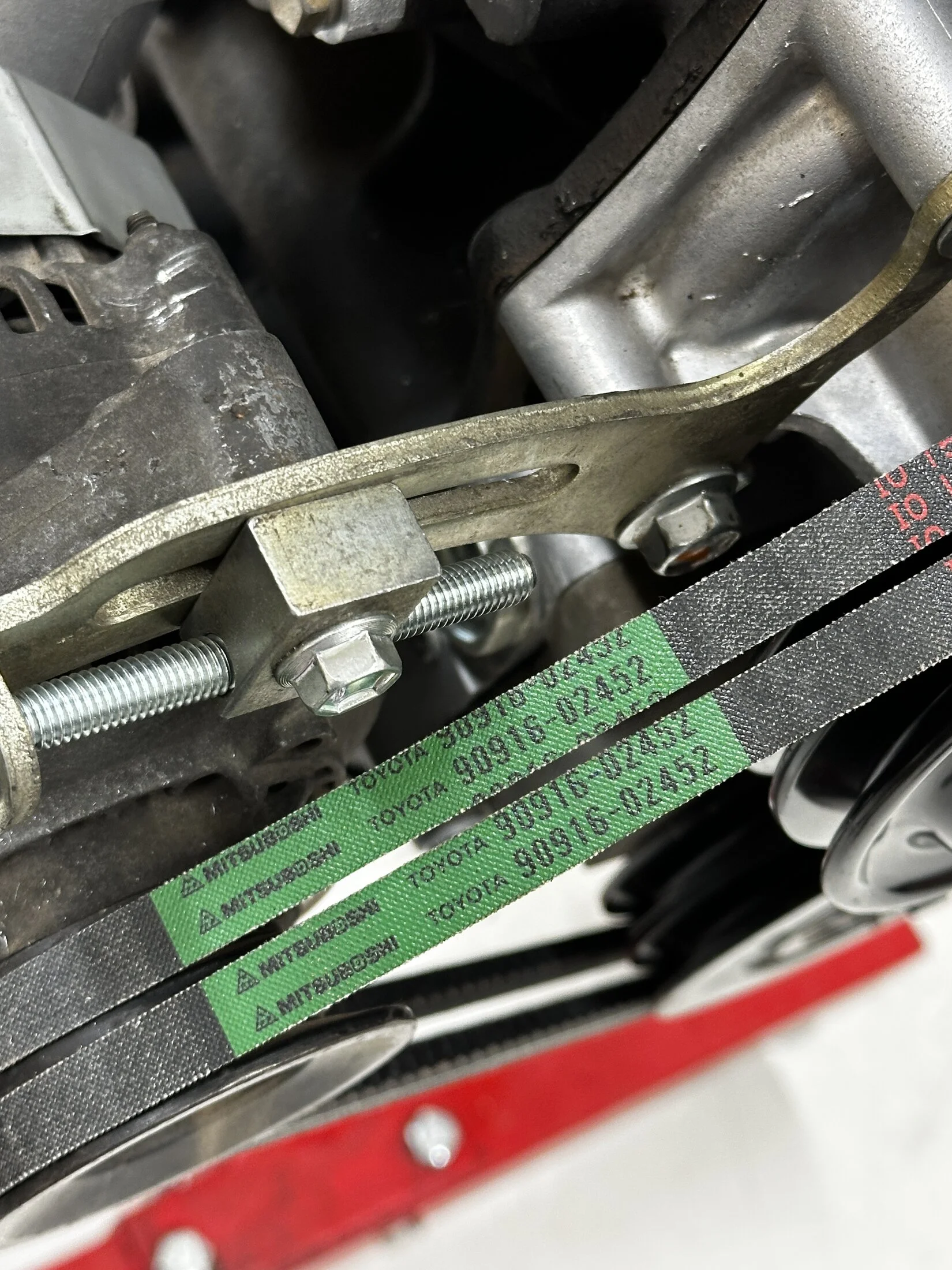

Will need to get exhaust sorted out, wire up the rear Eaton locker, PS cooler, a bunch of electrical (going from externally regulated ALT to an internally regulated ALT), and a list of other small things.

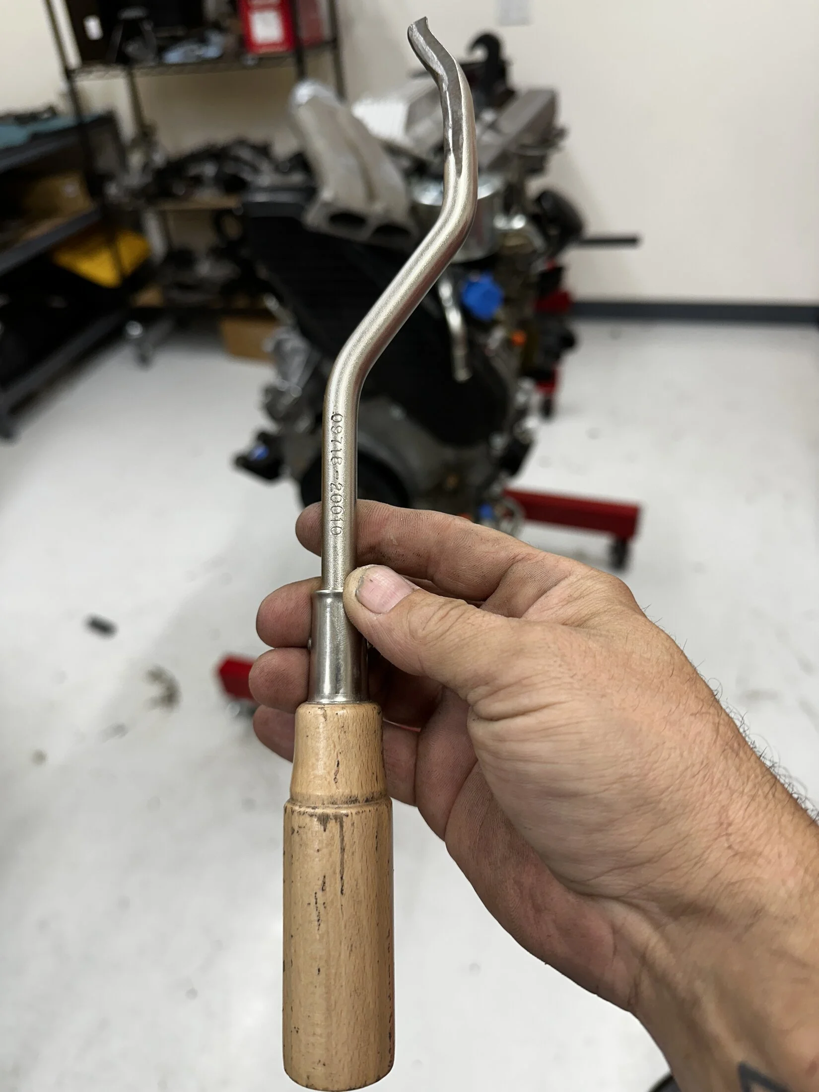

Little details matter:

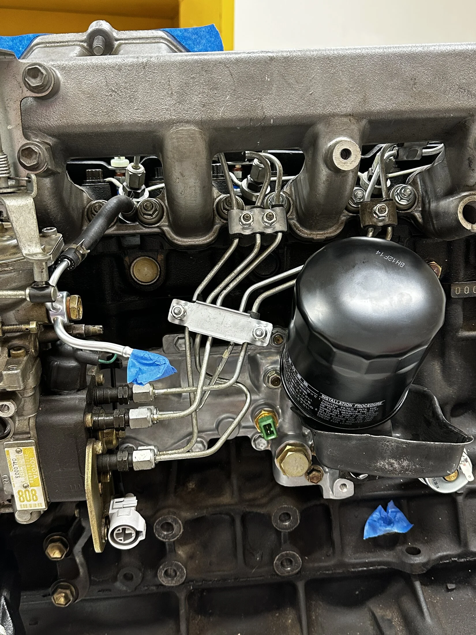

Fuel inlet pipe support bracket… some engines omit this bracket or it gets lost in a rebuild. It’s a nice vibration damper for the fuel line. Note: 90119-10630 is a coarse thread pitch on the end that goes into the IP…
I like ZDDP additive in these old engines.
And 10 quarts of good Toyota juice…

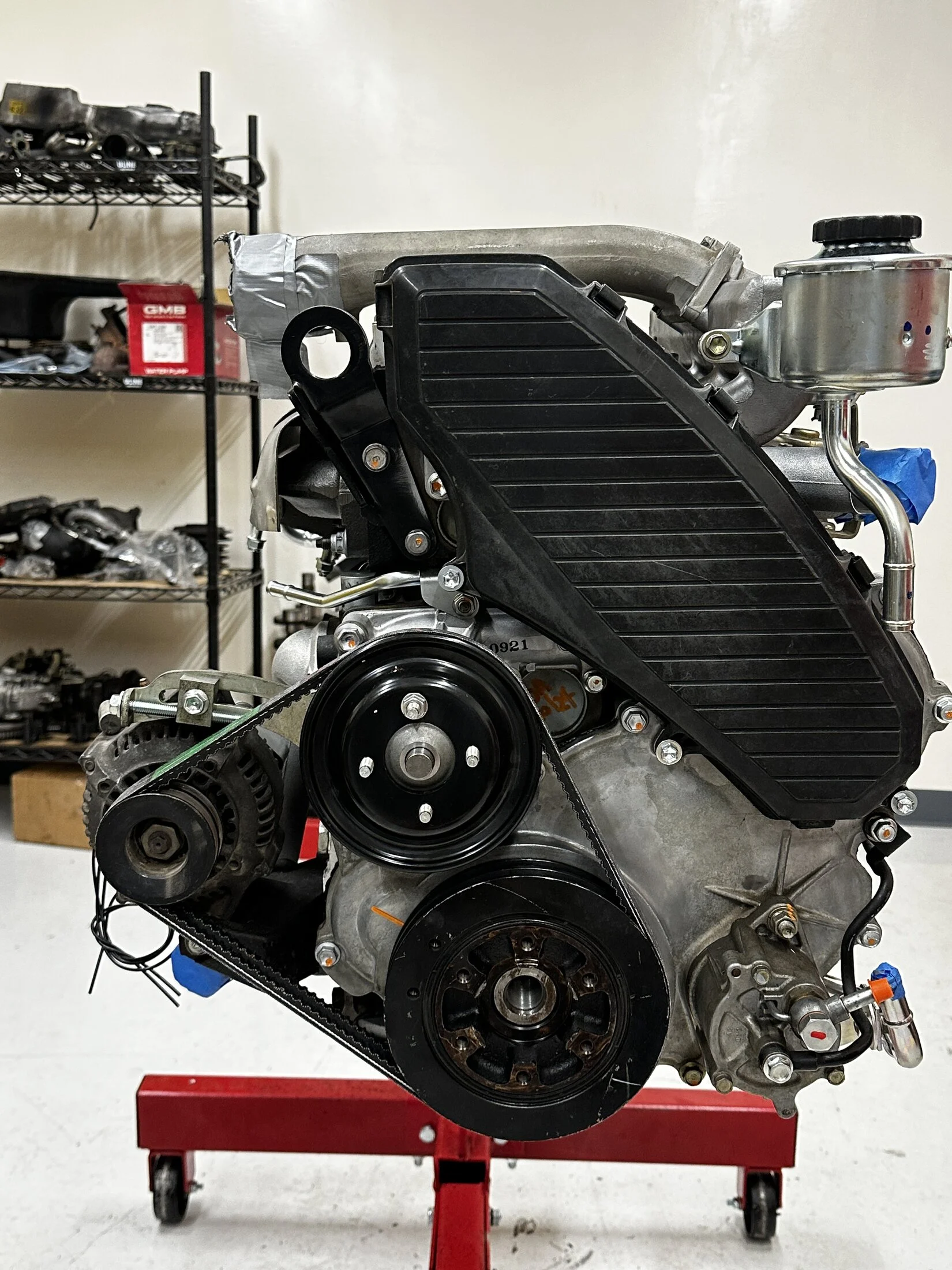

some more little details:
New air intake from the front right hand fender:
Currently unsure of which acceleratorcable I’m going to go with; so I bought a couple to experiment with:
And there she sits completed. Now to work on the transmission and transfer case assembly and get that all squared away, so I can start the measuring process for install installing the engine.
