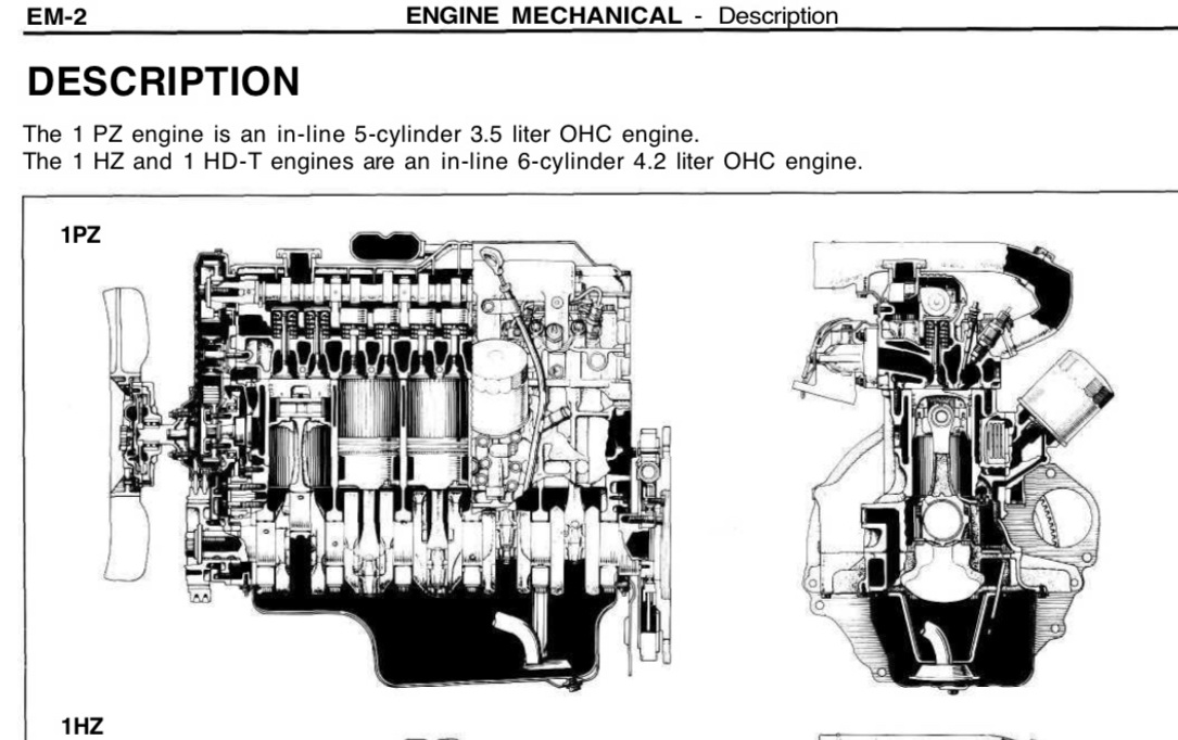

Here are some technical specifications of the 1PZ/1HZ/1HD-T family of engines:

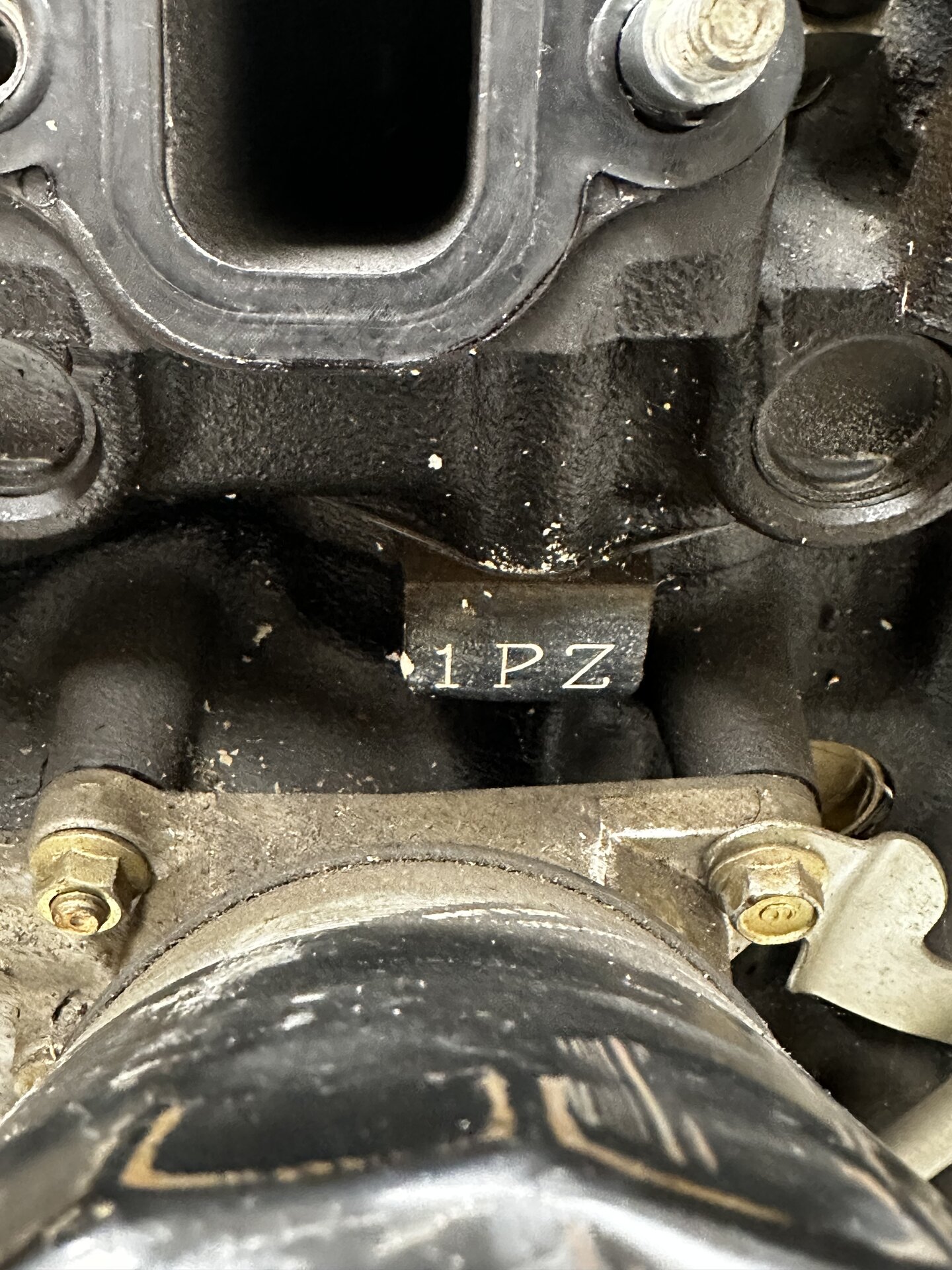

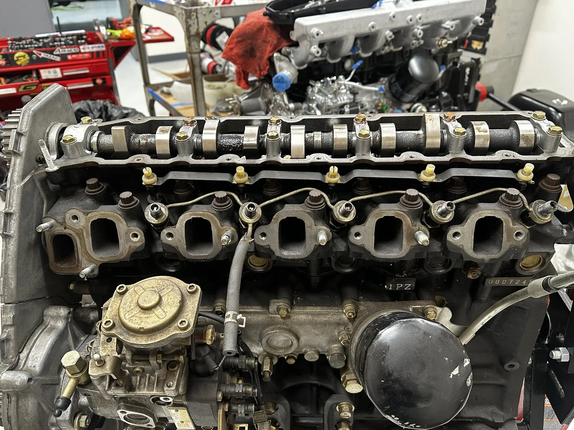

Picked this up about 2 years ago. Been sitting since.

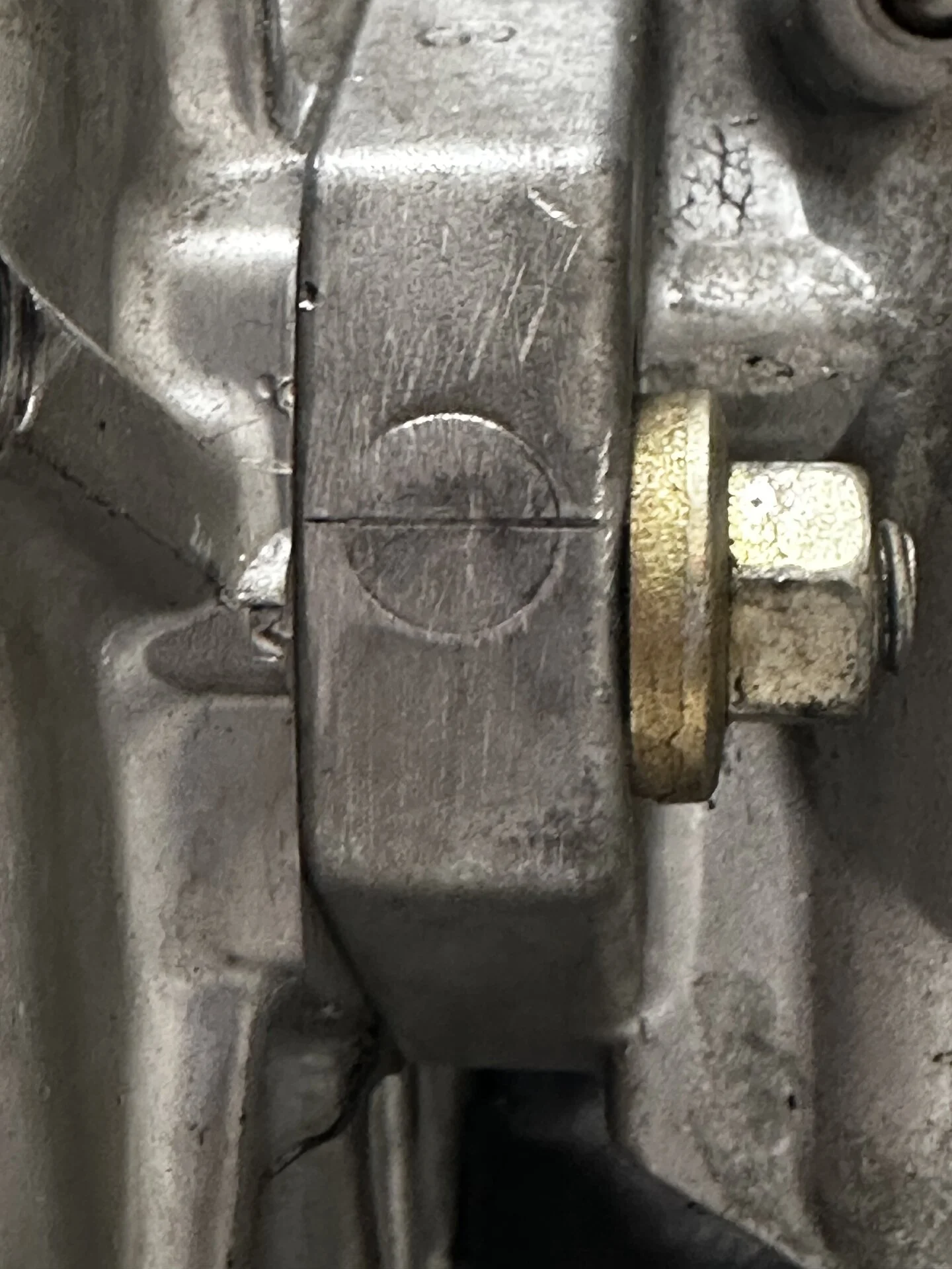

Yesterday I tore it down and to my surprise it looks as if I scored a brand new engine. Or at least very close to a brand new engine.
You can see it’s basically never been run (or if it has it was run for a few minutes and then never run again).

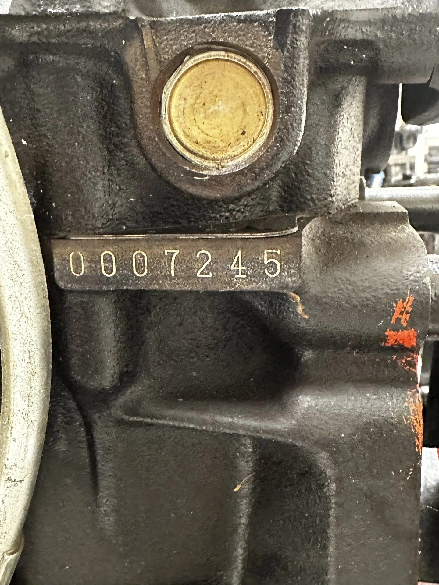

I wonder if this was some type of a training engine for disassembly/assembly? Or a test engine of some sort? I really don’t know. The little I do know about this engine was that it came from mine company surplus.

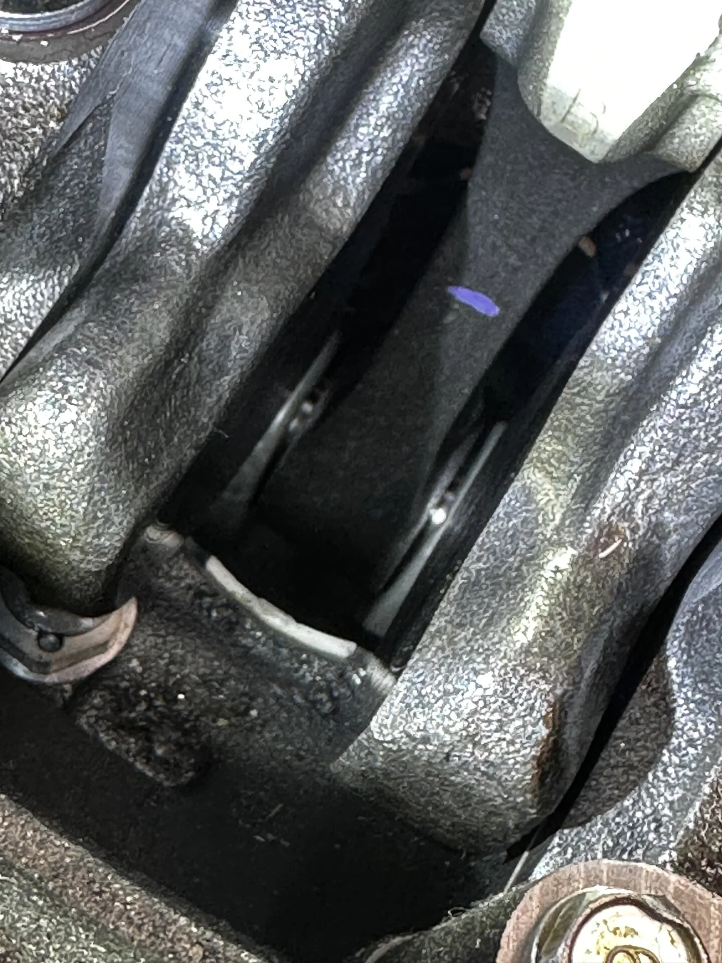

My heart jumped a bit as I continued tearing it down only to see brand new interals:

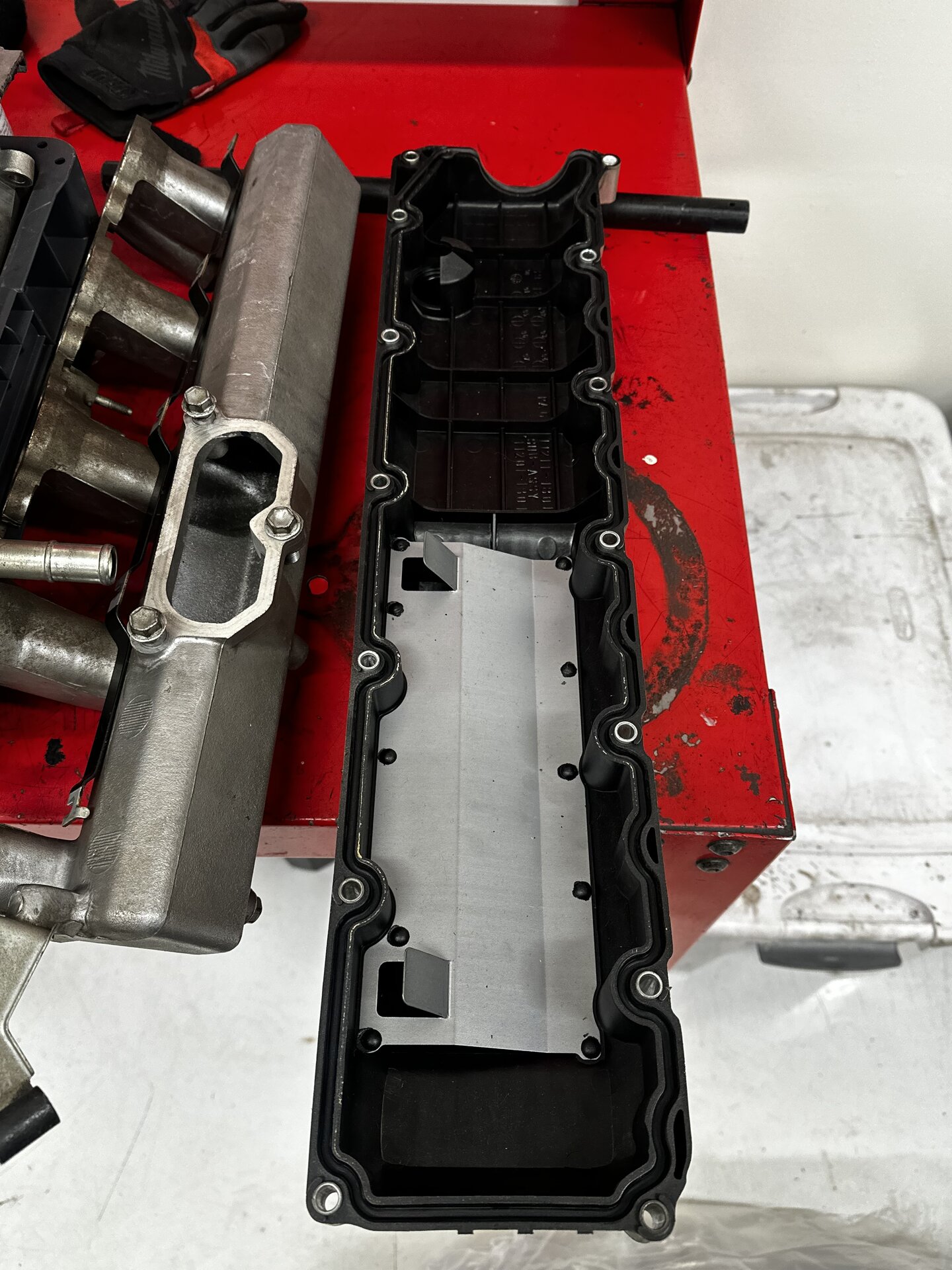

1PZ Tear Down
Some more internal pictures.

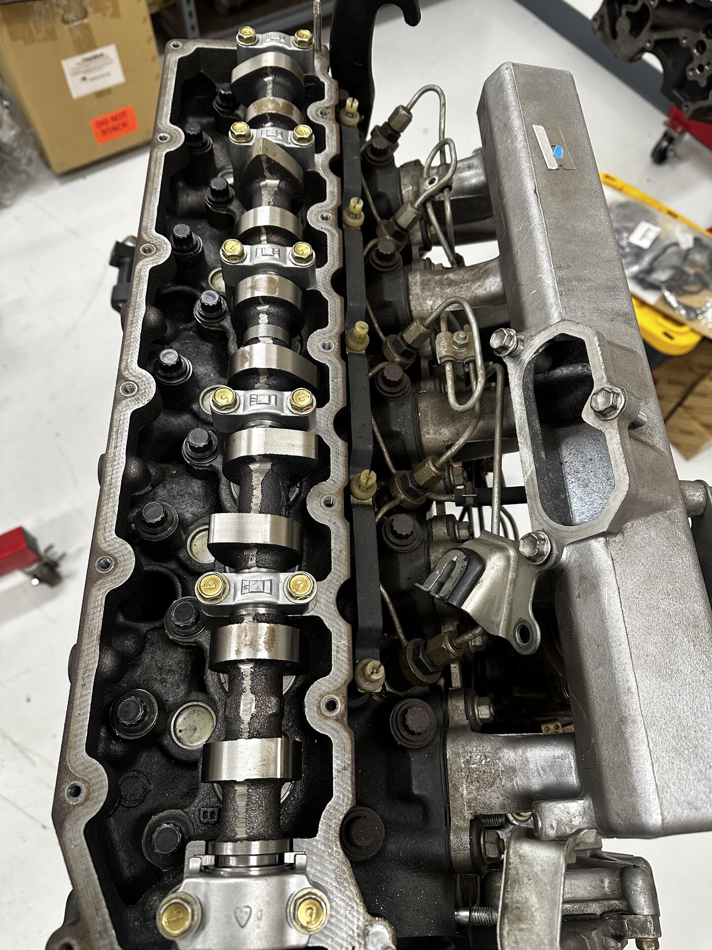

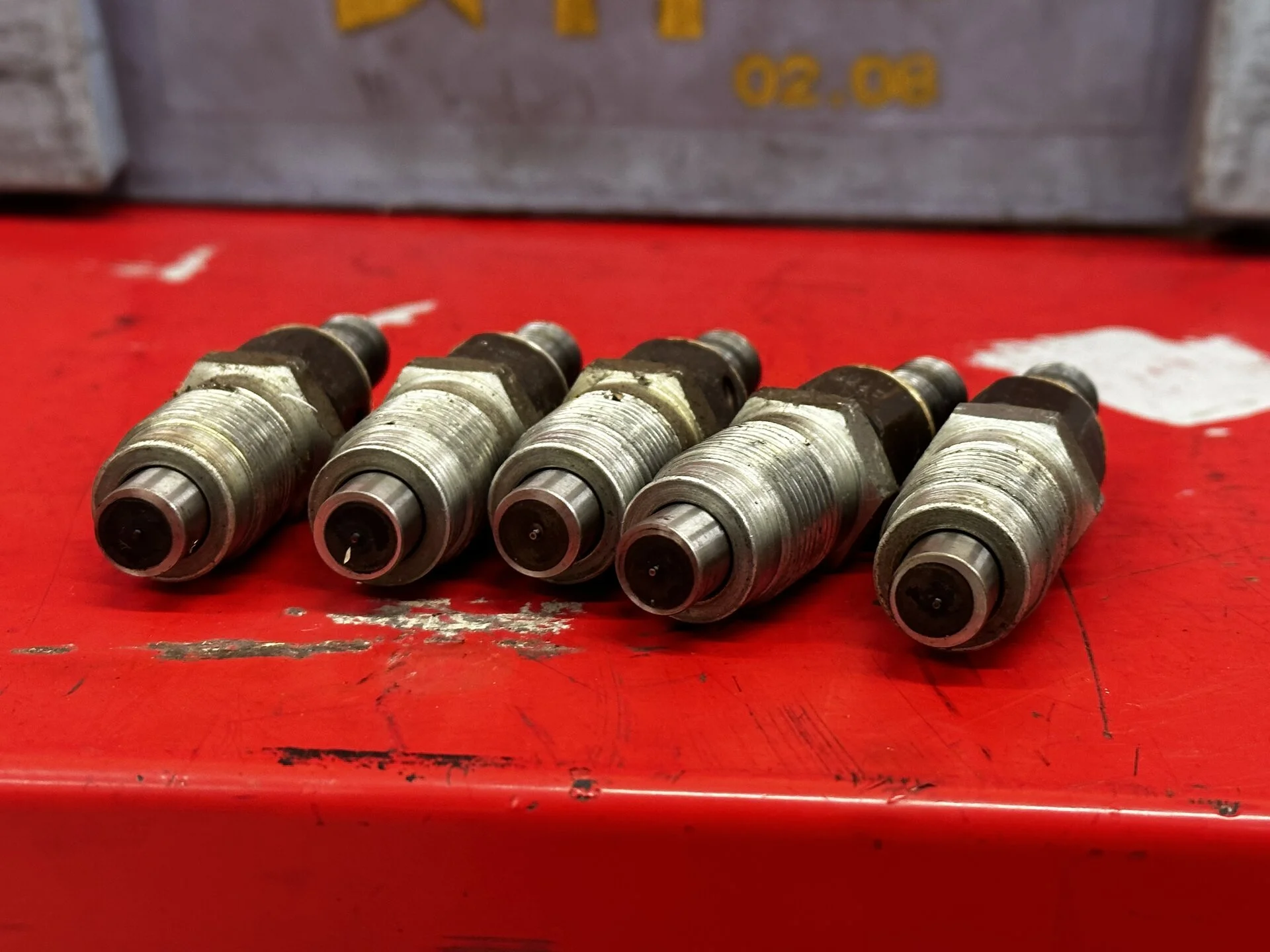

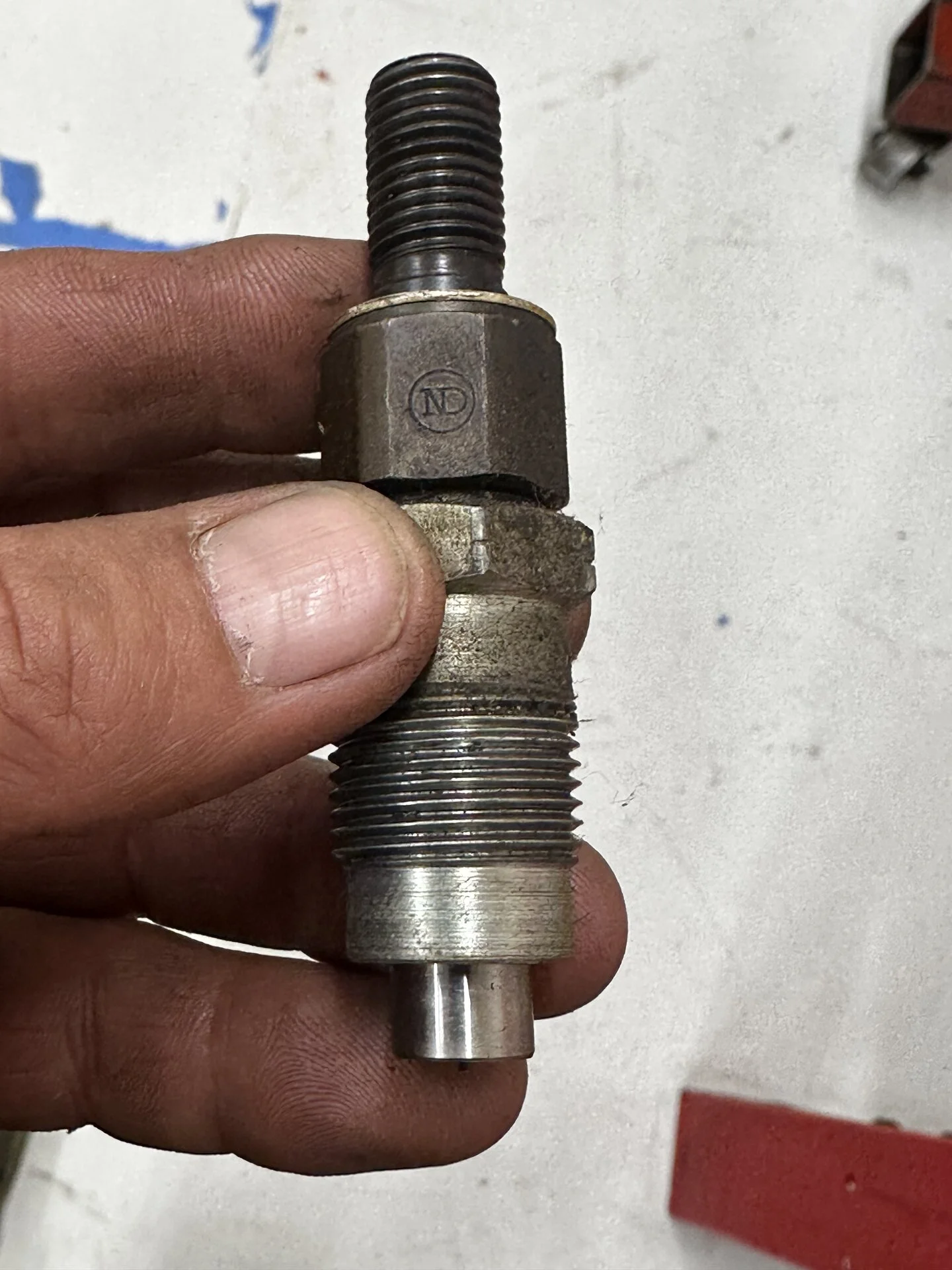

Injectors look like they’ve barely had any fuel through them:

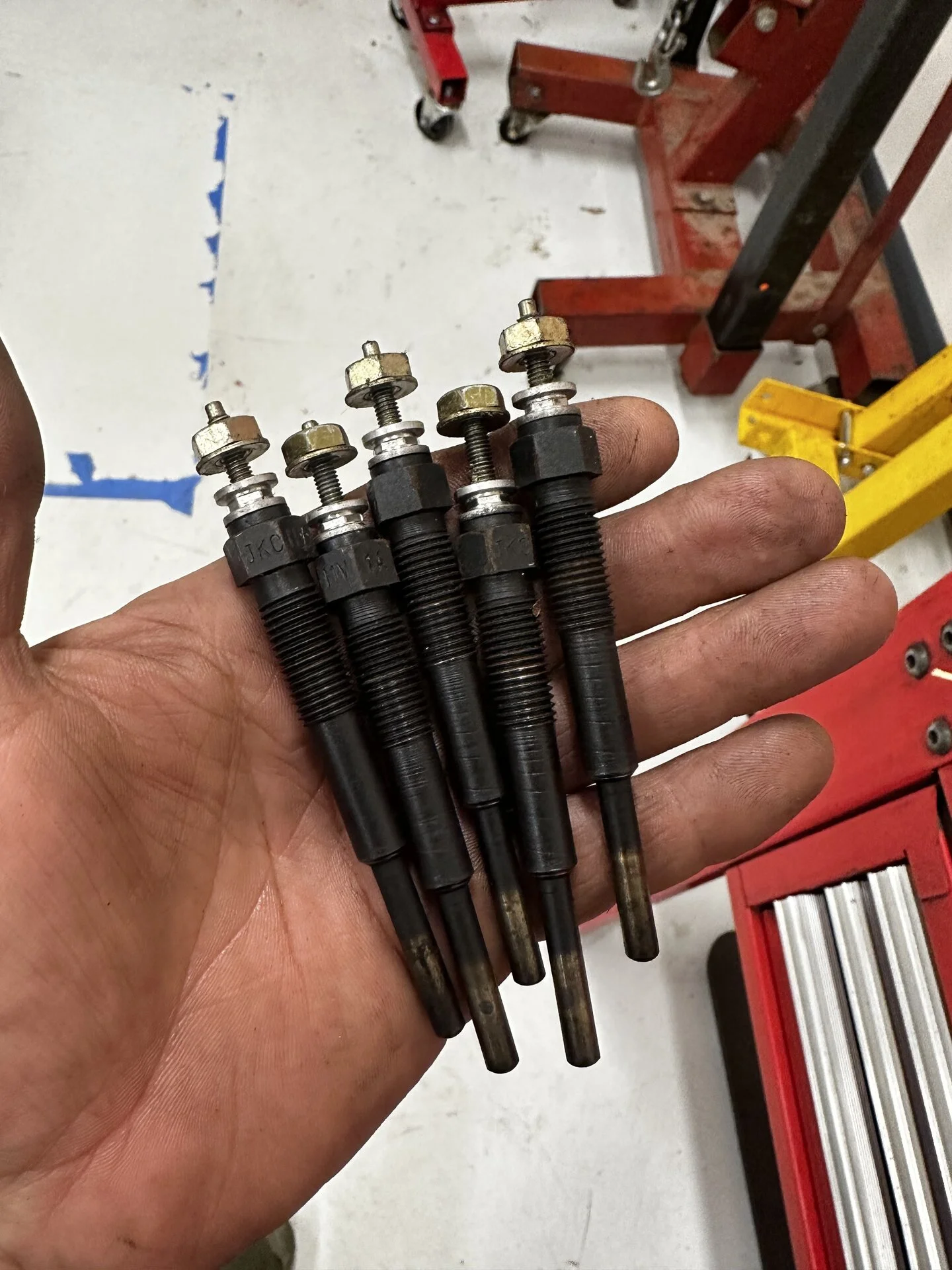

Glow plugs: basically zero soot.

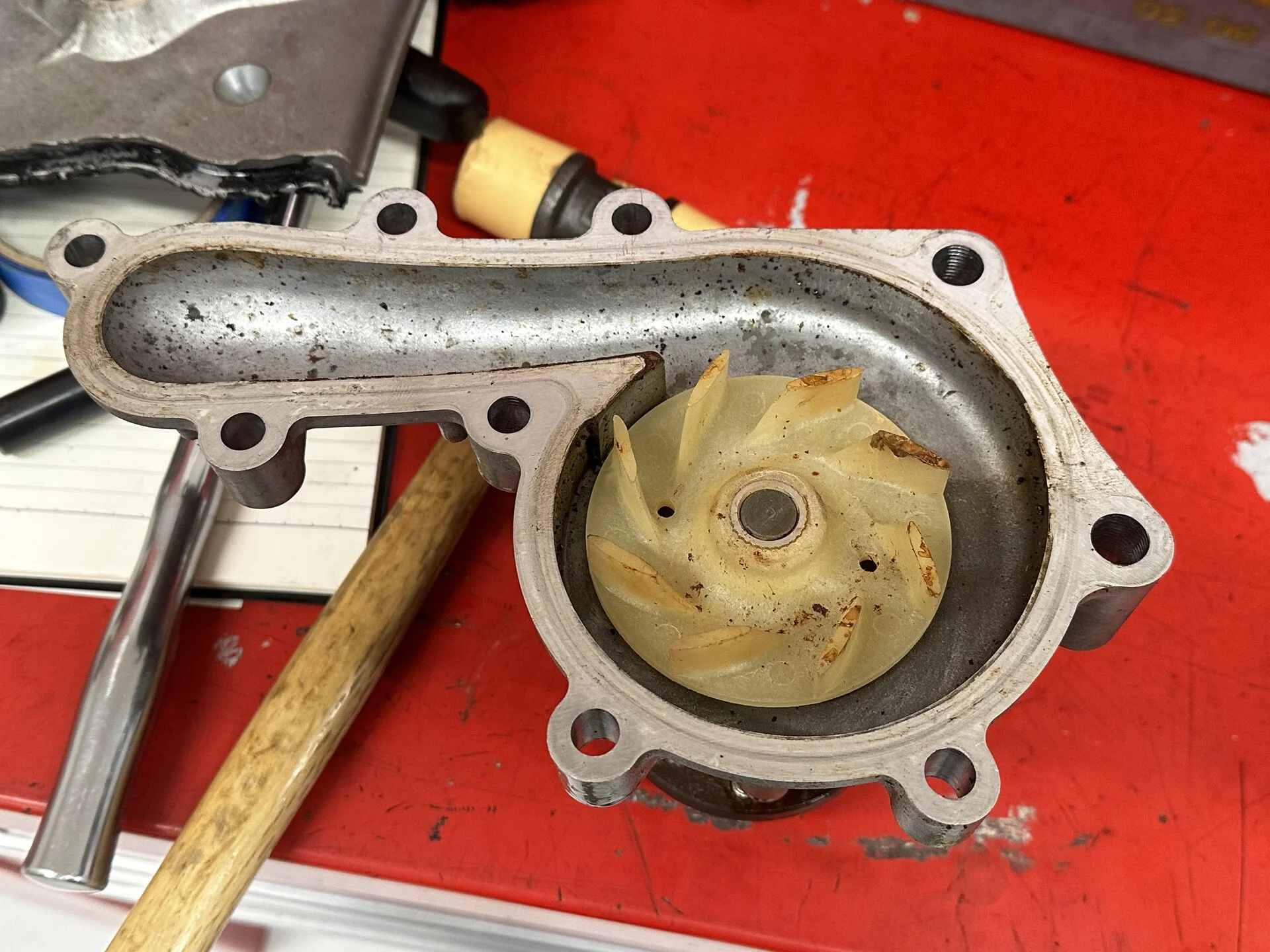

Water pump basically brand new:
There is a bit of corrosion in the water jackets. Those will get flushed out once I open up the oil cooling jacket area.

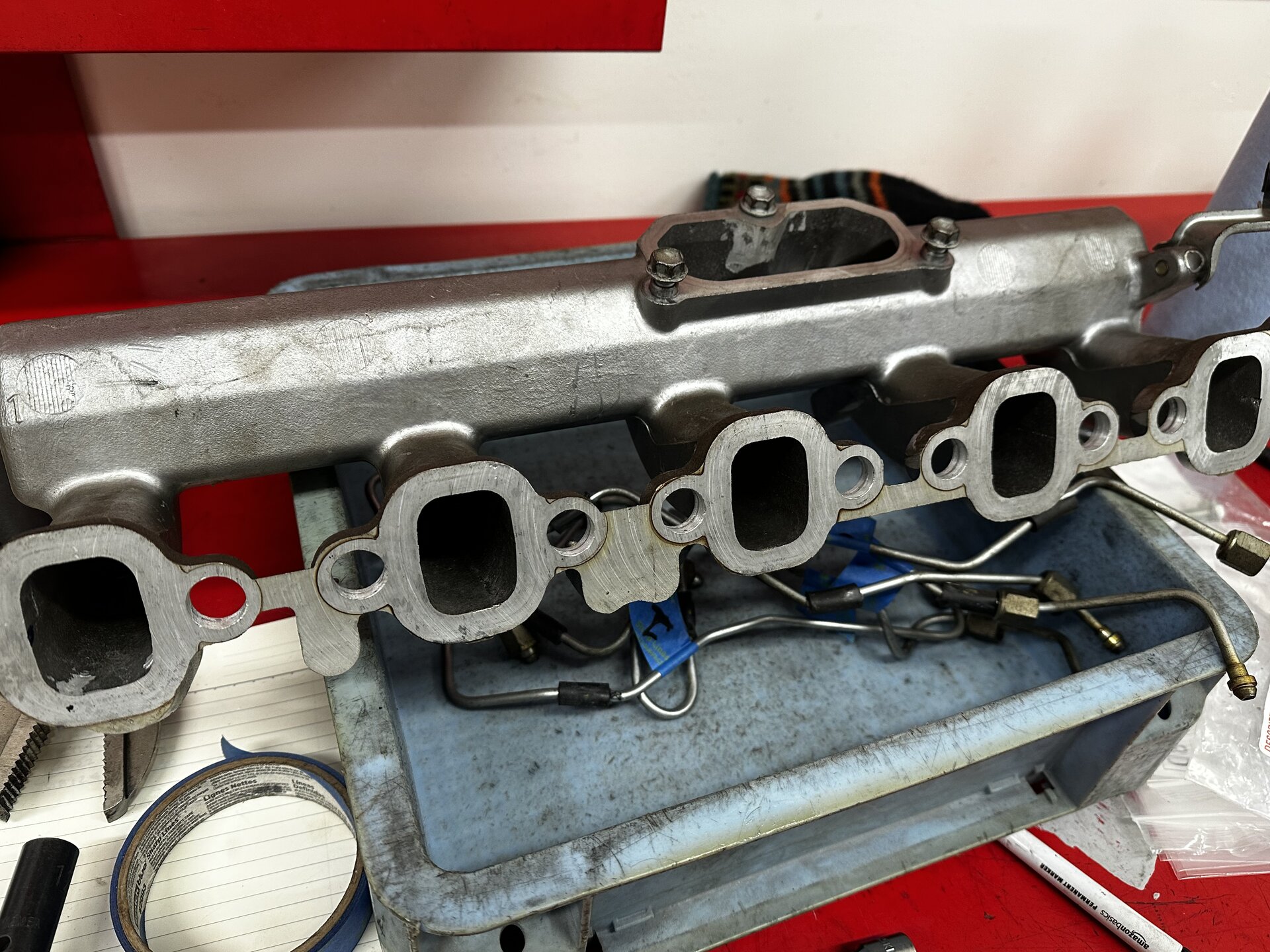

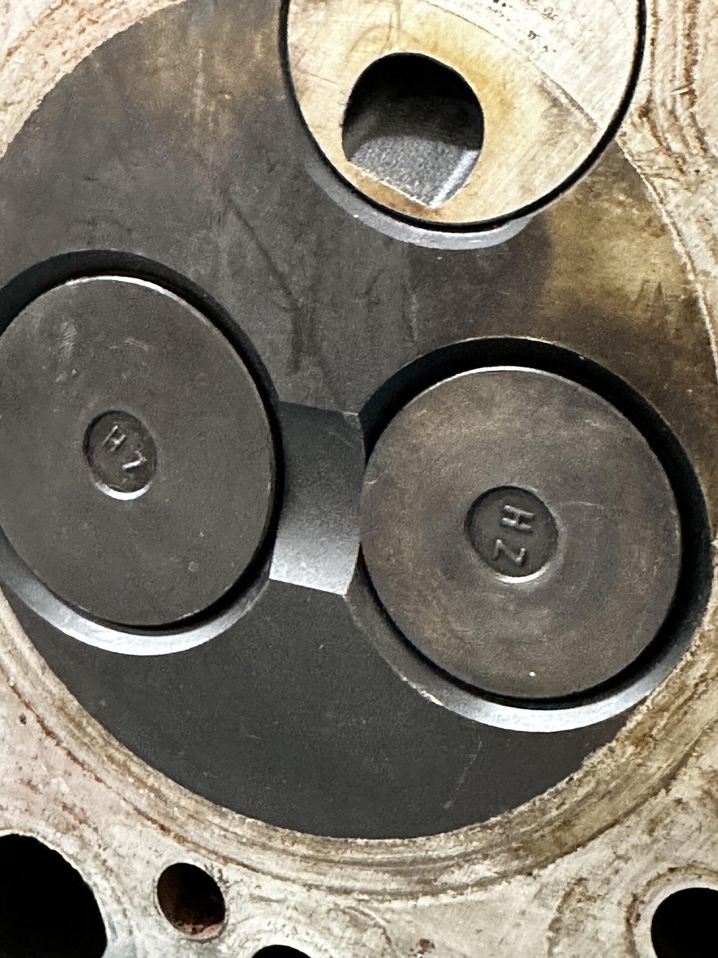

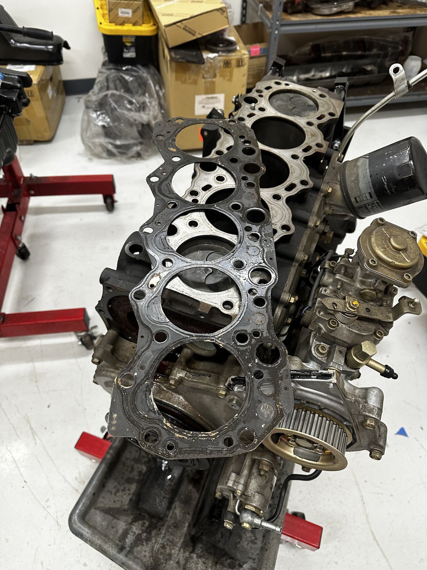

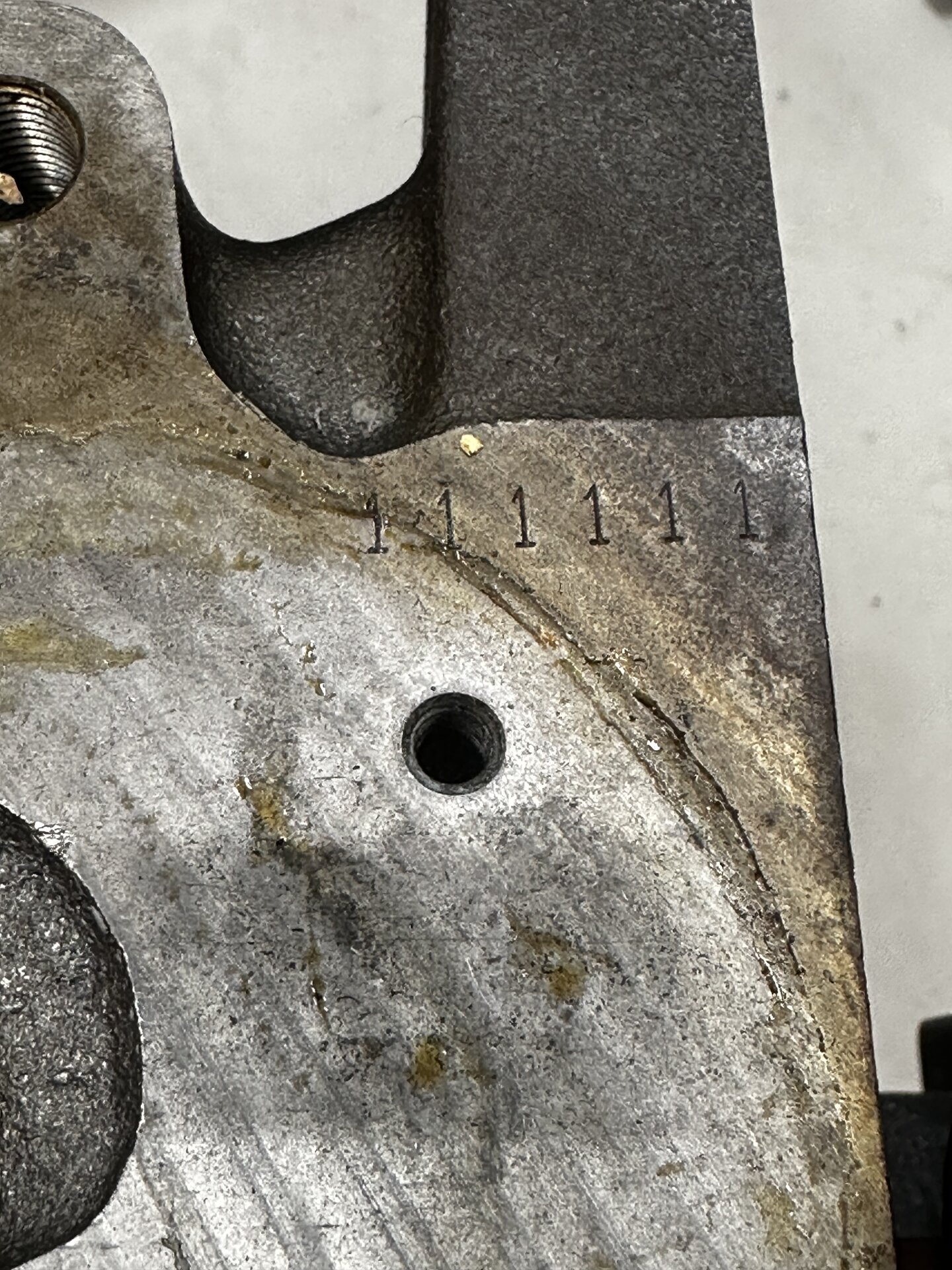

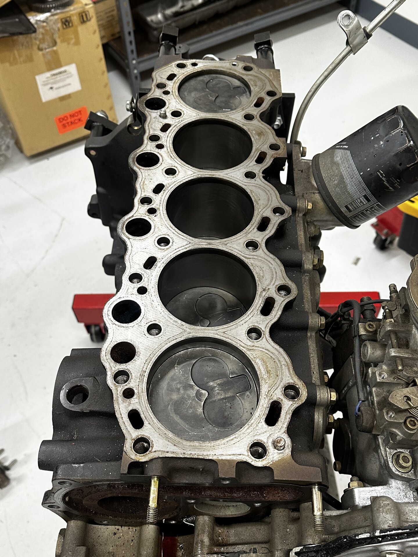

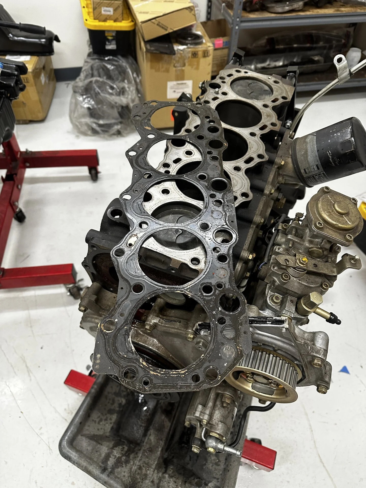

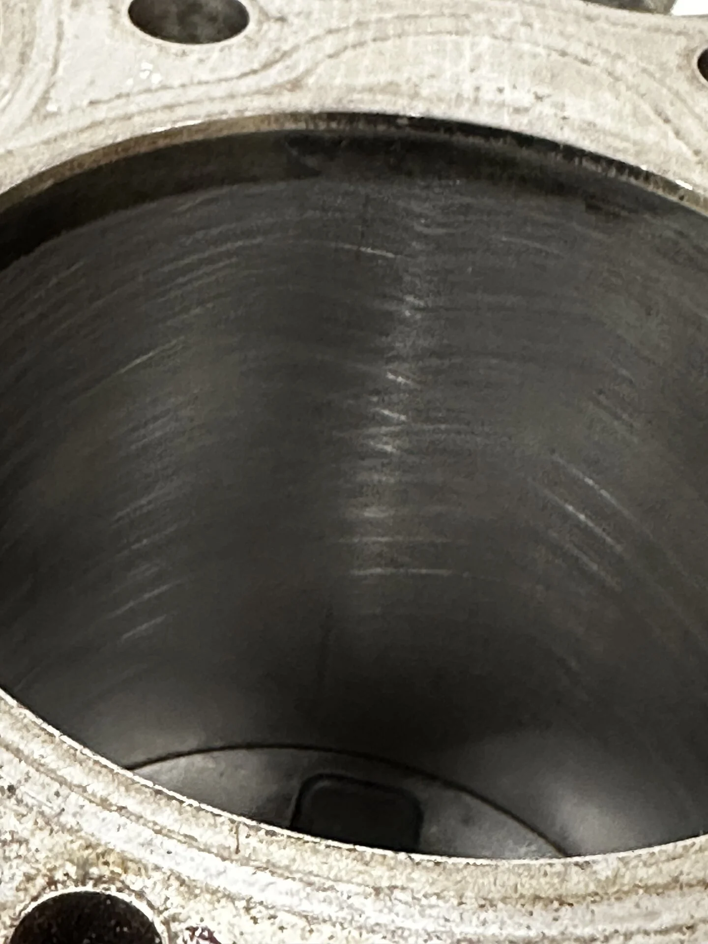

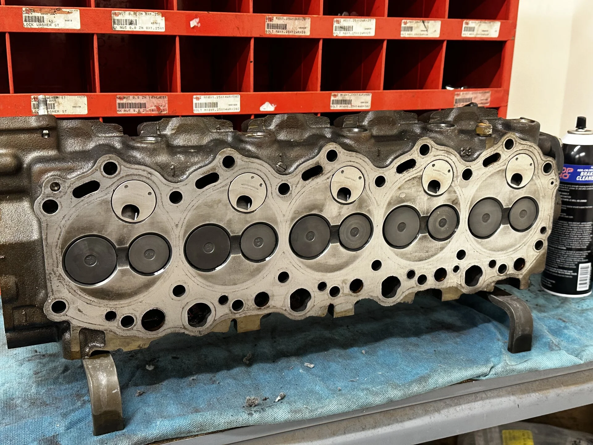

Cylinder head removed. This thing has to be new as well. It’s basically spotless. A little brake parts cleaner and it looked like it came out of a box:
The cross hatching in the cylinders looked like they were machined yesterda. 🤯🤯

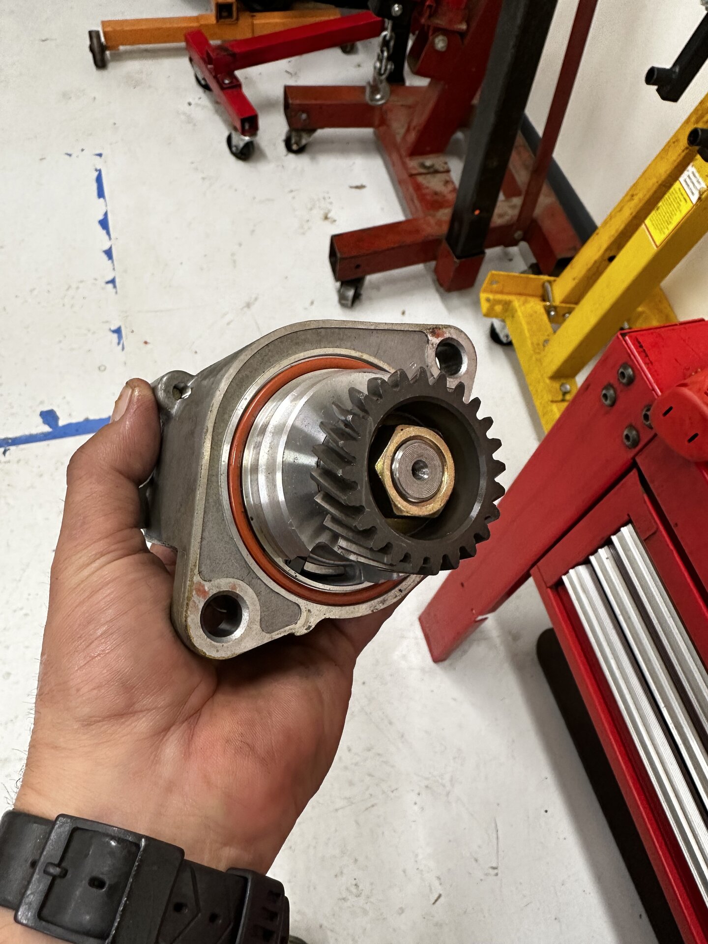

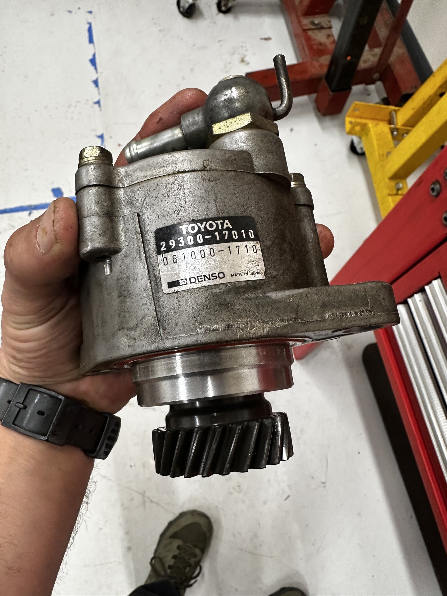

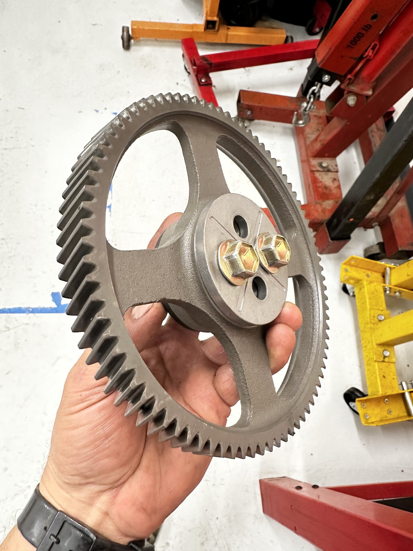

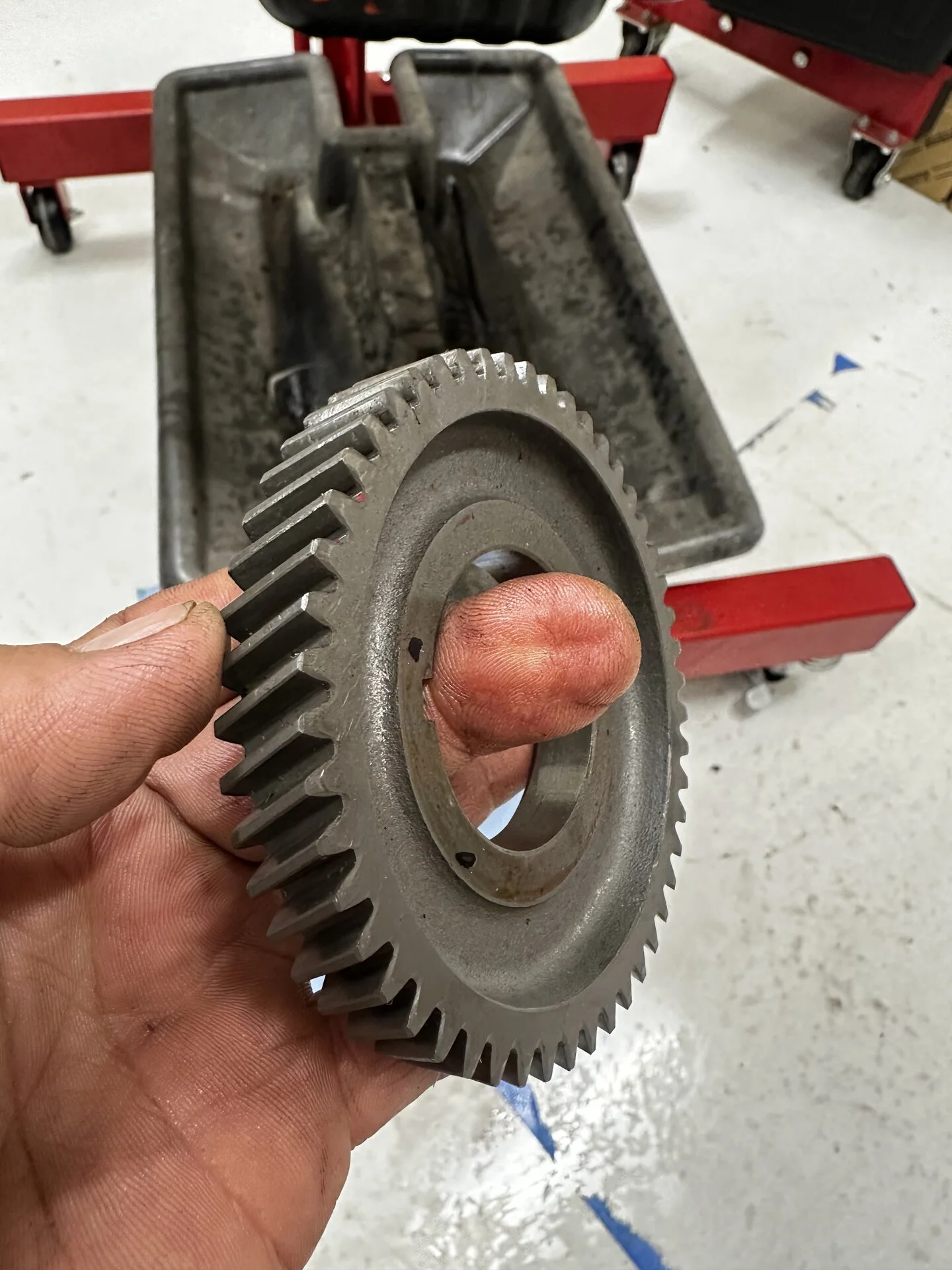

Vacuum pump… again, looks brand new:
The internal gears look like they’ve never even meshed before.

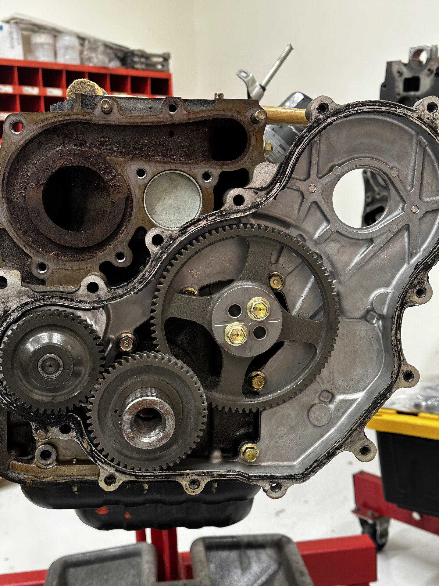

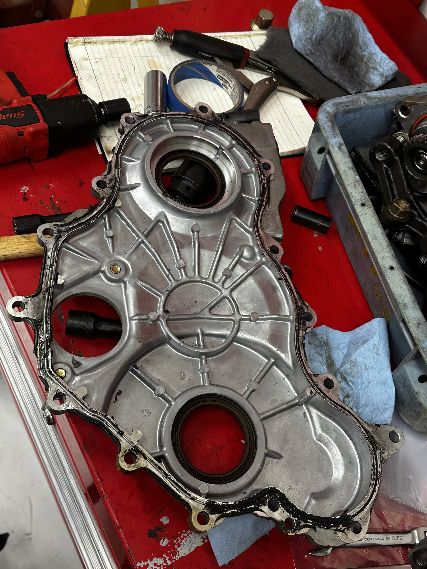

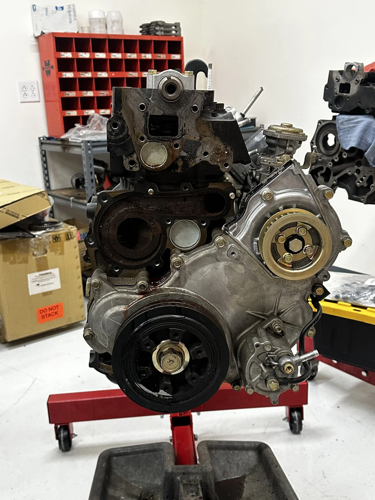

Inside of the timing cover. Immaculate.
It does look like the IP has been adjusted at some point. The two nuts holding it on were different as well.

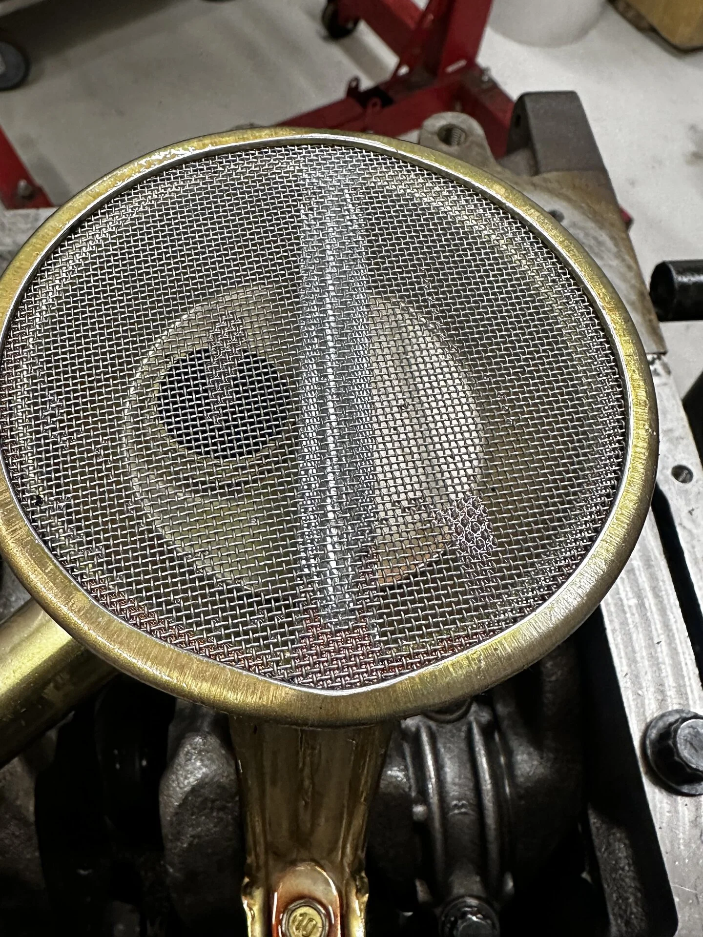

Like no oil has even gone through the strainer.

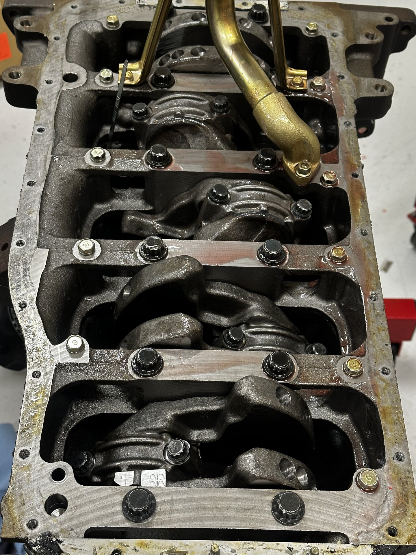

Looking under the piston skirts:

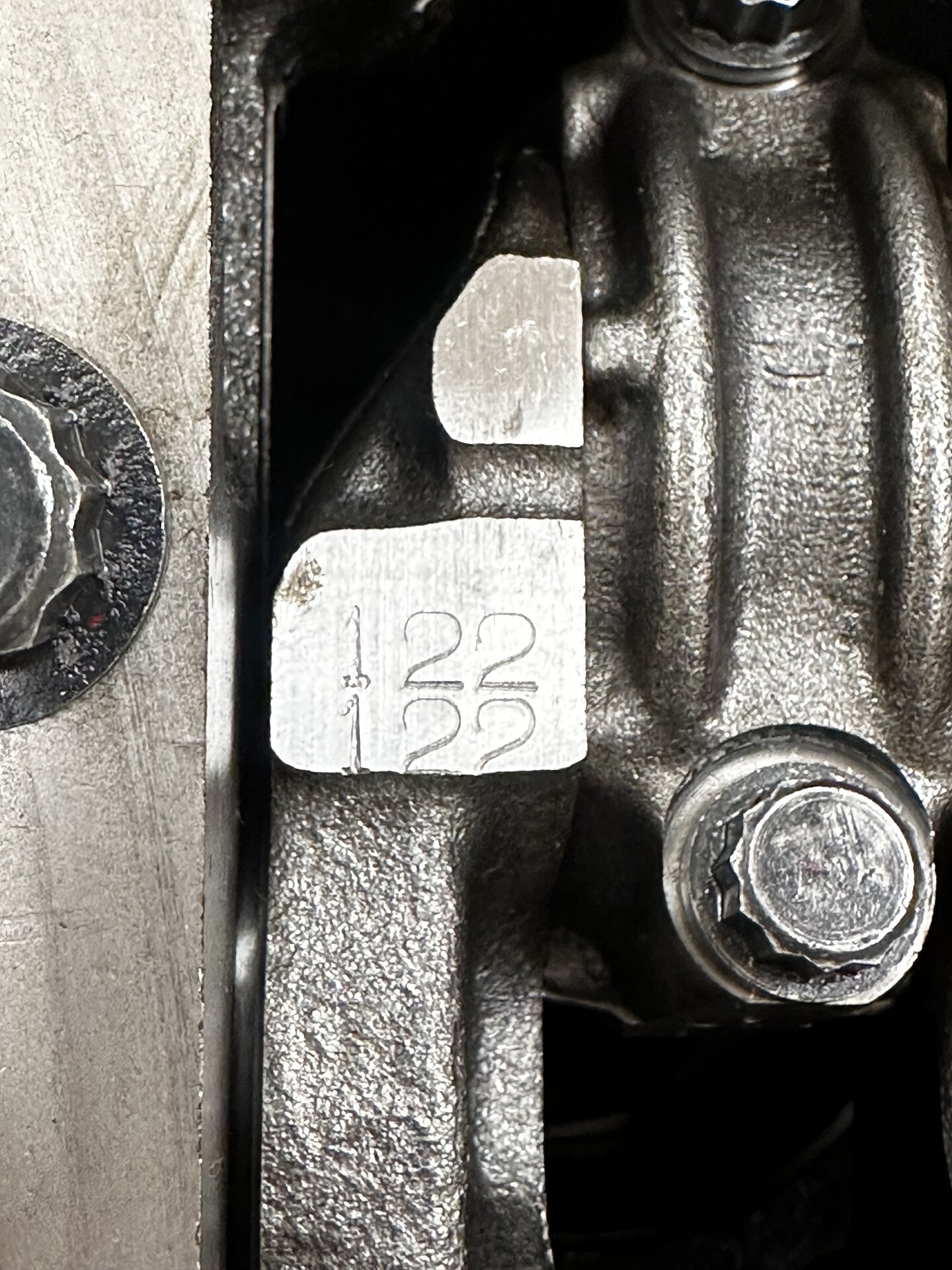

At this point, I’m in a position to remove the bearing cap assembly and make sure everything measures out correctly.
If this was some sort of training engine for technicians, I do want to make sure it was done correctly before installing it into my rig. 👊👊
