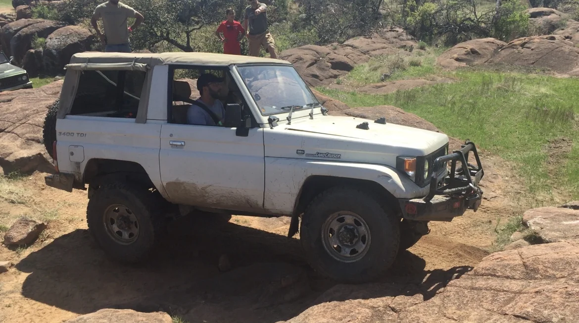

I can’t wait to see you build this truck back up. I was looking through old pictures for some other reason, and stumbled across this one from Roundup in 2017 when we met for the first time. Seeing that softtop poisoned my brain, and made me build my own…
