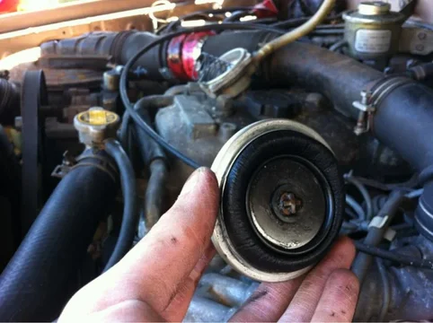

Thanks John @ Radd Cruisers for the pointer on the diaphragm
I did a bit of a search on the Diesel forum and tested the diaphragm by sucking on the tube and it is definitely losing suction very quickly, so i'll be ordering a new one tmrw
Fixed!

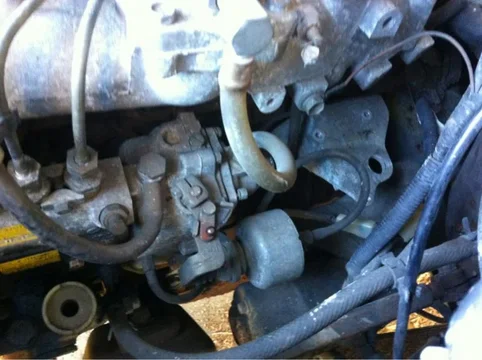

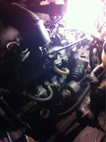

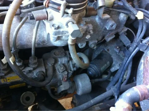

yesterday i took the longest time taking the EDIC Motor out. The bolts came out fine but the motor was stuck to the mount :P wiggled and jiggled it and it finally came out.

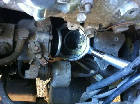

Then I took off the diaphragm housing cover
It was pretty easy. The screws didn't seem very tight though.

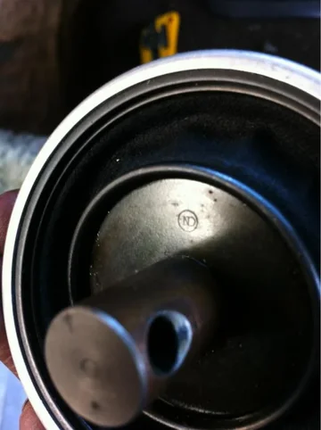

Then I took off the cotter pin and washer and slid the diaphragm off. Couldnt see anything wrong with it
I just wonder... would this be an original diaphragm? Because it has "ND" stamped on it
Do the new Denso stuff still have ND stamped on them?

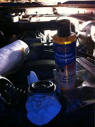

I actually hadn't gotten any replacement diaphragm yet, so we made a trip to Lordco and the guy at the counter said there wasnt any rips he could see. Asked for Neatsfoot Oil but they dont have any
So we went to the shoe repair shop in the mall and bought a big bottle of it
I took the oil and gave the diaphragm a few drips on both sides and rubbed it in and then stuck it back into the housing
IT TOOK SO LONG. The hole has to be so well aligned fr it to slip on.
finally finished at 9PM
I also re-tested it by sucking on the tube and it has perfect vacuum.... maybe it was my jig that i set up last time that was leaking air.... oh well
And this morning I started it up and ran it for around half an hour with regular idle speed (600 to 750) and voila NO SMOKE
