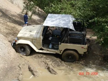

That light weight rust saved you from putting it on it's side here. :grinpimp:
