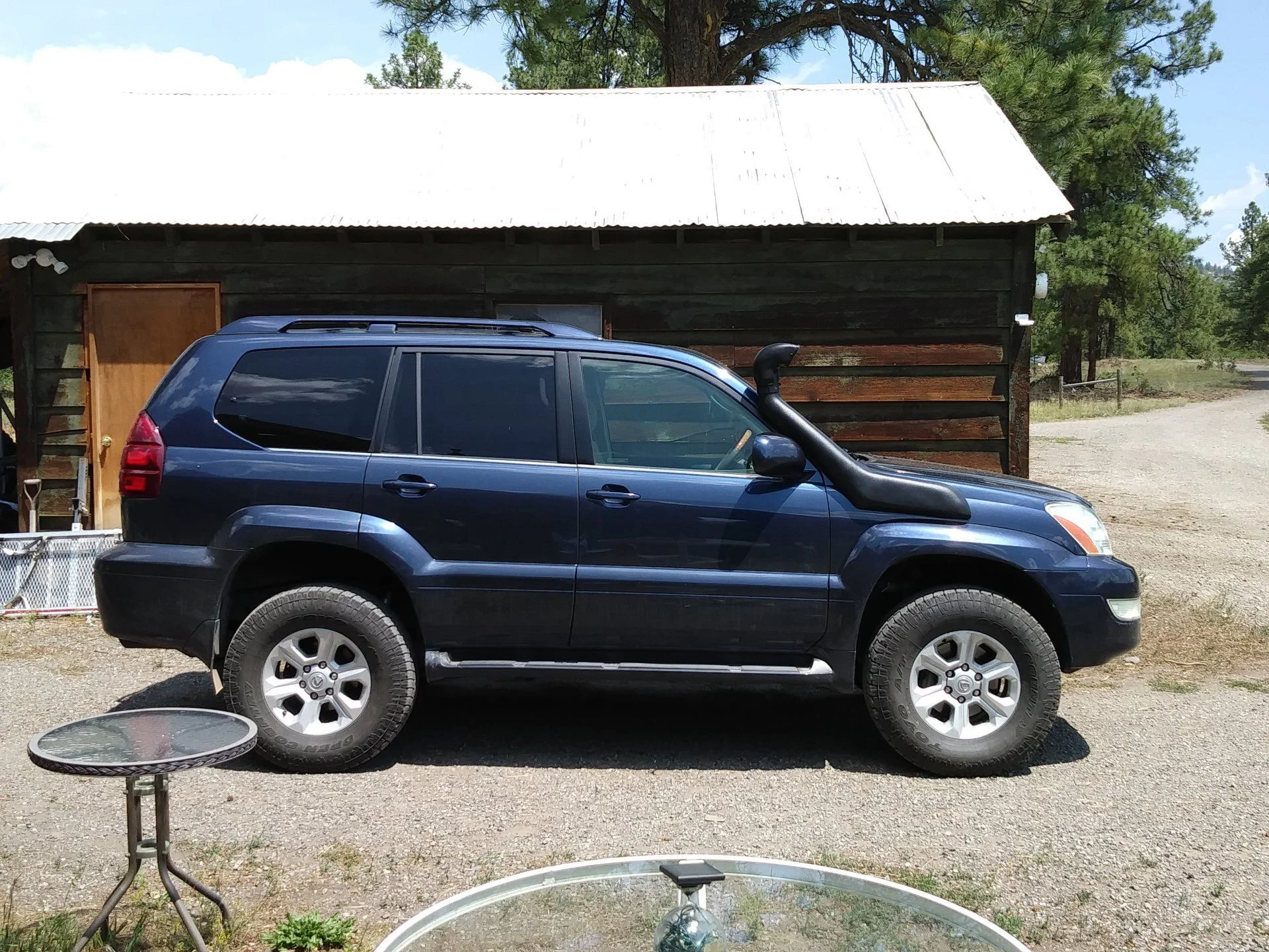

Here’s a side shot of mine. Toytec 2” rear and 884 ome front on lowest perch of the 5100 Bilstein. I’m replacing them soon to go with a taller spring and winch bumper.
