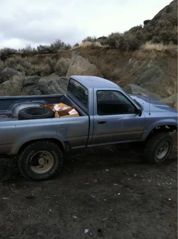

Went with 31 by 10.50s
also worth noting, 31s on stock 4.10 gearing will add to wear on your clutch. especially if driving uphill from a stopped position (uphill intersections) is a common part of your commute. though, this is probably more of an issue for us 4runners. i've actually never driven a truck with 31s on 4.10s im sure its a bit less sluggy. so maybe you're better off than i am.
i haven't regeared yet and 33's and 411's pretty much sucks. can barely keep it in over drive on the highway. wants to down shift if you stomp on it . manual tranny might be better, but you would still be out side your power curve.
Ya my dad told me I would more then likely snap an axel with the stuff I put her through so I went with 31s I pretty much can't tell the difference from my stock 29s. Lol what year is yours? My truck don't have overdrive

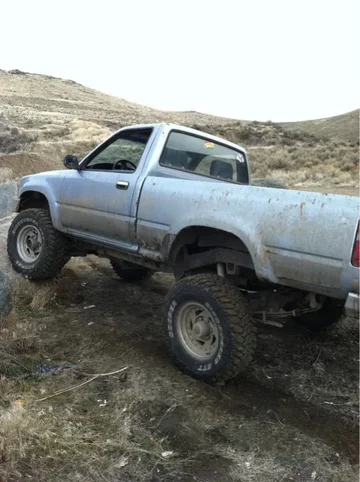

regearing is a pain in the ass mostly because its so expensive. it is something you only want to do once. there are so many variables out there. a regular cab 4x4 with a 5 speed like yours is the lightest body style toyota made that year. regearing that truck will be way less noticeable than a 4runner of the same year. unless you plan on making it a crawler anytime soon i think you made the right decision. good luck and enjoy your toyota, it looks like a nice truck. i have always liked those regular cab 4x4s.
Thanks man it got some problems but she does good for the most part. I was backing off that rock and idk what tire it was but it totally ripped off my front bumper.
