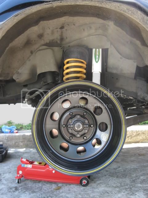

here is the other wheel im planning to fit on my truck. :)

Thanks man, got it! but i think i am already on aisin manual locking hubs... :) what difference does it make if its manual locking from auto locking?
My mistake, I assumed that last picture you posted, of the front wheel, was your truck. But now I realize it's an 80-series, not your truck.
man youre good! yup that is in fact from an 80 series land cruiser.
Its alright, i appreciate the warning/precaution. :)
