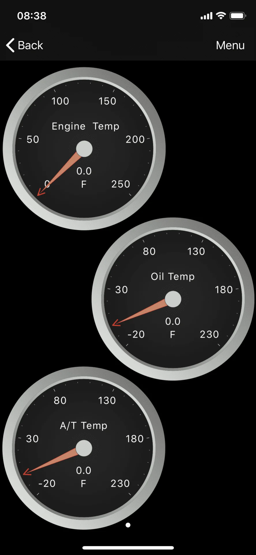

If you are afraid of trusting the gauge in the dash, I suggest buying a cheap bluetooth dongle that goes into the OBDII port. Then get something like OBD Fusion. You can setup gauges with the program to give you the actual numerical value read by the sensors. It also allows you to read the codes, should one pop up, so you know if it is a major deal or if you just forgot to tighten the gas cap. I use this when I am on the trail so I can monitor my AT temp levels and coolant temp.
