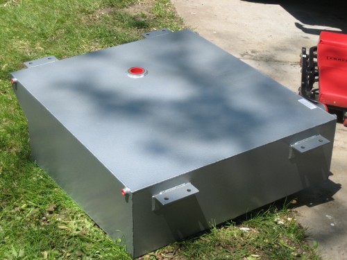

Here the one I have in mine right now. It't the man a free 38gallon.
I also have the MAF 38 gallon in my FJ62. It's like Mr. FJ60's pic but has another cutout for the fuel sender. For those w/ the SOR 42 gallon, have you tried accessing the tank through the panel in the rear cargo floor? The top of the fuel pump doesn't quite line up w/ the access panel in the MAF tank. So if you need to service the fuel pump, you have to drop the whole tank. Only bad I see in the design...nice lines, tucked pretty good, higher than the former spare tire carrier. I dig filling it up to lock in some cheap gas...even though the mileage suffers a little from all the weight.
