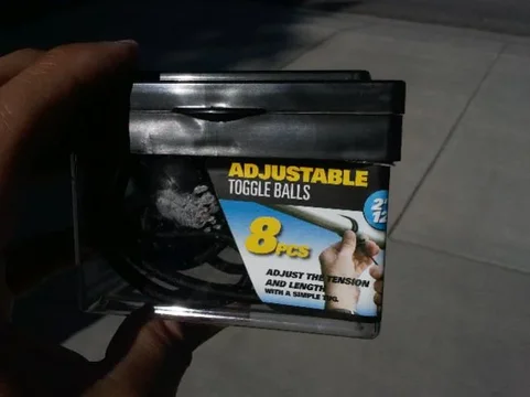

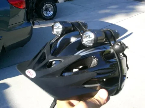

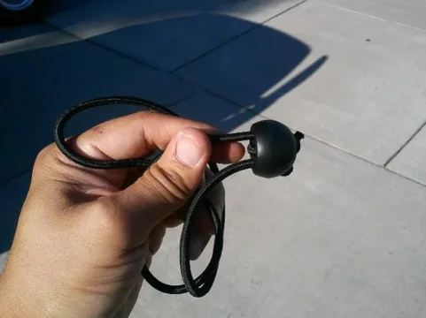

This is what I ended up doingnfor tonight.
Just used a bungee to secure small handheld flashlights (200 linens, each)
I did not want to waste money on.buying less than satisfactory in a rush.

Anyway, the lights that I used worked great, EXCEPT the batteries burned out relatively close to the end (I should have used one at a time, instead of both at the same time) and the bungee cords put some pressure on my head that it made it feel like I was going to have a massive stroke. So, I ended up mounting them on the handle bar, using the same bungees.

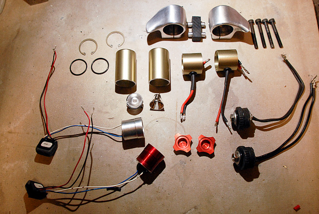

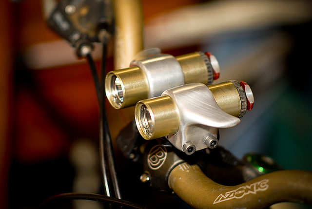

That's pretty slick! :eek:
Sorry for not being able to decipher, but "96 Judy" is that the light you used/bought or did you make the lights, as well as the mounting brackets?

I made it from a 1996 Rock Shox Judy suspension fork. I re-purposed 16 parts from the fork to make a light. Drivers are 1000ma Buck Puck and LED's are Cree XPG R5. It's one of the brighter lights in our group. "Judy" - a set on Flickr
