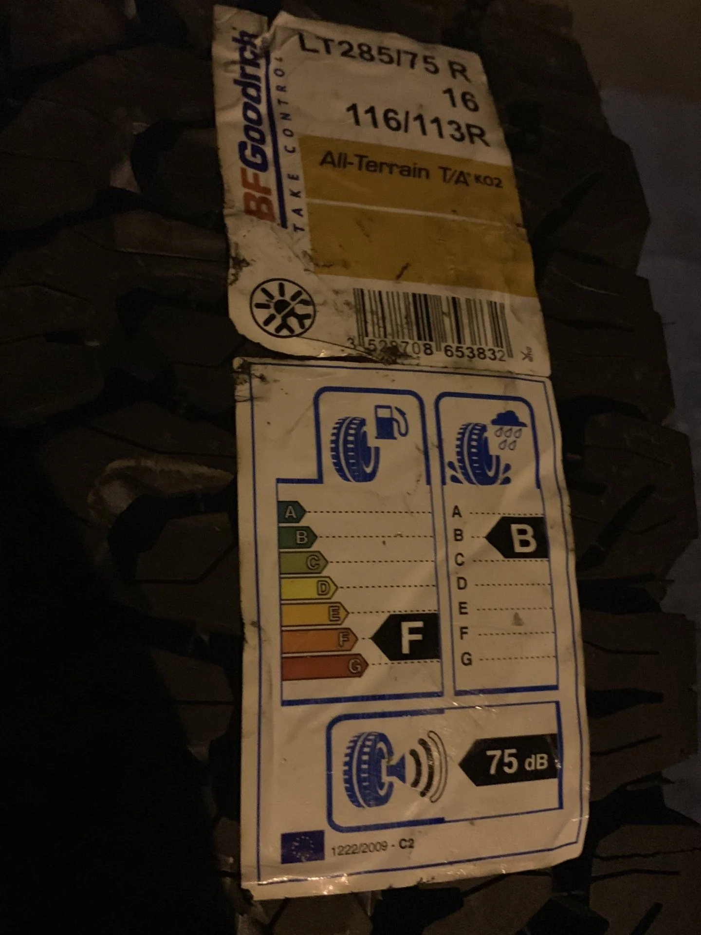

I have the European KO2 285/75/16 116/113R load range C on my 80 series. It is way more comfortable than the load range D Coopers I had previously. Very plush ride, no road noise, good grip too. Very happy with them.

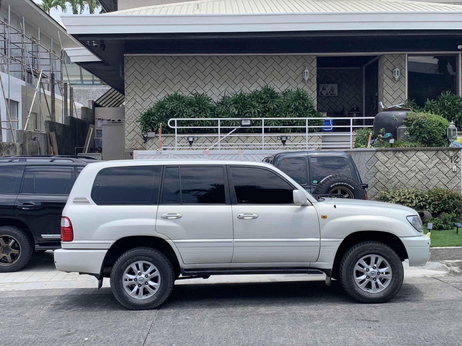

Regarding fitting the 200 series rims on a 100, I have 17” 200 series wheels on my LX470 and they fit perfectly, including the center caps.

Ah so the 116/113 rating isn't even the "D" load, but the "C" :(( That's sad.. Guess this explains why they don't like it here in Europe. Now I wonder why nobody imports the heavier ones..

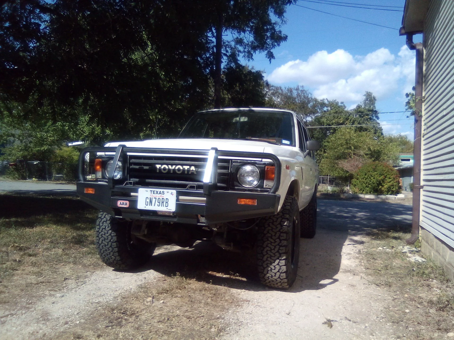

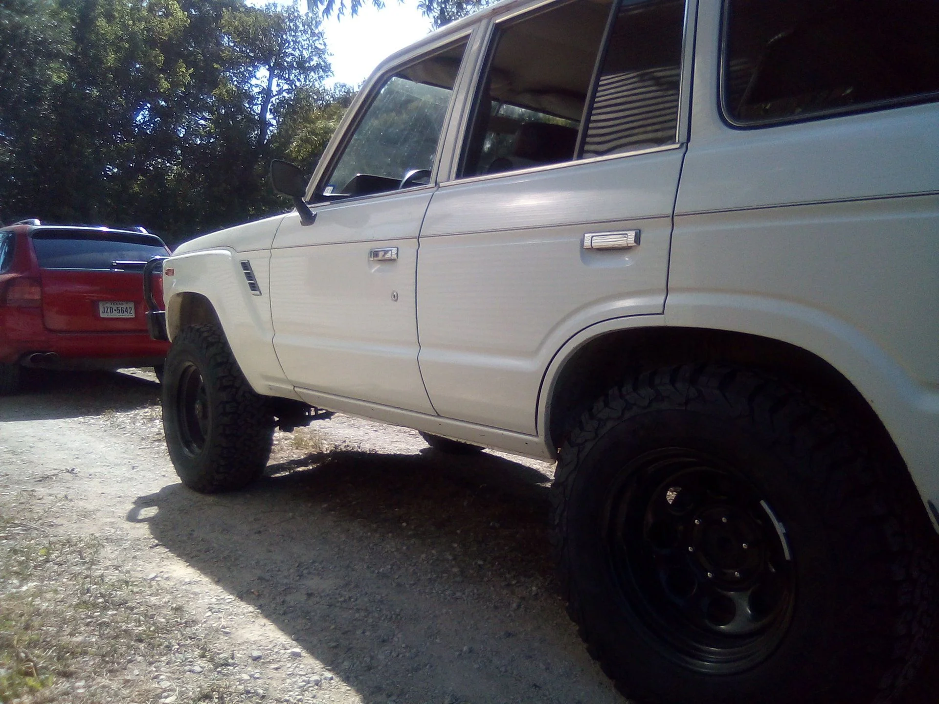

I just had a set of ko2 mounted on my 87 fj60 in 285/70r17 in load range e. Night and day difference in noise compared to the previous 33x12.5x17 my that I had been running. No noise is pretty damn nice.
