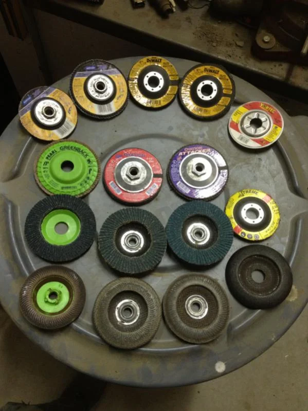

I was having issues uploading pictures via mobile using the wireless. I have several more pictures to upload.

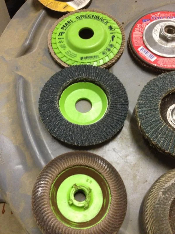

The Pearl Greenback in the above picture cost more ($10 per wheel) than the rest but they outlast the other by about 4 times. They remove everything from mill scale to power coating.

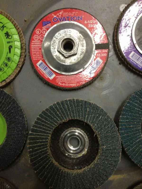

The Blue Label Ovation plug the quickest.
The Red Label Ovation are a little better than the Blue Label but not much.
The Norton works extremely well but simply does not last that long.

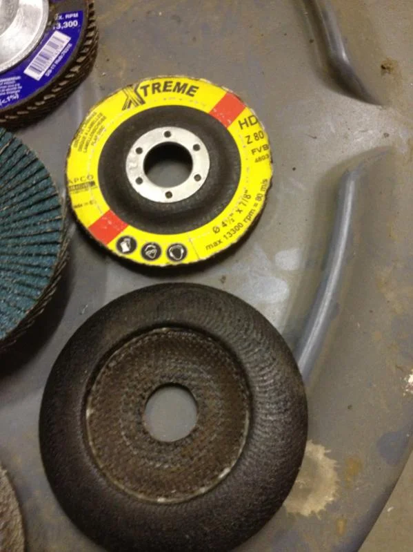

The Yellow backed abco Extreme HD glazes over instantly.
The Dewalt does OK but is Hit and Miss. One wheel will last a long time and the next wheel will glaze over in a matter of minutes when grinding away rust.
I will post up more pictures when I get my mobile/wireless issue resolved.
Dan,
My LWS guy a couple of months ago swapped me to the Pearl Fat Max's from the Norton's that I had been running. He also told me to swap from the Walter Zipwheel to the Pearl Redlines when I get low on my current stock. He told me the Pearl products are cheaper and last longer. I agree on the flap wheels lasting longer and they seem to take off material quicker. However the two zipdisks I took home I'm not sure about, they are cheaper, but seat of my pants I don't know if they last longer. It sounded like they might be phasing out the Walter line, so hopefully these will be as good.
I have never run the green backs, as I stick to the fiberboard backing so I can run them down to nothing for those hard to reach areas. I'll try some next time I buy a box.
Have you tried any of the Roark branded disks? They seem to sell them over on Pirate all the time and they are cheaper, just not sure how they do.
