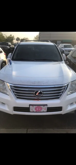

Any videos on how to remove the clear rock protection film off my hood . Or can anyone tell me how ?
thanks in advance
Patients and a heat gun. I had a bunch of 3M factory crap on my wife’s ‘12 Avalon I had to remove last winter and it was a PIA. Warmer weather should help and get some 3M automotive adhesive remover for final step.
Thank you mine is turning yellow and has a lot of checkering in it … make the car look very bad imo.. any tools or just used your fingers to lift it after heating it up ?

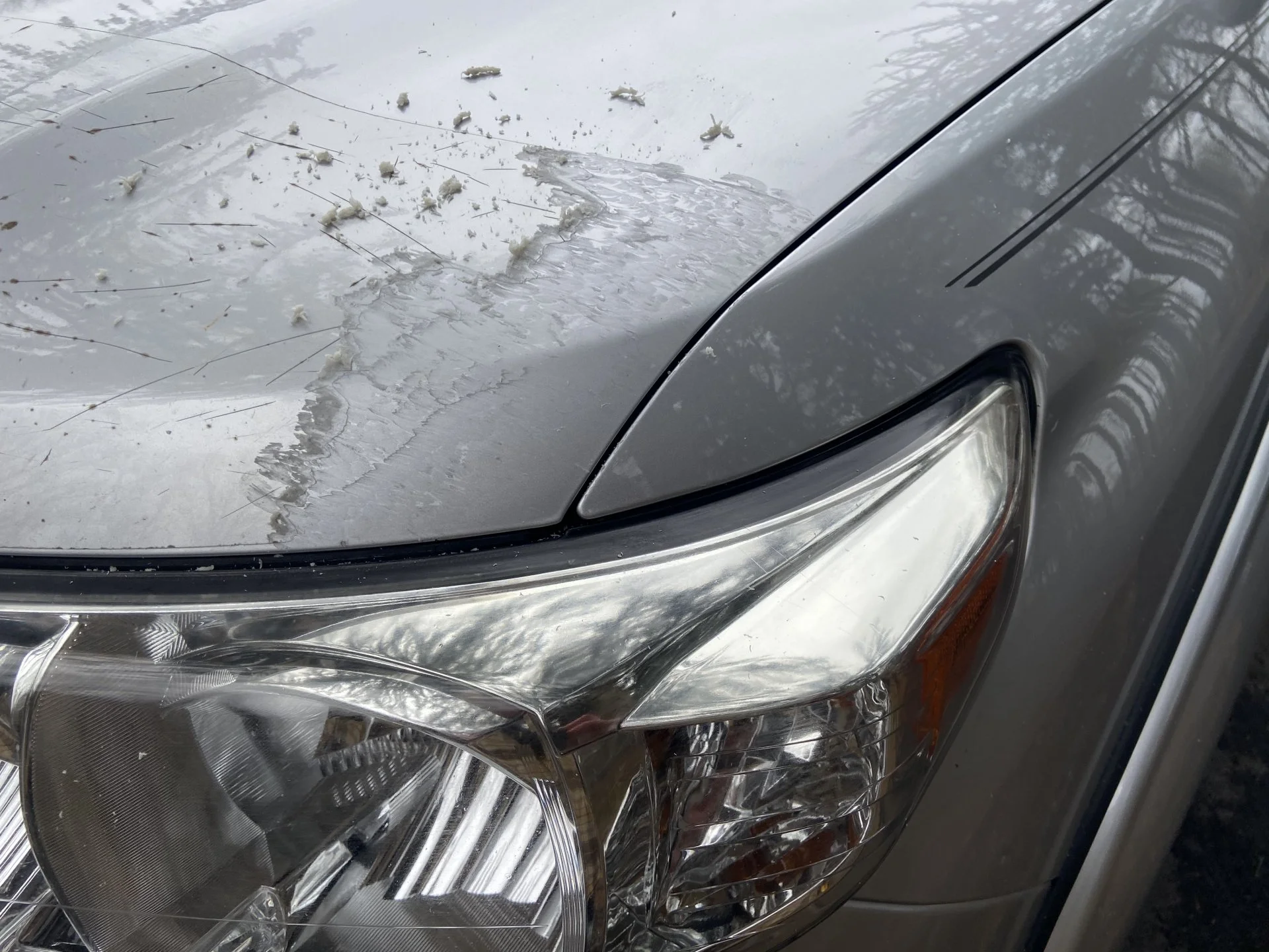

Just a thought - On YouTub I saw a detailer use towels which he poured hot water over (from his coffee pot so must around 180 degr F) and then placed it over the protective film. It apparently comes of easier once heated up significantly. Still that way seemed saver to me then a heat gun. Not sure though when it is cracked up as shown in the pictures that works for all areas.

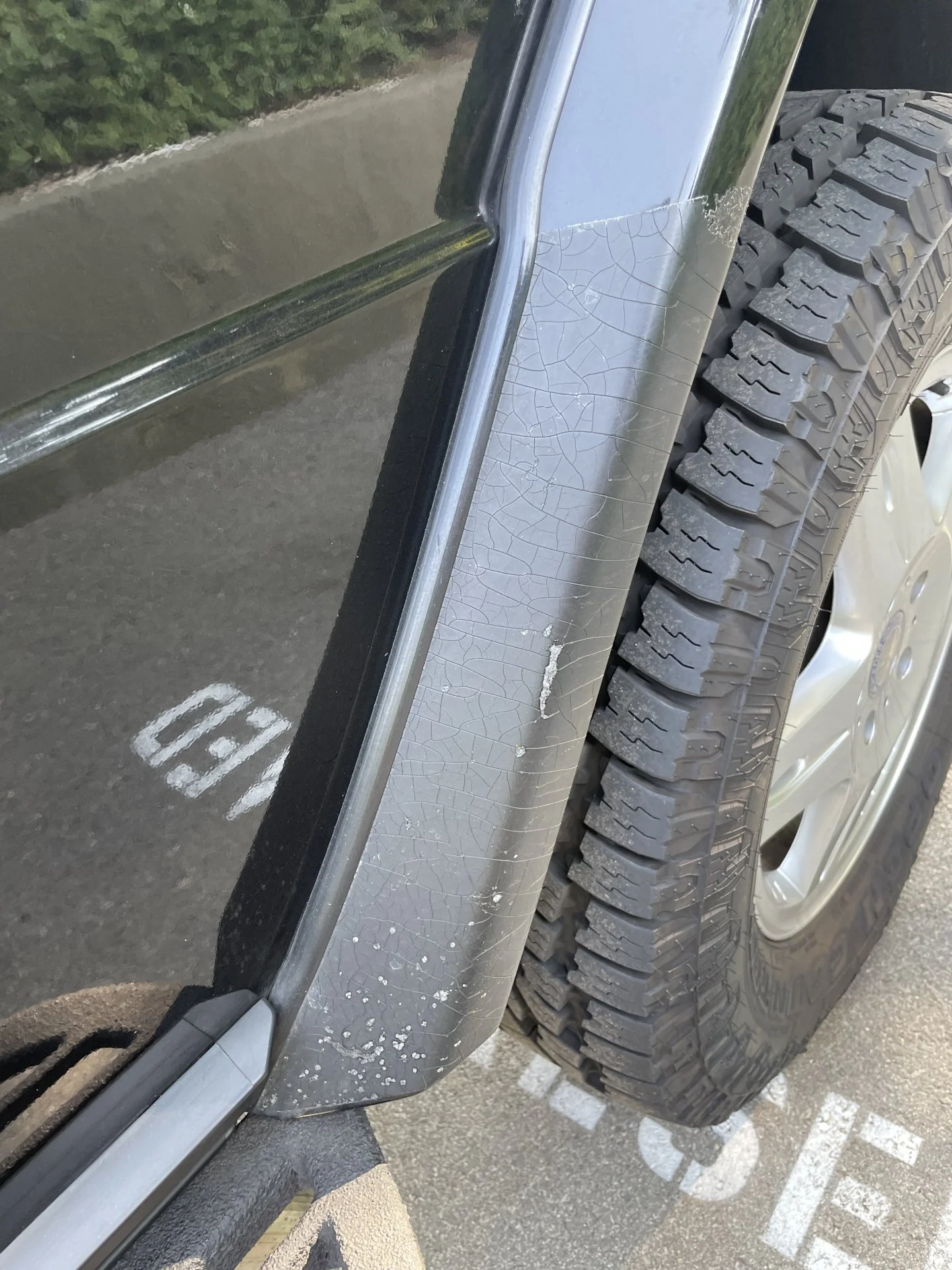

The less "checked" the clear bra, the easier it is to take off in larger pieces with heat.View attachment 2771176
This is a two day project by itself. But this is really bad.
That is what my entire front looked like. Cracked, incredibly brittle and tinted brown. We tried steam, boiled hot towels draped on, heat guns, driving the truck to heat the hood etc. I would have been there for weeks and missing all my fingernails by the end using any of those methods. I really think it depends on what shape the product is in. At the end of the day, using a chilled rubber decal wheel, outside, in the middle of winter did the trick. You have to be work from the edge inward and used a very slow speed on your drill. Allowing the wheel to do the work with little to no added pressure. Having two wheels to use and alternating between the two is best. Also having the wheel that is not being used resting in ice water helps immensly with confidence.
