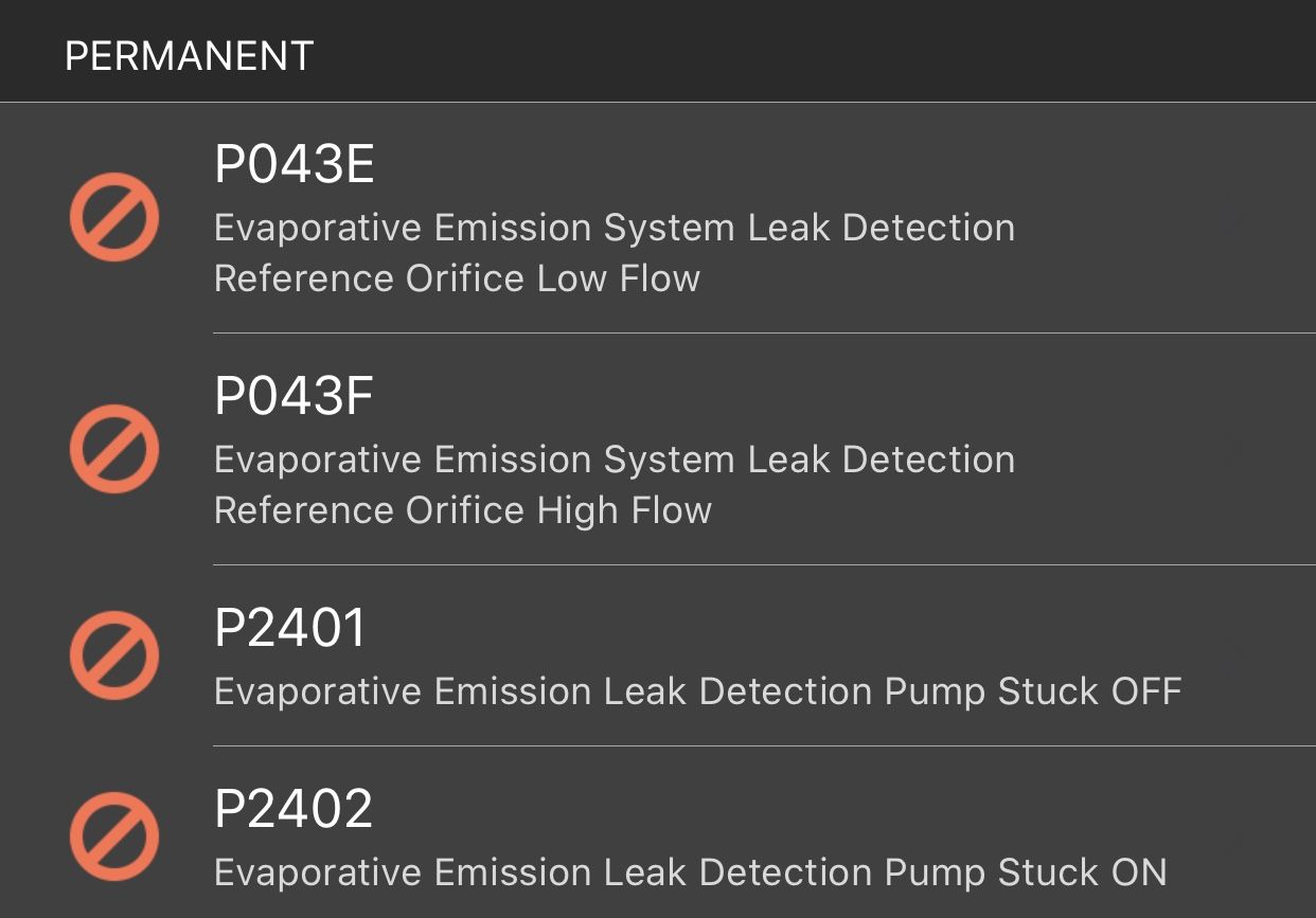

Were these the codes you had?
Those evap codes are so common that I leave a reader plugged in 24/7....but I added an extension plug that has a built-in on/off switch because it eats power 24/7 if left plugged in. So do most bluetooth plugs, btw.
So... if I get evap codes, i flip the on/off switch, and then within about 15 seconds, I can clear codes...even while driving if need be.
If all you want to do is clear codes, tons of OBD2 readers can do that.
I’m not a fan of bluetooth readers for quickie stuff, because it’s far too fiddly, and also means apps, updates, connectivity questions, etc. Also, those BT units stay powered up 24/7...since the OBD2 plug stays powered if a reader is plugged in...and some produce quite a lot of heat. I had one hager so hot i feared it would melt. That’s a lot of power to leave plugged in (maybe defective?) But anyway...went the other route.
On the other hand, for settings tweaks, I did recently to Carista. Limited options on my 08, but it did let me remedy several annoyances. Only use the Carista reader for specific tweaks though. TheRest of the time, my basic OBD2 is connected.
@Markuson i went with the carista and OBD Fusion. I was able to clear those 4 codes.
I wanted to be able to see trans temps etc, so maybe once I figure out this app I’ll be able to dig down in greater depth.
