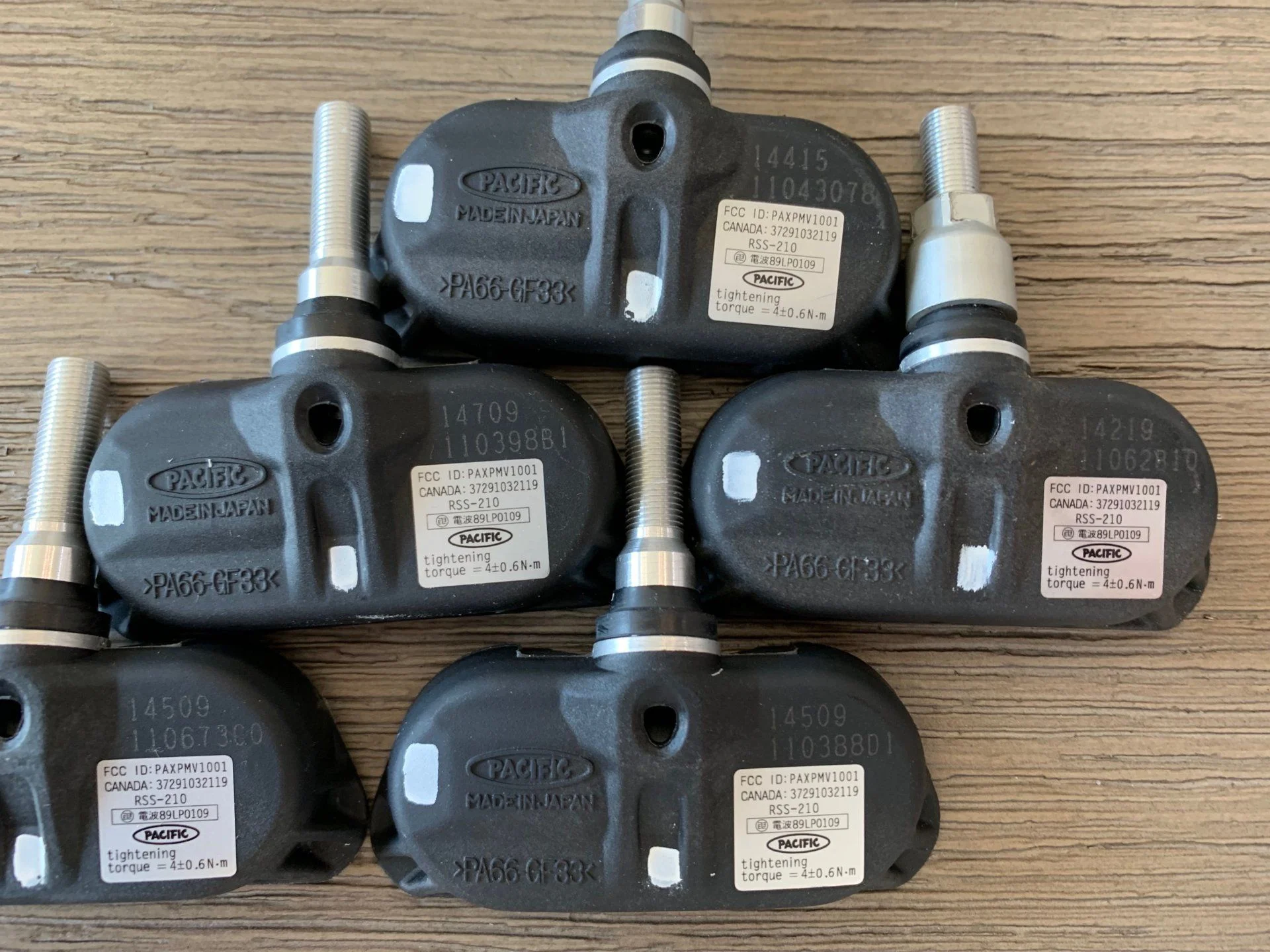

Does anyone know how the ID works on these?
The 2 numbers etched into the sensor... The top one is too short and the bottom one is too long.
Starting to wonder if I have the wrong sensors. But the Denso site seems to say I have the right ones...
Denso Part#: 550-0191 (To 07/2006)
Date on LX door/VIN sticker: 06/05
Thanks,
Skip
I have the same build month 06/05 and had the same problem last year, got the denso 550-0191 and couldn’t get it to sync. Ended up getting a factory unit on amazon 42607-33011 and it worked great. I also noticed that it had pmv-107j which is the same marking as the denso 550-0103. This year I got new tires and replaced the remaining four sensors with denso 550-0103 and was able to sync them before going to the tire shop with techstream. On some of them I did have to wake them up by blowing air through the valve like I was airing up a tire.
