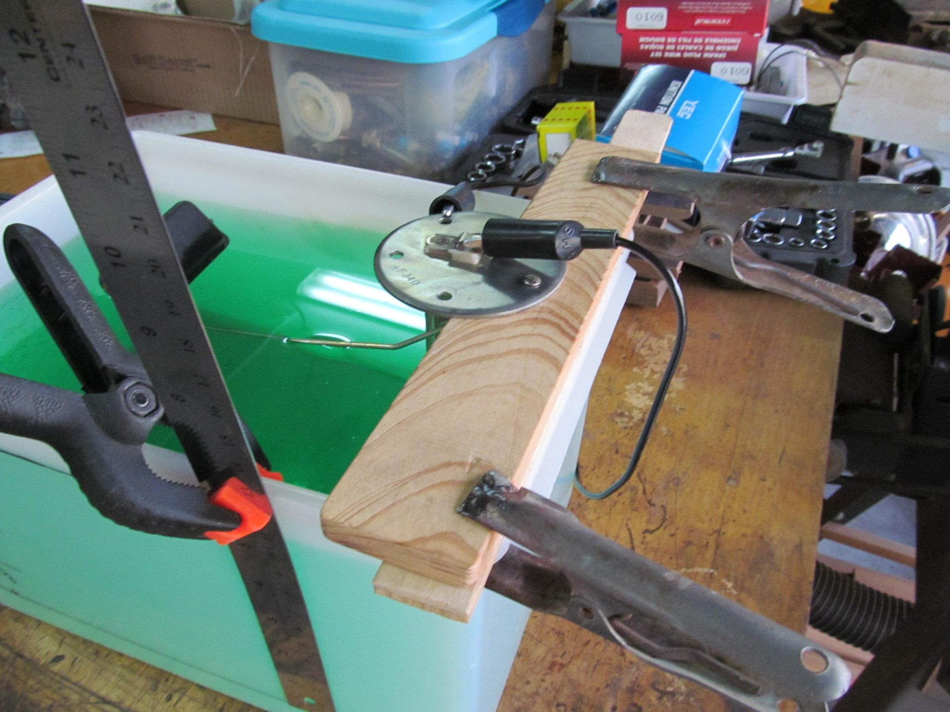

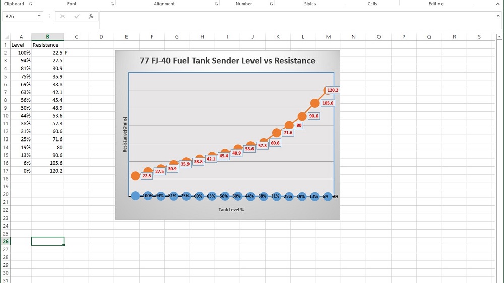

Did this a while back on my 77--OEM sender

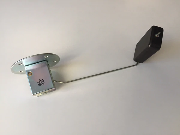

83320-35020? This sender works much like the oil pressure sender. It cannot be tested with an ohmmeter.
Engineer: Can you please explain "It cannot be tested with an ohmmeter." I thought
that is exactly how we are supposed to test resistance. Please educate this dummy.
Thank you.

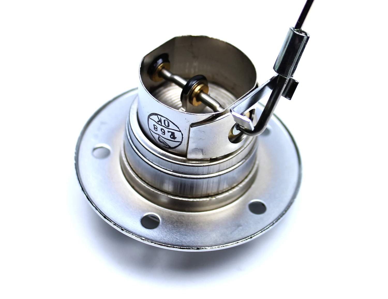

This sender works like the oil pressure sender. It has a bimetal points type regulator it it. The float moves the contacts closer together and farther apart as fuel level changes, causing the amount of current to the fuel gauge to vary. If you want to test, just hook up to the sender wire in the truck before installing and raise/lower the float while watching the gauge. The mounting provides the ground so you will also need a jumper from the sender mounting flange to ground on your truck. Here you can see the cam moves the diaphragm on the sender.
