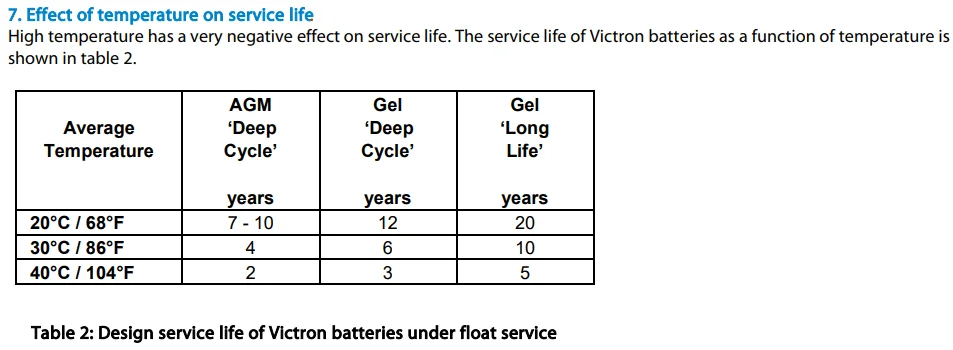

I think we agree engine bays are hot places. In overlanding use, it might be hotter still as there's little airflow and lots of hot idling increasing temps at the battery position. For kicks, let's say it's 150F (65 C). I wouldn't be surprised if it were much hotter still as the radiator is right there at engine temps close to 200F (93C).
AGMs in particular don't like hot environments. A similar Victron AGM batt has only an expected life of 2 years, at a barely warm 104F.

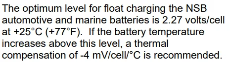

2) Thermal Charge Voltage Compensation
All batt's should have temperature compensated charge voltage profiles. NorthStar documents this as -4 mV/cell/*C for AGMs. From 25C.
Assuming 150F (65C).
65C - 25C = 40*C delta.
-4 mV * 6 cells * 40 C = -.96V. So almost a full 1V less at operating temps.
Float 13.5-13.8V @ 25C, or 12.5-12.8V @ 65C
Charge 14.4-14.8V @ 25C, or 13.4-13.8V @ 65C
Yet car alternators are setup for flooded batts, outputting closer to 13.2-14.8V.

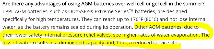

Accordibg to Oddysey (my 2nd battery is extreme series type 35), they do not suffer diminished moisture via pressure valves until they exceed 176 degrees F. My batteries are not getting that hot. Wet cells lose water more easily.
Odyssey also notes that vehicles that are driven often/or daily are able to maintain battery health much better than batteries only used occasionally as RV or boat batteries tend to be...and are less vulnerable to heat. In contrast, occasional use batteries are far more susceptible to heat due to water loss.
Oddysey’s Extreme Series AGMs (like my type 35) are “specifically designed for high heat” and designed for 10-12 years service life. While heat has an adverse effect on all batteries, Thin Olate Pure Lead (TPPL) AGMs are far less susceptible to heat damage.
So...in my case, and likely others here...perhaps it’s not quite so deadly as you suggest.
Read for yourself here:
FAQ: How to protect your battery against the summer heat
Heat matters, yes. No doubt. But it’s not always “murder.” ;)

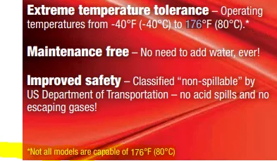

I've had Oddysey's before, and is where I cut my teeth on this issue.
1) Note that Oddyssey Extreme series is specifically designed for high heat over typical AGM models.
2) Not all Oddysey models are created equal, and only some specific models (with metal jacket) are capable of operation to 176F MAX, before they vent.
3) Even if they can handle the high heat, there is significant additional wear and tear when used in this application, causing useful service lives to be greatly impacted.
4) Voltage too high. AGMs do not like extraneous charge voltages.
